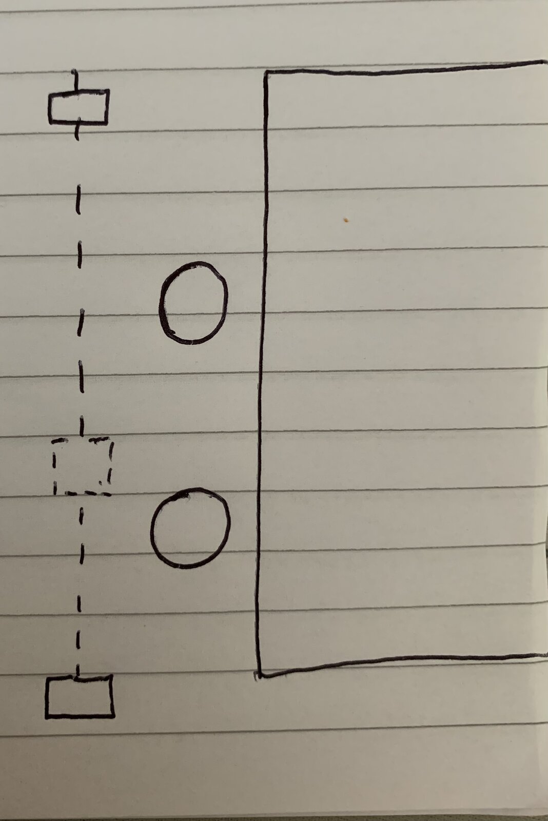

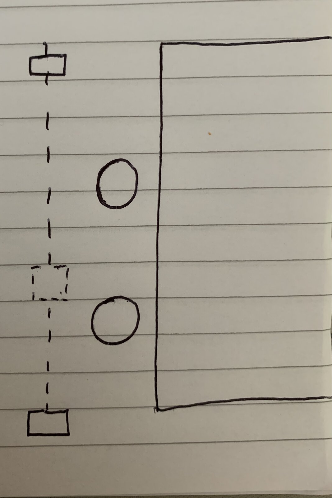

so could that be in the driveway to sit between the drain pipe and the house? See rough sketch, dashline is drain pipe with 2 manholes and small drive way drain, the 2 circles are sump possible locations as it is only that side of the house that is effected and only really the front half of that side if house (basically hall and under stair area).
The plan is to extend out the side but prob 4-5 years off doing that.
Whats the sump do just take the excess water into a well type container, where does that water pump to tho?
Or does the sump sit under the area of the house that is effected?
The water seems to come under the foundations and rises just under where the stair cupboard is and then spreads out

Would digging a trench along the side of house back filling with gravel and a land drain pipe be a solution? The issue would be where to empty that land drain pipe.
The water must be far enough down and spreads under the house where it finds a path to rise under the hallway

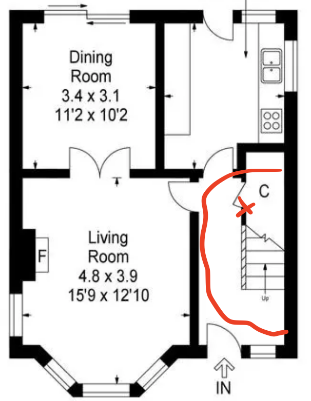

Water table is high in the area, but the fact it only comes under one section of the house means there must be a weak area? see attached red area is where it covers X is where I suspect it rises.
The issue is when the pipe was blocked and when there was a mass down pour. During normal conditions and days of rain its fine even with a high water table. Its when the pipe is full that the occurs.

A camera survey alone is not enough to establish whether the drains are leaking. Did they do a pressure test on the drain? If not it is a relatively simple job that should not cost much and well within the realms of DIY with reasonably cheap drain testing tools.
No a pressure test was not carried out but I think from the 2 examples that has performed it’s own 2 separate pressure tests firstly a blockage and secondly a mass surge of water into the system.
The water clearly comes in due to these situations, although the occurrence is rare and never been enough to caused damage it’s still managing to find a path into the house and rise in the same area.
I am not sure redoing a man made pressure test would tell me any different to what I know? However open to hear differently.
The issue is capacity and what’s best to increase or divert away from that side of house.
But the drain should not leak even if it is blocked or flooded. The worst that should happen is appliances and gullies etc. should start to back up and overflow.
It sounds to me that the old clay drains are past it, probably all the collars and joints are leaking. So it doesn't matter what else you do if you do not replace the drain run you will always get leakage into the ground which will find it's way into the house.

the thing I am struggling with is it comes up in the same area under the floor, strange to me that even if there is a crack and then under pressure it forces it’s way to the same bit.
the camera survey definitely never highlighted any major defects.

Question? does your main drainage line run near the area that tend to flood under the house?
As for depth of existing drains?? [obviously] from "0" at a gully to the depth at the nearest M/Hole, suggest you get an idea by lifting a M/Hole cover and measuring what you have.
As for the idea of a land drain? I would completely exhaust investigations of the existing drain first.
If you are installing a land drain, you need to [in effect] work back the level from the [proposed] land drain "outfall" which will probably be a manhole, the outfall can be at any reasonable level in the manhole [obviously] above the invert of the passing drain.The beauty of a field drain is that it only needs a very, very small drop in level to work.
