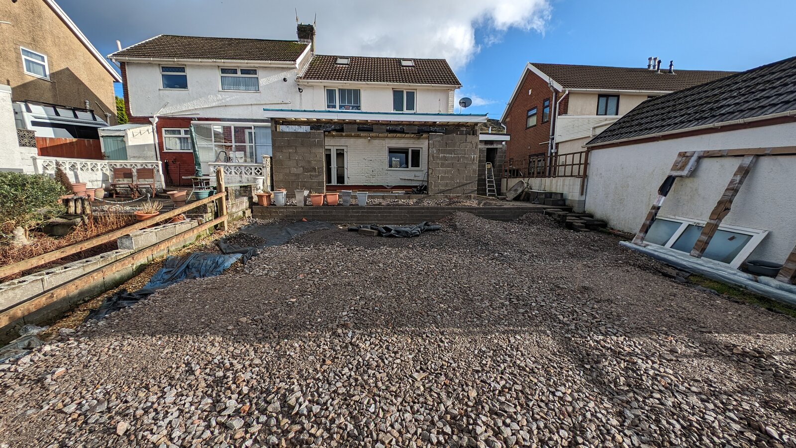

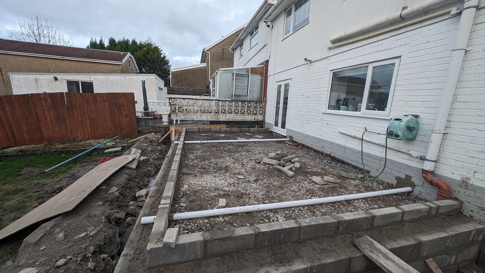

I'm currently having a rear single extension built, today I lifted up some floorboards at the rear of my property, to my surprise there is approx 2 inches of standing water in the void, the void is approx 76cm deep from the floorboard.
For some context:
My property is on suspended flooring, built approx 1950/60's.
Extension is concrete (floor was poured Nov 23) ventilation has been carried through the extension within the concrete slab.

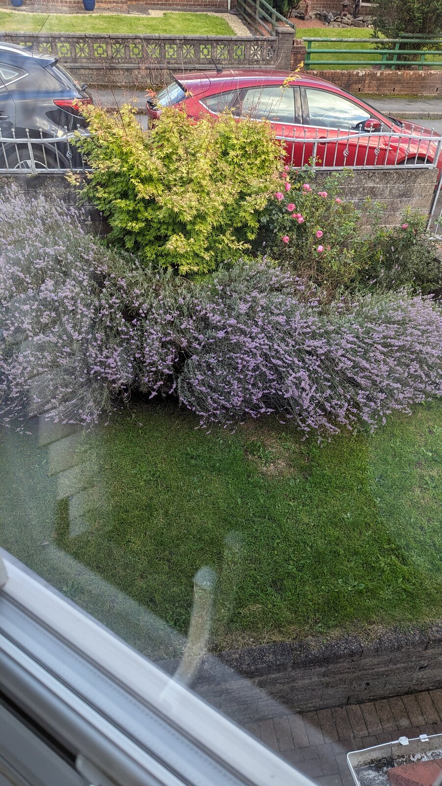

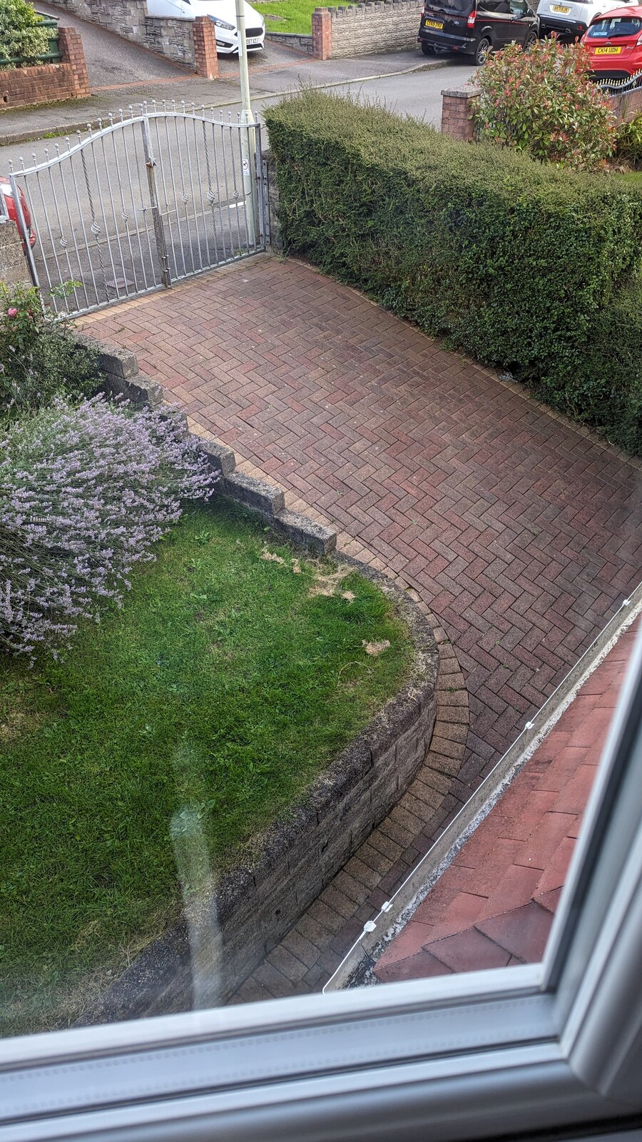

You have to walk down steps to get to my property (photo attached)

I've been racking my brain and I recalled there was decking with AstroTurf layed over it, attached to the rear of my house. It sat half way up over the air vents, is it possible water could have run off the decking/astro and into the void? Albeit it could've taken along time, but again I didn't know how long the water has been there.

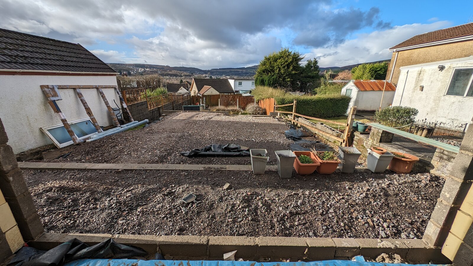

Issue is work has also started on my garden.
My rear garden is tiered so the only patch of grass I have left was would be lower than where the water sits? Would this be okay?
Should be OK, and if it's lower - a long hosepipe, should be able to syphon it out. No need for a pump.
