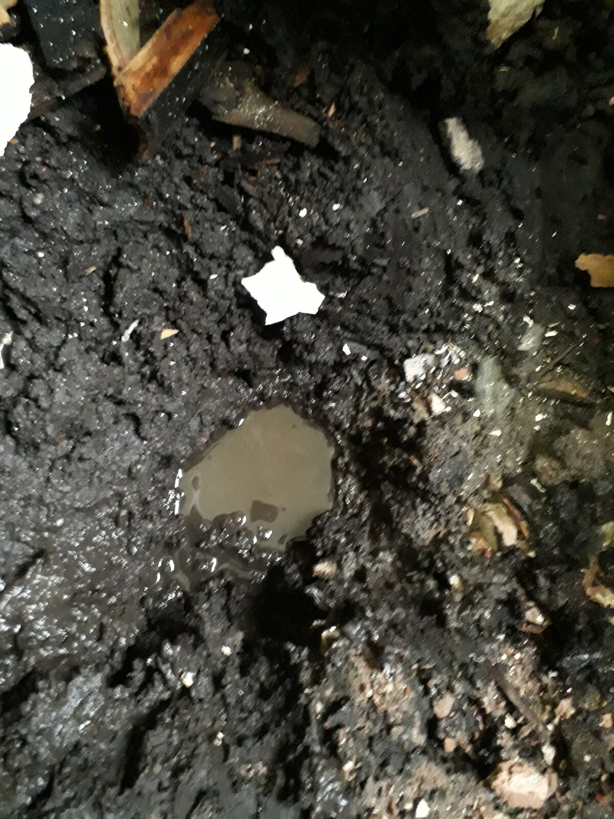

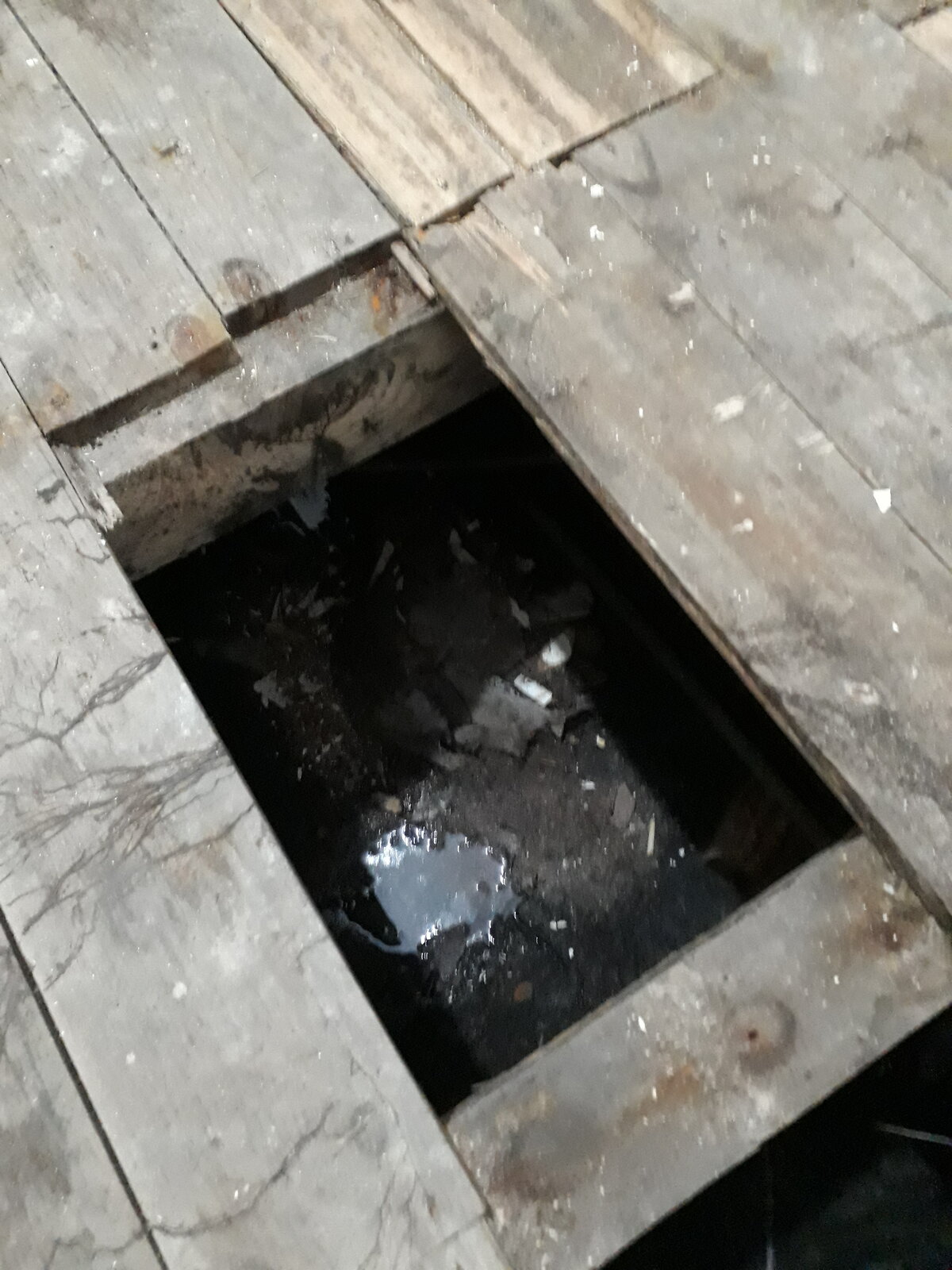

The floorboards in the front room constantly keep rotting as there is water under the subfloor void and the entire room smells of damp. If i dig a hole in the subfloor void (see pics with small hole about 2 feet deep i've dug from the subfloor - water start pooling up and you can see it settle on second pic) I notice water pools up after a while so I'm thinking the street has a high water table as other neighbours have a similar problem.

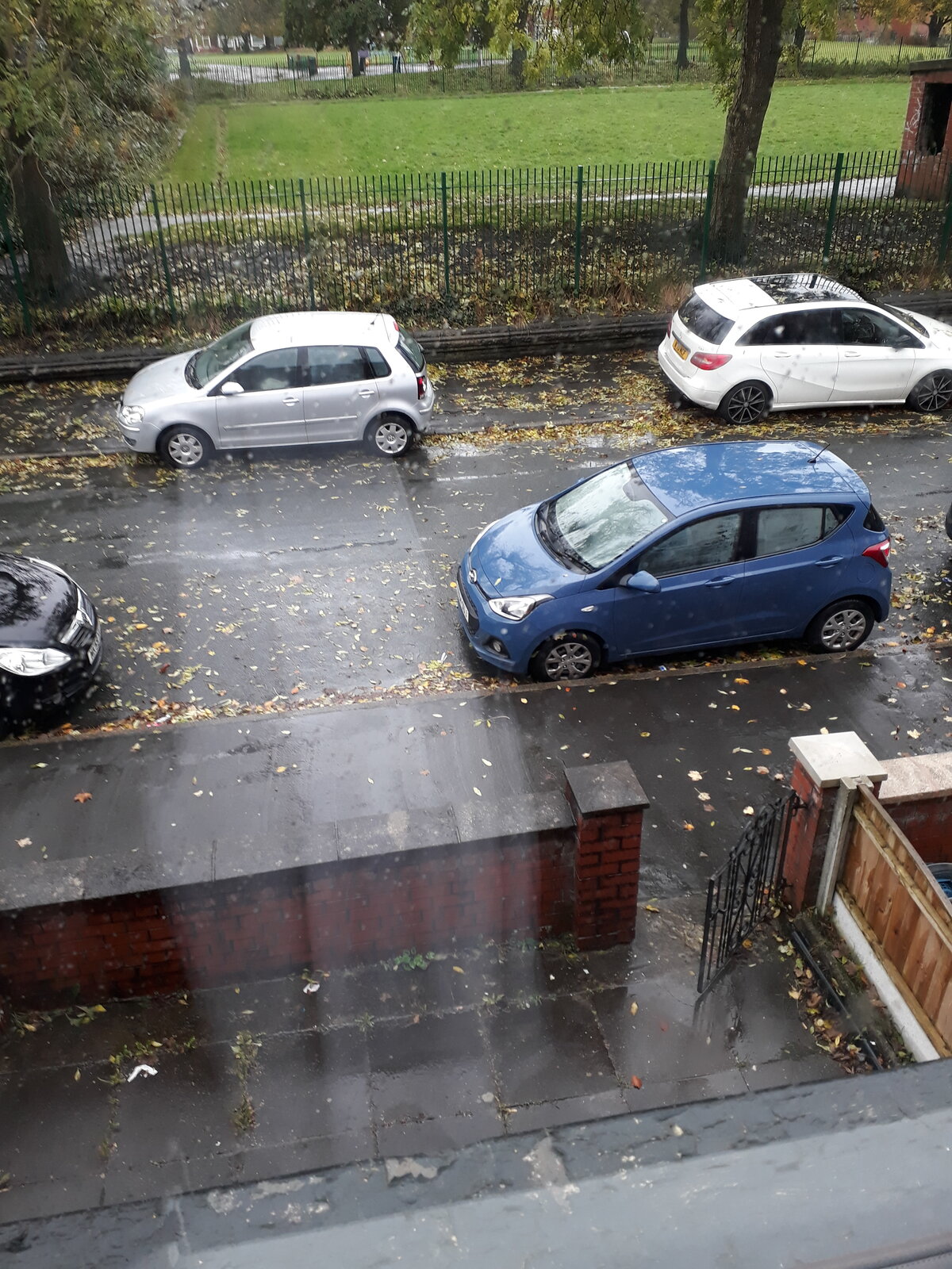

Across the road is a park and the ground level on that park is quite high (see pic)

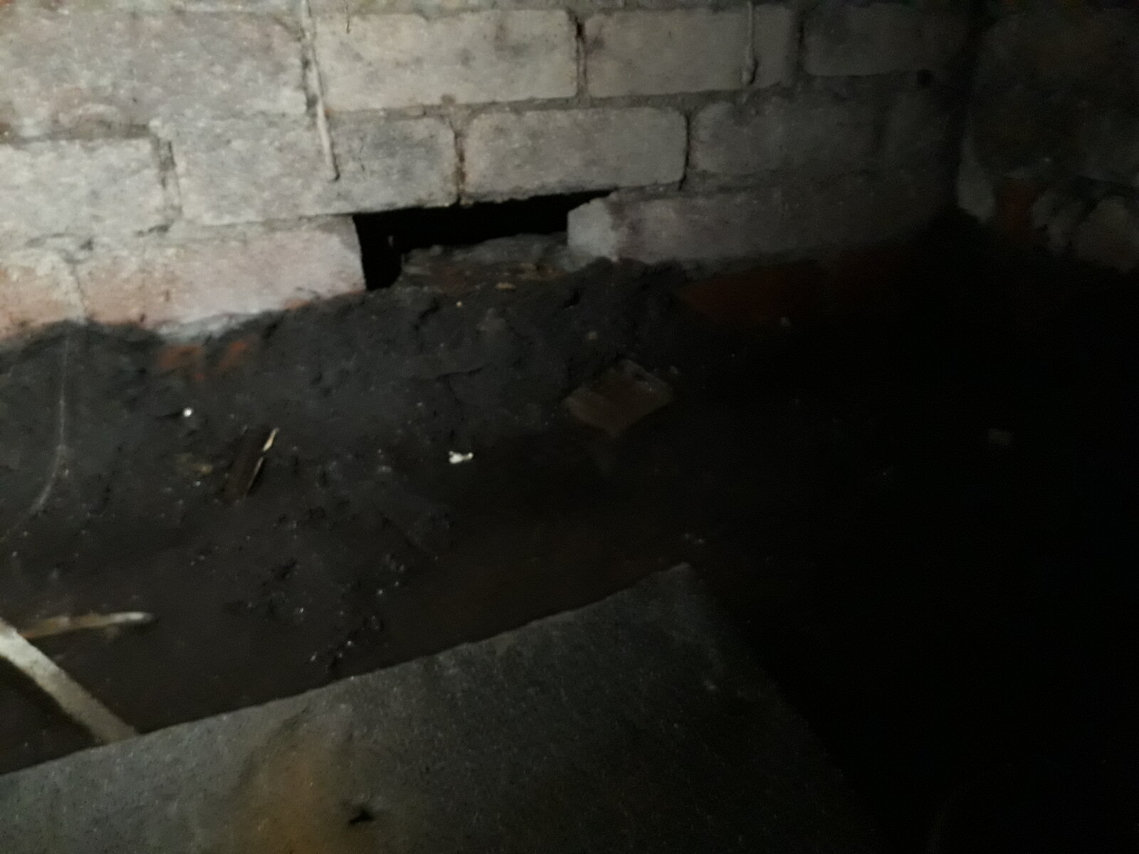

What I have discovered is that under the subfloor void on each party wall there appears to be what I think is a vent - hardly any air flowing but what I think is that these houses were originally designed for the air to flow from the front of the property and through the air vents on each neighbours party wall and back out the front as the rear rooms are all concrete (correct me if i'm wrong). It's weird because a walk down the street reveals that some properties have air vents on the sandstone and some don't unfortunately mine doesn't have any vents at the front so I'm relying on my neighbours front vents.
I prodded a long stick through both party wall vents and the stick passed through into one neighbours subfloor void but not the other. Speaking to the neighbour who's party wall vent appears blocked advises he's had his front room recently concreted which would explain why.

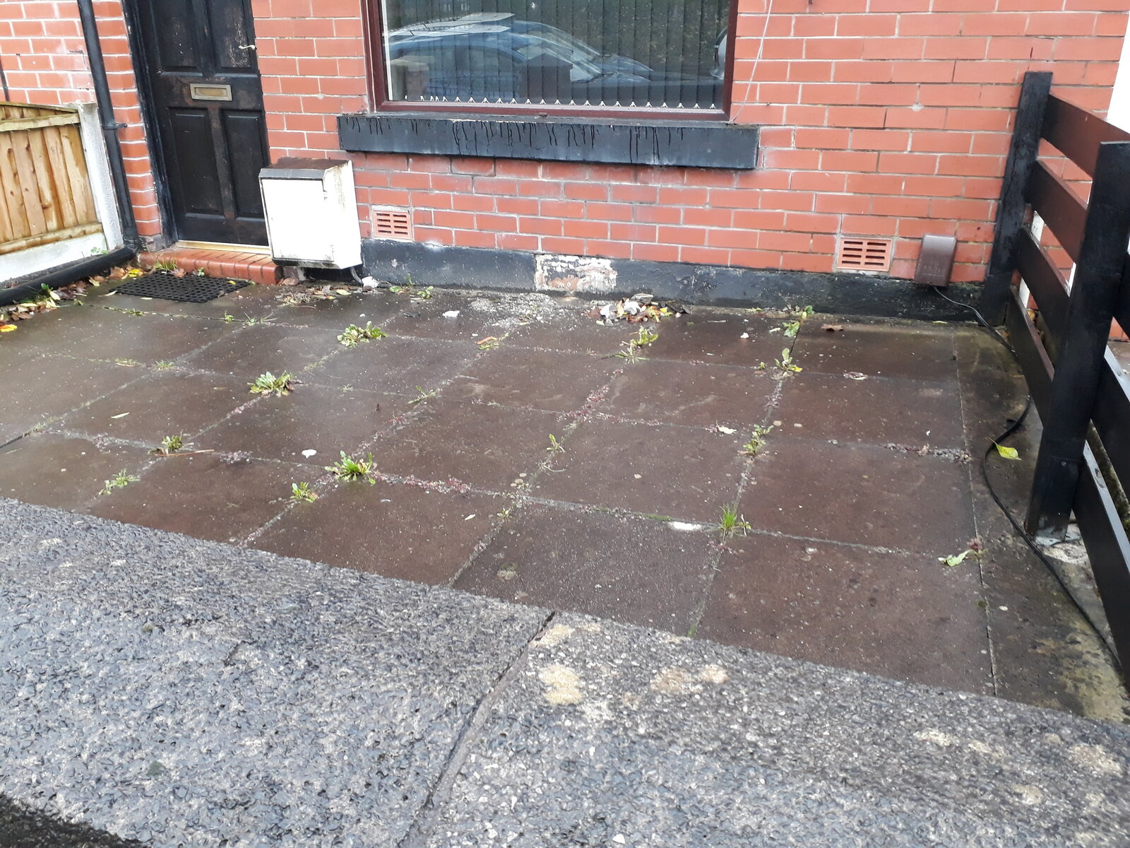

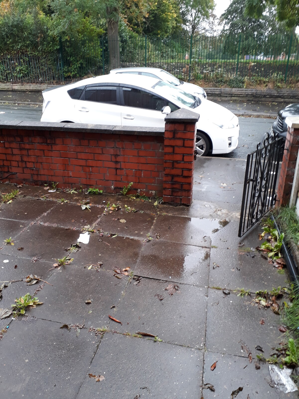

The external ground to the front outside is flagged and is higher than the internal timber floor but does slope away from the house. There appears to be two dpcs, one above the black sandstone which you can see from outside and the original bitumen type which sits around 5-8cm beneath the sandstone and currently hidden by the flagstones. Some rainwater gathers near the garden gate (see screen shot). The guttering has also been extended up to the garden gate to take rain water away from the house.

Could it be that because there is park on higher ground to the front all the water isn't draining properly and accumulates at the front of these properties because the rear is all concrete?

Its about 50-60cm from floorboards to ground level. The entire subfloor is sodden wet with pockets of areas where the floor dips up and down with pooling water.

Your front garden is getting waterlogged by water running downhill at the front garden. ive just posted a reply in the gardeners forum. i dont know if its possible to transfer the gardeners posts to here.

The garden to the front is flagged (see pic in original post). Even if I were to bring down the external ground below the internal subfloor void and open up the one air brick if it can be accessed the air is not going to flow anywhere as the back of the room which may have originaly had vents has been concreted up?

What I have discovered is that under the subfloor void on each party wall there appears to be what I think is a vent - hardly any air flowing but what it think is that these houses were designed for the air to flow from the front of the property and through the air vents on each neighbours party wall and back out. It weird because a walk down the street reveal that some properties have air vents on the sandstone and some don't unfortunately mine doesn't have any vents at the front.
I prodded a long stick through both party wall vents and the stick passed through into one neighbours subfloor void but not the other. Speaking to the neighbour who's party wall vent appears blocked advises he's had his front room concreted recently which would explain why.
