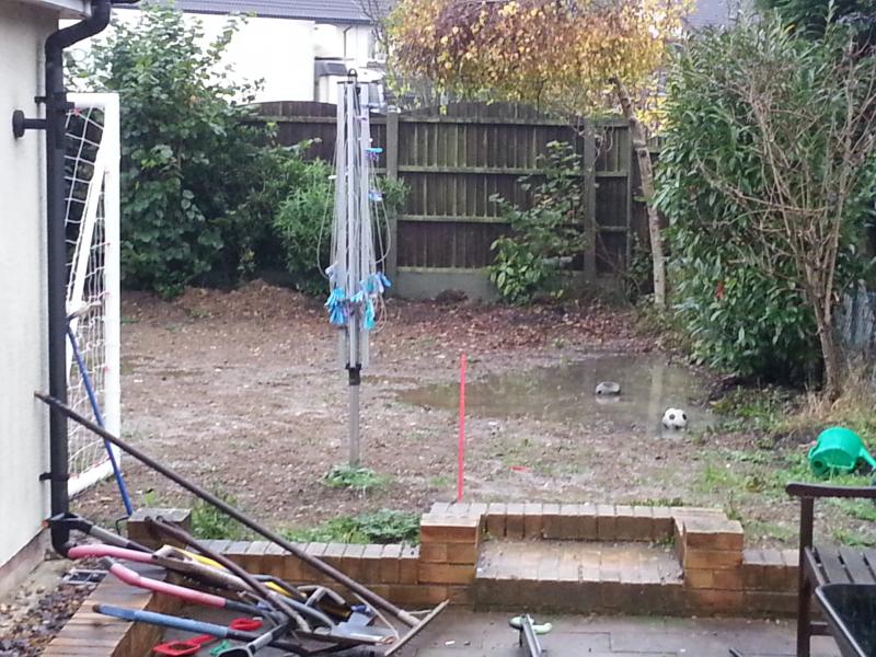

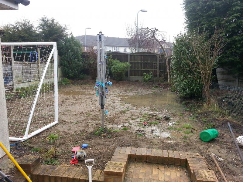

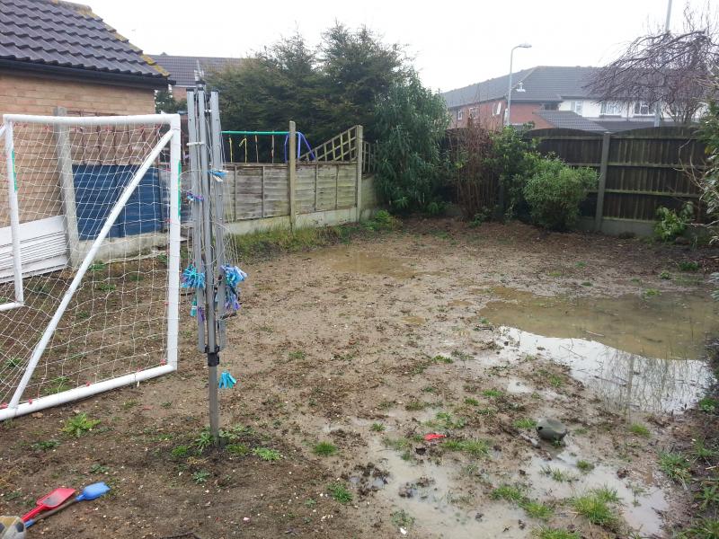

My garden is very clay like.
in the summer we had gapping cracks and in the winter/ after heavy rain it stays wet and boggy for a long time.
it was uneven and had a slight mount in the middle.
so to even it out in the summer/ autumn I removed the grass, top soil and about 2inches of subsoil (22 tonnes in total). I then rotovated it.
I was planning on putting 22tonnes of topsoil back and grassing it nice and level, so me and me boy can have a kick of football with out him getting his ankle caught in the gaps. Needless to say I ran out of time to get some topsoil delivered before winter.
this is what the garden looks like now, would topsoil and grass prevent the flooding?
My neighbours garden to the left is about 3inches higher and my neightbour to the right about 3inches lower. There is no run off for the lawn.
advice please for this summer project
If you put 2" of topsoil over the clay then when it rains you'll get 2" of waterlogged topsoil sitting on top of the clay which, without a lot of effort, you'll be able to turn into 2" of wet mud.
I can't advise on how to do it, but basically if you don't create a way to drain lots of water away your garden will often look like it does now.

Looking at the massive puddle in the image you linked id say its the perfect spot to poke a few holes and test the theory out.
Id create a puddle using a hose and see how long it takes to drain away.
Then poke a few deep holes in the area and use the hose to create another puddle and see if it drains faster.

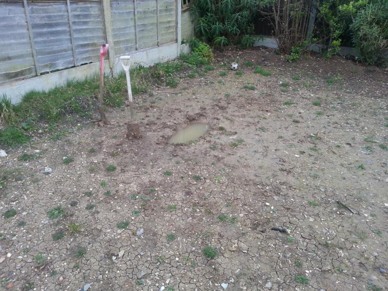

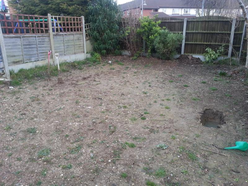

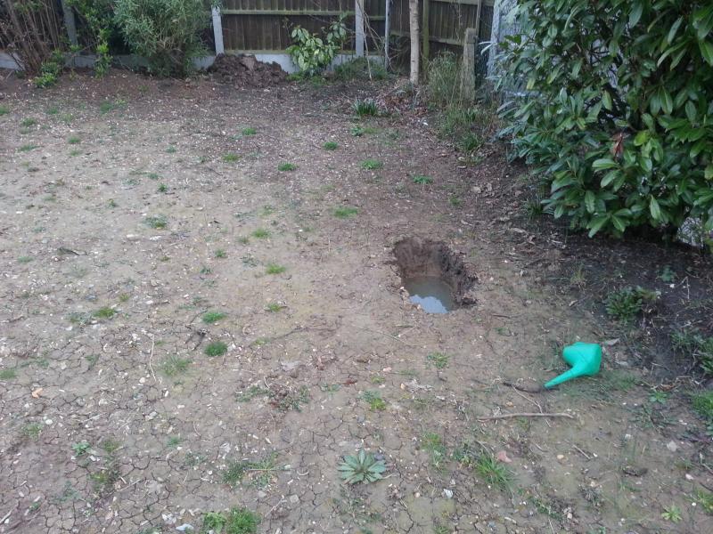

Ive been out in the garden and dug two small holes one about 2.5ft deep and the other about 2ft, they are bare holes with no filling
its been dry for the last two days but the holes are still full of water. My thinking is if I make the holes a lot bigger the waterlevel will be a lot lower.
opinions please

They need to be deeper not wider.
A trial hole needs to be at least 1.2m up to 1.8m deep.
Leave the excavated trial hole overnight, covering with a board or fencing-off to prevent accidents. 24 hours later, inspect the pit. If there is no water in the trial pit, then a soak-away is highly likely to work and work well.
If there is any water present, the level will have stabilized at water table level, and this should be measured from ground level to determine the how deep the water table is.
Its been left for two days like this with no rainfall.
im going to drain the water and go deeper as you said.
my only concern is it will not soakaway due to the denseness of the clay, but we shall see
