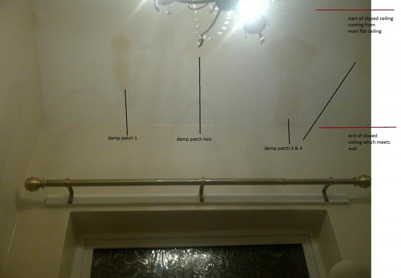

I have a damp problem on the sloped parts of my ceiling.
Can anybody provide advice on the cause and best way to solve?
The roof tiles are not backed with any felt or anything else so its just tiles in the loft so maybe water is getting through.
The roof does extend further down past the ceiling level, what the best way to solve is?
Will lining the inside of the roof with a waterproof membrane/underlay attached to the underside of the beams/struts which at the roof end runs outside to the guttering do the job, or will it cause lack of ventilation?
i have attached a photo of the damo marks on the sloped/angled part of the ceiling and have attempted to label!.
there are no damp signs on the flat part of the ceiling, however this may be solved with the loft insulation soaking it up.
any help greatly recieved!

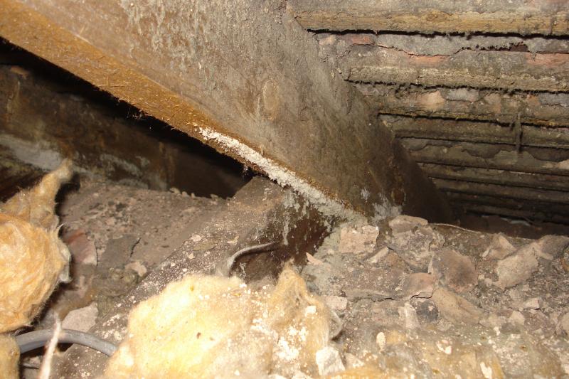

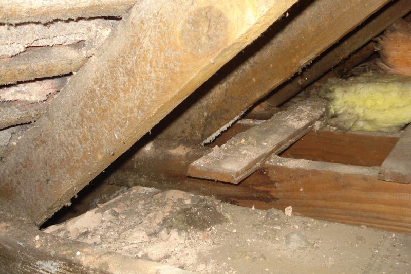

Thanks Burnerman - have checked for broken/missing tiles - were a couple broken but not directly above the area on my picture.
I have since found a white, light, fluffy mould on the bottom of the rafters in the corners/eavers - which is exactly where the plasterboard ceiling is attached to the rafters where the patches appear.
As there's no felt i think you may be correct about driving rain getting in as that part of the tiled roof is very close to this sloped ceiling, however recently it hasnt rained very much.
I wonder if this white mould is a sign of another problem - or if the mould itself is causing the patches??
I am going to vent the soffits to provide improved ventilation in the sloped eaves, and will coat rafters/corners with fungicide.

I think you're very much on the right track here - but if rain should bleach in then the dampness could occur well away from the slate issue as the water can run along joists, slaters laths etc and then drop at any convenient spot.....usually where a nail pokes through!
The white mould is likely to be some sort of efflorescence, but treating any visible timber is a good move anyway - as is providing plenty of ventilation.

I've had a roofer round fitting a few tile vents today. He told me his son had ta similar problem and that he seems to think its condensation forming on the ceiling directly where it attaches to the rafters.
I'm just baffled by why the damp stain patches of condensation are where the rafters are and not the rest of the ceiling. All I can think is that the rafters are damp and thus colder than the rest of the ceiling making the condensation worse??
The roofer said he slotted some kingspan insulation board down the eaves of his sons roof to make the ceiling surface a bit warmer - I'm jus a bit wary as this may reduce the ventilation and trap the dampness in??

I will try and post another photo (later today) of inside the loft to show the eaves etc which hsould help you see my position.
