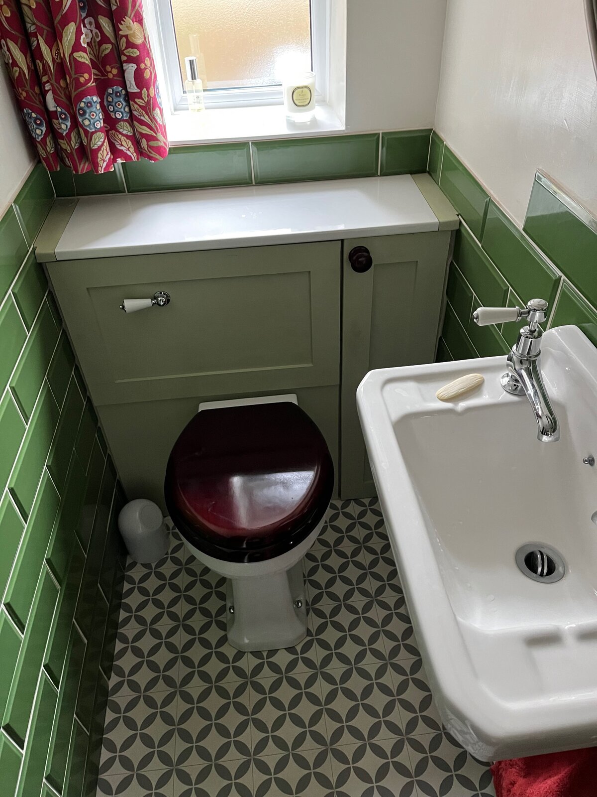

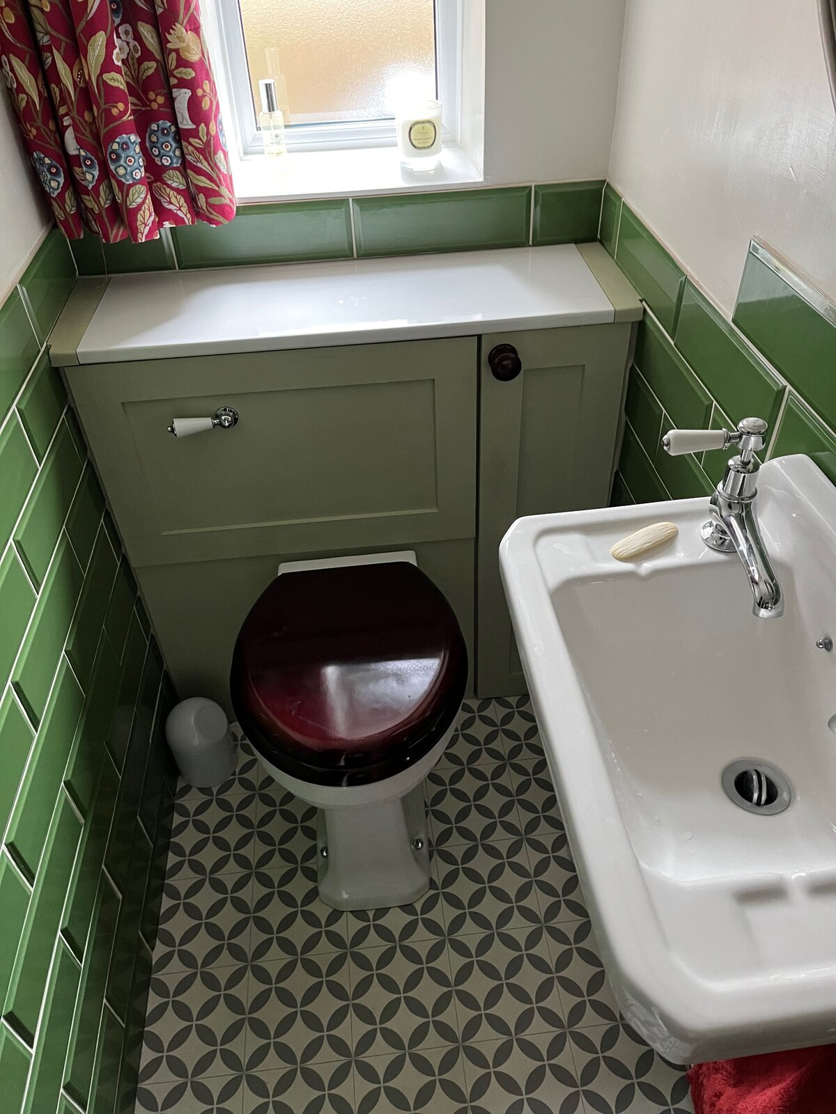

i used MR MDF and painted
made it a sort of shaker style - see image
on a kitchen where i had water (floor cleaning , and a couple of coffee pots which did not fill but went over the floor and behind the cabinets) caused issues with the 2 of the side panels which were chipboard expanded.
I replaced them and used a few coats of Zinsser BIN to seal in the MDF at the bottom and then painted - lasted quite a few years with no issues , before we moved house.
