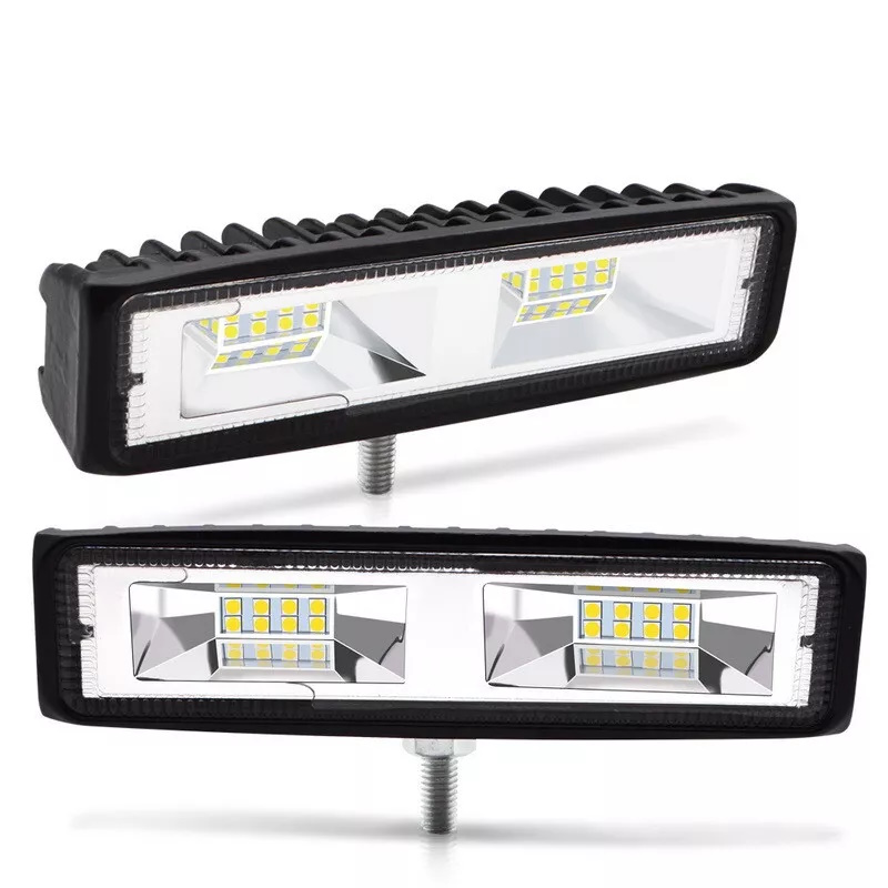

Hi, just picked up some reversing lights that were advertised like this, 12v x 48W LED Work Light Bar Flood Spot Lights. I am assuming 48/12 = 4 amps. Yet when i put it via the ma on my volt meter in series its reading 322ma ???. Any idea's what i am missing.

Says 16 x 3030SMD LED chips, and they are rated up to 1 watt each, so max should be 16 watt not 48 watt. In the days of tungsten, the max power for a reversing light was 36 watt, I would assume now in lumen, equivalent to 48 watt is around 4 watt mark so around the 340 mA, so does seem equivalent to tungsten watts, which is just as well as a 48 watt reversing lamp would be far too bright.
I seem to remember reversing lights have to have a BS EN number to be used, but left motor trade in the 80's, so not up to date, but LED lights are only permitted if original equipment so unlikely permitted. Seems now "The total wattage of any one reversing lamp shall not exceed 24 watts" "not bearing an approval mark." but it's been a long time since I worked on motor vehicles.
