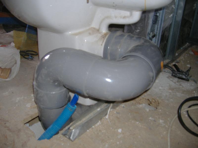

Hi
If I had the WC evacuated by the above, would it be a guaranteed disaster or maybe o.k. ?
It would be out of WC, (horizontal) then 2 x 90 elbows horizontal (so now coming back on itself ) and the third vertical. There would be no straight pipe between them just elbow directly to elbow.
Thanks in advance

Here's how it will look like.
Have used various m/f connections which don't match so appearance is approximate but close to reality.
Reality will have a small negative angle on all elbows from wc porcelain connector into floor.
@Richard C. I am not trying to comply with UK regs. I just hoped that, if they were based on expertise and experience they might tell me if this will/won't be a terrible idea e.g. " there shall not be more than 2 x 90 elbows within 1 m of wc bowl..."
If you - or anyone else -felt able to comment further on my questions re the "real issues" as well as the underfloor layout, I would be grateful.
There will be a UFH screed going on top, so underfloor problems would be extremely unwelcome.

wouldn't pass uk regs due to the lack of points for rodding. if there was a blockage in the section under the floor, how would you clear it? The fittings on the elbow section are all solvent welded so you would have to saw them off to get a rod in. Not very pleasant.
Is there a vent above the point where you have the 2.5m drop?
Try to make the 3rd bend an obtuse angle so there is some fall on the otherwise horizontal parts, and include an access on the elbow if possible.

Thanks for the comment. As someone who has never suffered a WC blockage, I must confess that the possibility has never been at the forefront of my mind until my poor planning forced the re-positioning of this wc and gave rise to this unfortunate set of meanders !
Presumably you would say that it would be a good idea to replace the final elbow with a tee and then put a screw-fit access trap on that ? Would that be enough in your view ?
That apart do you feel that the sinous path taken is likely to give problems ? I will probably be letting this place for several weeks per year and have no idea how differently wc's react to different stomachs !
Vent above the 2.5 m drop ? Well not in the sense of a vertical stench-pipe if that is the correct terminology. A 40 mm waste-pipe from sink on the floor above empties into this soil-pipe and so I have extended that horizontally at a small upward angle to exit through a side wall.
I live in the Alps so "best-practice " is to make as few holes in roof as possible :D
