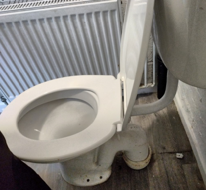

Hi, looking to do two projects:
PROJECT (A): Want to bring garage WC to below the stairs pantry
PROJECT (B): Then maybe turn the garage WC area into a shower room
Pic of the PROJECT (A) basic move:
Pic of the garage WC:
Pic of the pantry area:
Garage WC and Pantry on either side of the same wall with the Garage WC being a step down:
Further pics and details here:
https://photos.app.goo.gl/GtCgH2a9YbByReJy8
First step is PROJECT (A) and its a nightmare tyring to find one person/company to do this at this time.
So working out what I can do myself and the plumbing is the main issue so hence posting here. Can post elsewhere if needed:
I think the steps to do PROJECT (A) is:
1 Get the plumbing in for the new WC by extending waste through the wall
2 Plumb in the feeds for the WC and small sink
3 Fix a stud wall for the cistern and pan to sit against
4 Do the pantry floor
5 Plumb and bolt in the WC
6 Plumb and fix in the sink
7 Fix an ventilation fan
8 Make a door into the hallway
9 Stud wall where the current door is
These steps make sense?
Anything I am missing or anything else worth considering?
Welcome feedback, will have questions. Ta!

Do you think it will be a hassle extending that old waste into the pantry? I think its a 110mm pipe extender - the plumber scared the heck out of me by saying that pulling out the old Garage WC from the clay floor collar, could present all kinds of issues - e.g. if the clay waste pipe breaks they would have to dig up the garage floor and replace that part of the pipe? :oops:
... is that possible and does it happen often? Or does the old WC generally come out easily and new extension waste piping just plug in?
A shower that will sit over that waste plumbing in the future, so would want to avoid smells and leaks.
Appreciate any thoughts.
Oh, what am I getting myself into here...
From what I am reading, I guess the WC pan is cemented into the house clay soil pipe and can get thus broken when being removed?
There will a wooded raised floor put in about 2 bricks up to make the garage floor level with the rest of the house...
So, I think the new waste pipe connection to the clay collar will be mostly under the raised wooden floor...
The u bend bit will stick out above it and then go into the pantry WC, I think this is 110mm diameter.
The plan is to put a plinth for a shower tray there and that should cover the u bend bit in the garage room which is about 110mm high. I assume this will also be needed for the shower plumbing to feed into that waste and maybe a sink waste if its fitted in the garage shower room. Not sure how that plumbing will go together.
So if the connection to the house waste pipe will be under the raised wooden floor (if you get what I am saying) - would I still need to dig things up? - or can I just get the waste extension fitted to the collar sticking out of the current floor?
Biggest risk will be removing the existing Pan without doing too much damage to the soil pipe, if you're lucky, it may break the collar off the clay pipe with the pan, leaving rest intact. Alternatively, you'll have to break the outlet of the pan away, piece by piece, (wear stout gloves, broken porcelain is razor sharp!), and once the pan is off its base, use a Dremel or suitable cutting tool to carefully cut around/through the pipe, under the collar/above the floor to remove the rest.
Then, if the pipe looks ok, (no sign of damage or cracking), use a suitable connector, to take you from the clay to 110mm plastic, go through the wall at a suitable height to meet outlet of new pan. McAlpine offer a version which also has a 40mm boss connection for your proposed shower and basin. https://mcalpineplumbing.com/plastic-chrome-fittings/drain-connectors/drain-connector-with-boss/ (Screwfix stock it , other suppliers are available. )
Digging the floor up is a last resort!

Thanks for this - yes that is the risk I am worried about. Job can turn into nightmare with the Garage WC not usable, no way to connect to a new WC waiting in the pantry - and may be stuck with a workman or plumber that isn't up to the job with no contingency plan. Thus welcome input on the below plan:
PLAN of ACTION
-Use a diamond blade rotary cutting tool to cut around WC (angle grinder maybe)
-Take out the WC
-Put a bag down soil to avoid fragment downs pipe
-Gently hammer inwards the remaining WC fragments if possible without breaking collar
-Possibly fashion tool with rotary diamond blade to remove fragments (read about one somewhere?)
-Put in 4"-to-110mm U-bend connector to go from garage floor through pantry wall (with waste connector for garage sink)
If Clay Soil Pipe Collar breaks:
-Suggested that ARC MS-11 Rapid Seal curing sealant could be useful?
-Mentioned something about a multi-quick collar?
-Can I make the collar flush with the floor or use a deep reach connector if things break?
-Anything else can do if collar breaks?
If Clay Soil Pipe breaks:
-Dig down and replace that section?
...sound like a plan? Missing anything obvs?

If you can get a clean break between the existing pan and drain, then that's the hardest part done I would think. You'll need a selection of fittings to get to where you want to be, but provided drain is ok, (no cracks or other damage), then use the McAlpine DC1-BL-BO (top link in your post), as it'll give you more flexibility on fall with your waste(s). Take off from that with 110mm to meet the new pan outlet position.
