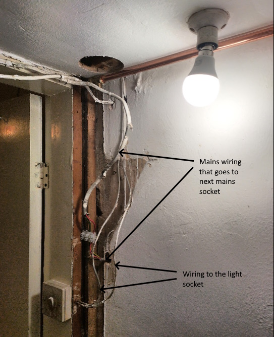

Hi, doing a convert of a under the stairs pantry into a WC (nightmare). Getting there with the plumbing issues but had an electrical questions.
-Had an AC mains socket in there (replaced with a connector block for now to keep the loop)
-Have a working light switch
-Have a light socket which switches light on or off
Some more of the details are here to see (link)
It looks likes there is some old wiring which I cannot replace at this time.
I need to wire in a ventilation fan which preferrable comes on with light switch. Seen this which has confused the hell out of me.
What are the options?
1. Change the light socket and wire in an electrical fan (there does not seem to be a neutral wire in the light socket?)
2. Alternatively wire in an electrical fan using the AC mains wiring with wago blocks and then fit a switch to turn it on and off (or maybe I can find a push button thing which would start it on and then the timer on the fan would switch it off?)
3 Anything else which would be easy and not involve buying some expensive PIR fan or anything?
Welcome any feedback as need to go in the right direction to get it done in the next 24 hrs (gulp)...

You have arrows pointing to cables for lighting. They are probably going to be feed in and feed out from the switch.
If this is the case, you will have live, switched live and neutral which is what you need for a timer fan. You can take these to the fan via a triple pole isolator at ceiling level to make isolating the fan easy for cleaning.
Re the socket cabling, you don't have to get rid of it. It isn't a bathroom. You may want a shaver socket, or, depending on how big the space is, a charging point for a cordless vacuum or a supply for a burglar alarm etc....
Is that hole in the ceiling for ducting for the fan?

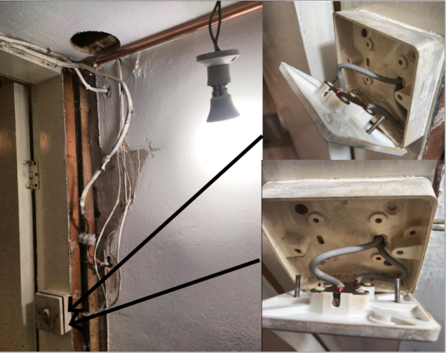

Yes, the cables in the switch are singles. The neutral will be at the lampholder.
You might have an older junction box system of wiring where only two wires appear at each location.
But you MAY not have any earth wires in the lighting either. In this case, with a bayonet lampholder and a plastic surface mounted switch and a fan, it's not a dangerous situation, but in the rest of the circuit, it may be.

Thanks. Hole in the ceiling is us drilling out a hole to see if poss to put the 15mm pipes up there. Patched it up now
Only two wires into the switch and only two into the light bulb socket (so not sure where the neutral is coming from). One of the wires disappears down a black hole and then comes back up and around to the light bulb socket I assume that is some loop thing?
If the light wiring is olde' world - am I best staying away from it? If there is an easy fix then I could be up for making the fan activate from the light which is always ideal.
