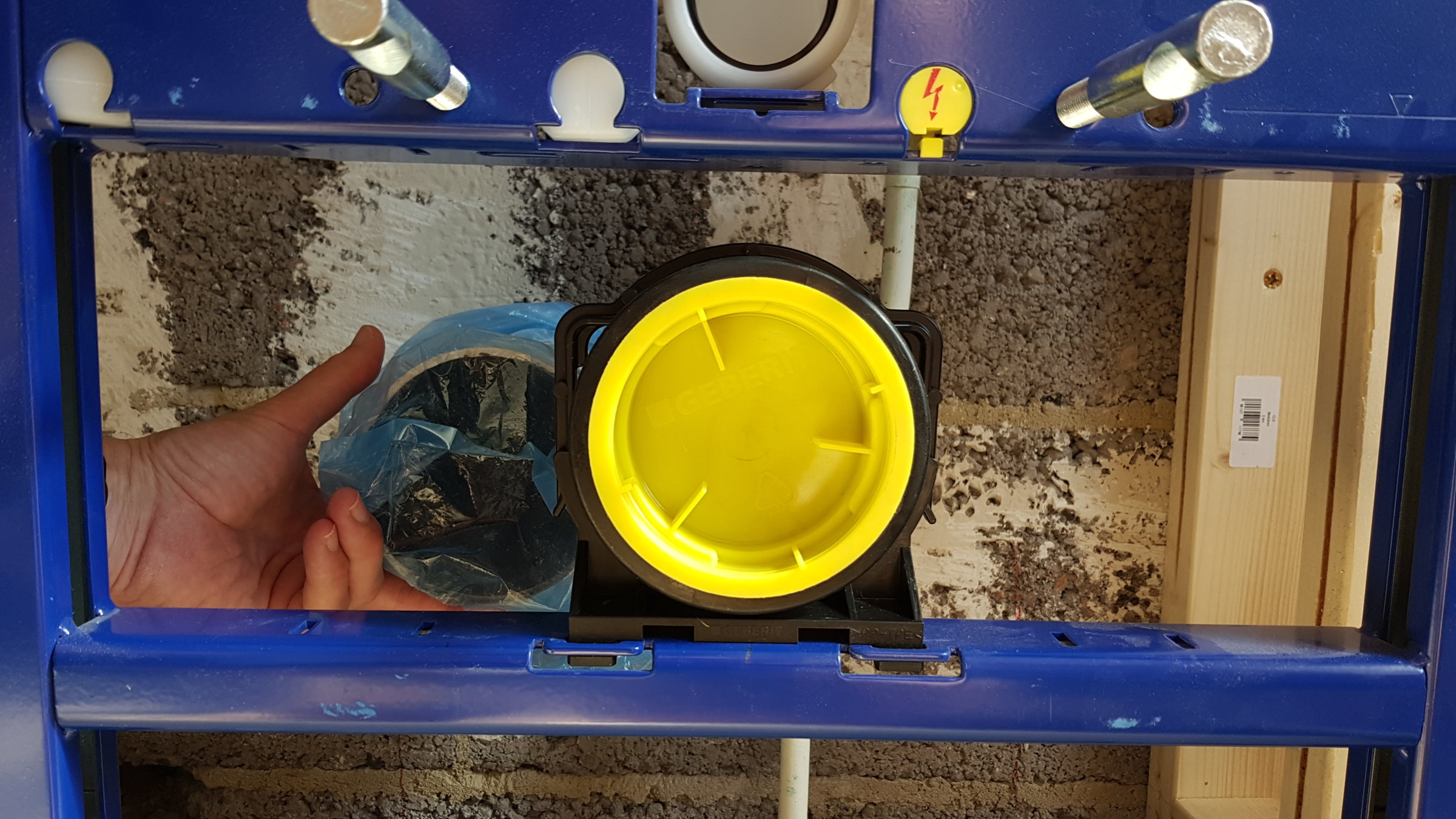

Hi guys, I wonder if I could trouble you for some help plumbing in my new floating WC.
I have a Geberit frame, which will be boxed in and I've set this to the required height to ensure the top of the pan (minus the seat) will be at 42cm above the tiled surface.
Because we are fitting a new and rather large floating basin unit next to the WC I've had to move the toilet to the right of where the old toilet used to be. This means the 110mm soil pipe is now around 120mm to the left and slightly lower than where I need it to be.

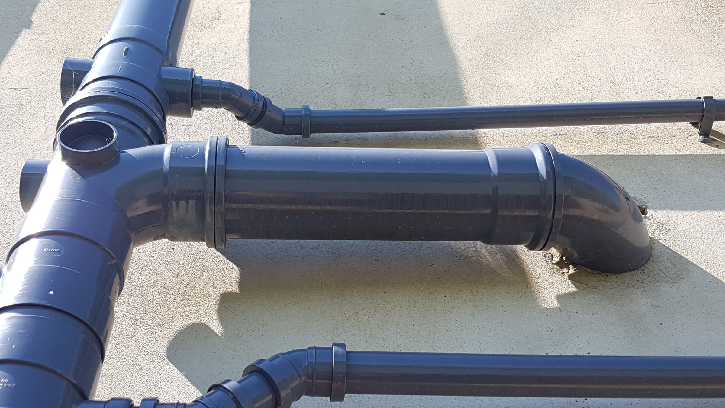

I've been looking at the Wavin Osma product and installation manual and think I may have found something that will help me.
Looking at the various connections in my last photo, it would appear that the branch has two push fit fittings and a solvent weld end. One of the push fit ends is what the push fit length of pipe on the right connects to and this itself appears to be connected to a push fit elbow, where the push fit end of the elbow is hidden in the wall. The other end of this elbow will have a piece of straight pipe that pokes out into the bathoom.

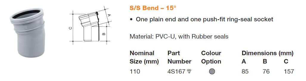

So, If I were to insert the following into the push fit branch:
This would angle up slightly (15 degrees). I could then connect a short length of push fit straight with the same elbow and this combination should allow me to run the soil pipe through a hole in the wall that is left of and slightly higher than the existing hole.
The only issue may be that the 15 degree connector may angle the straight pipe to much!
Does anyone know if the Osmo straight pipes can be solvent welded as well as push fitted? They are described as PVC-U so I think this means they can? I ask as the bit of straight pipe that feeds out to the pan will have a 110mm to 90mm adaptor solvent welded to it. I have already purchased this adaptor as I realised it would be required due to Geberit supplying 90mm fittings (European size) but not bothering to also provide an adaptor!
Yes, all PVC-U pipework can be solvent welded, the installation you have there has a mix of both solvent welded and ring seal (push fit) joints. Seems a shame they've gone to the trouble of using quality fittings for the soil and then run the wastes in cheap push fit, but I wasn't responsible so that's just my opinion! (Solvent waste looks neater and more professional in my view.)
The junction is solvent welded, along with the boss pipe below it, any attempt to alter that lot opens up a whole world of pain, along with a hell of a lot of work... Also, I'd be very wary of pulling that existing branch pipe out from it, as I suspect you will disturb the seal, and any subsequent attempt to get it to re seal will fail.
What I would do is, work out where your new soil pipe exit will be for the new pan position. Then offer that 15° bend up alongside the existing branch pipe, and see what it gives you. I have a suspicion, putting the socket end of that slow bend downstream, with the spigot going into the 92.5 bend through the wall, you may find it'll line up with the existing horizontal run at some point, at that point cut the existing horizontal section back to suit.
Alternatively, if the 15° bend is too much, look at an adjustable bend. They are not pretty, but may give you either the angle required, or will 'dogleg' to give you the slight height raise you need to get from the existing branch run to the required height for the new pan outlet. https://www.screwfix.com/p/floplast-sp560-0-90-adjustable-bend-black-110mm/77224

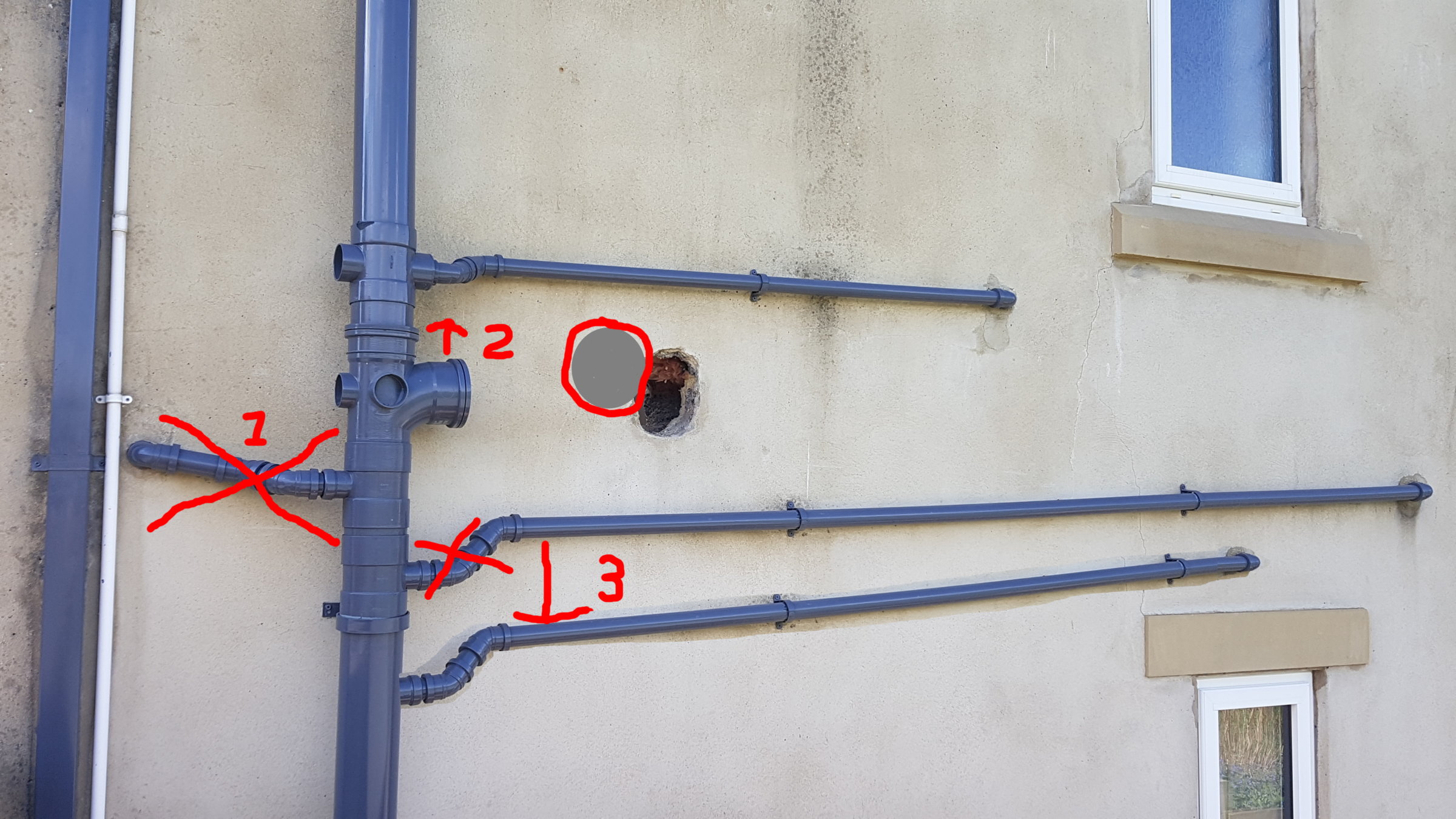

2. I have realised I need to do quite a bit of additional work around the soil stack as shown in the following diagram, which raises yet more questions about the best way forward.
In the photo the red numbers reflect the following:
1. This is the old bath waste pipe, which is currently above the floorboards in the bathroom and so is too high to use for the freestanding bath. This will therefore be removed, so I assume there is something I can use to seal the boss socket on the ring-seal bossed pipe?
2. The options for the toilet soil pipe have been discussed above, however I'm now thinking of a different plan (see below)!
3. This shows the current shower waste pipe (top pipe) and the required new waste pipe (bottom pipe - copied and pasted). Again because the old shower was on a raised platform, the waste ran above the floorboards and is therefore too high to be used by the new shower tray. I was hoping I could use the same ring-seal bossed pipe connection for the re-positioned waste, unfortunately as I will need to drill a 40mm+ hole through the centre of the joist this will actually be around 21cm lower than the old waste pipe, meaning the existing boss pipe connection will be too high. I will therefore need to also seal this boss socket! In addition, I was thinking of using a boss strap to connect the new shower waste lower down the soil pipe.
So, given I now have a situation where I don't want to use the two existing ring-seal bossed pipes and as you've mentioned, the seal on the branch may be compromised, being 22 years old, I'm thinking I should consider the following:
1. Cut the soil stack just above the branch push fit.
2. Cut the soil stack below the bottom ring-seal bossed pipe. I have now removed the toilet soil pipe connection and old bath and shower waste pipe connections.
3. Fit a new single branch for the toilet soil pipe and a new ring-seal bossed pipe for the new shower waste, positioned at the appropriate heights. For the toilet soil pipe, the branch would be fitted slightly higher than it currently is to avoid my current issue of requiring an angle to lift it. For the waste pipe this again would be fitted lower than the current waste pipe as appropriate for the new shower waste.
This feels like more work and is definitely more expensive as I need a number of new connections and some straight pipe, but it will definitely give a much neater, cleaner finish.
Which method would you go for?
I also have to figure out how to run the new freestanding bath waste and have a number of options, but that is for a separate thread I think.
Given 2 0f the 3 current boss connections are now going to be surplus to requirement, (and again, they may not be keen to seal once the waste pipes are removed), you may well be wise to just remove that entire section, and graft in a new junction at the required height. It will guarantee the branch is in the right position for the new WC, and allow you to also make your new waste connections as required. If you cannot get the branch high enough for the required new position without fouling the boss pipe above taking the basin, cut that out as well, make up the gap, and reroute the basin waste to connect lower down.
Admittedly more work in the short term, but may prove much less of a headache long term.
