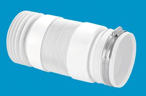

Hi,
I have a Ideal Standard Concept Back to the Wall WC that I am fitting myself.
I notice the Pan spigot is unglazed. Can the conventional/standard push on pan connector be used? I'm worried if it would provide an adequate seal. Is it normal/better in these circumstances to use the connector type which has a jubilee clip that is tightened around the spigot as advertised by McAlpine, as per below:
Put it another way, I'm not sure why the McAlpine connector above is specifically noted for use in Back to Wall WC and not all standard types.
Thanks in advance for your advice.
That's the one to use cuz the others are a b'stard to fit and come off when you can't see them:notworthy:
The jubilee clip type is useful when you have a tapered spigot (whoever designed those needs to be strung up by the ********). An unglazed spigot should stop the connector popping off. try to push it on without using any lubrication if possible but you can lube the other end. Whatever you do, it will be a pig to connect because they all are. Test by sliding a piece of thin card under the loo before fixing then flushing.

Jut to say I used the connector with the jubilee clip at the top of this thread. - all went well. No leaks so far!
Thanks again for the advice/tips.
