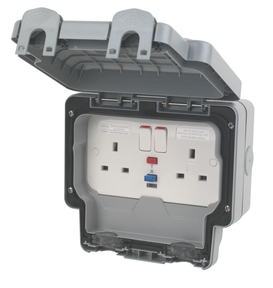

Have just installed an MK Masterseal double rcd switched socket like this:
ae235
Very impressed with the quality and ease of fitting, unlike a lot of other MK stuff I have tried in recent years.
https://www.screwfix.com/p/mk-masterseal-plus-13a-2-gang-switched-rcd-socket-active/26746
Blup
The socket shown in the picture is an RCD one and cost £70!. You won't need that for a brand new house as the circuits will already be RCD-protected.

If the OP wanted to fit an active rcd how would that be achieved if the consumer unit is already rcd protected?
Blup
For that money we don't even know if he is a time-served qualified spark with the correct test gear and paperwork.
Why would he need one, for a lawn mower, when the cct is already 30mA RCD protected?
Wanting an active RCD (aka effectively for the 'NVR' switch) is not necessarily related to the RCD protection it provides.
Given that RCD protection is becoming increasingly ubiquitous, so that RCD sockets, are progressively less needed for RCD protection, I'm a little surprised that we haven't seen 'NVR sockets' appear for use with power tools etc. - rather than oblige people who want that functionality in a socket to buy an active RCD one.
Kind Regards, John
I assumed, but didn't know, that rcd's in consumer units are "passive".
I raised the question because the advice on this forum over the years has generally been to extoll the virtues of active rcd's in relation to equipment that could cause the user harm if it (the rcd) remained "on" after the initial loss of power was restored, and the equipment was re-started by the user or itself. That's certainly why I sourced the MK active rcd socket for my own use.
