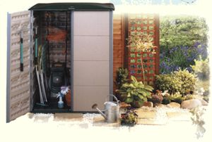

I have one of these waterproof heavy duty cupboard in the garden where my waterproof electric pump/filter which is inside the cupboard with the waterproof socket. I now want to use a timer to operate the pump, that why I ask if they do a waterproof socket with a timer. I can put in a timer adaptor into the socket but won't be waterproof specially if the hose come off or split, the pump water will be spraying inside.
