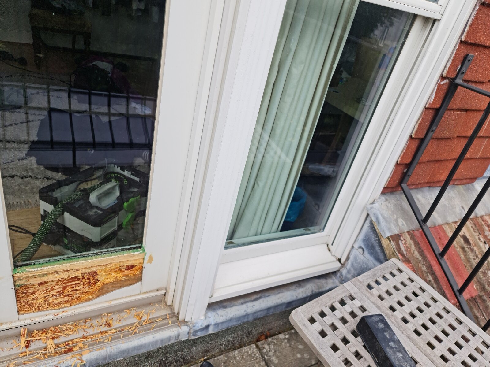

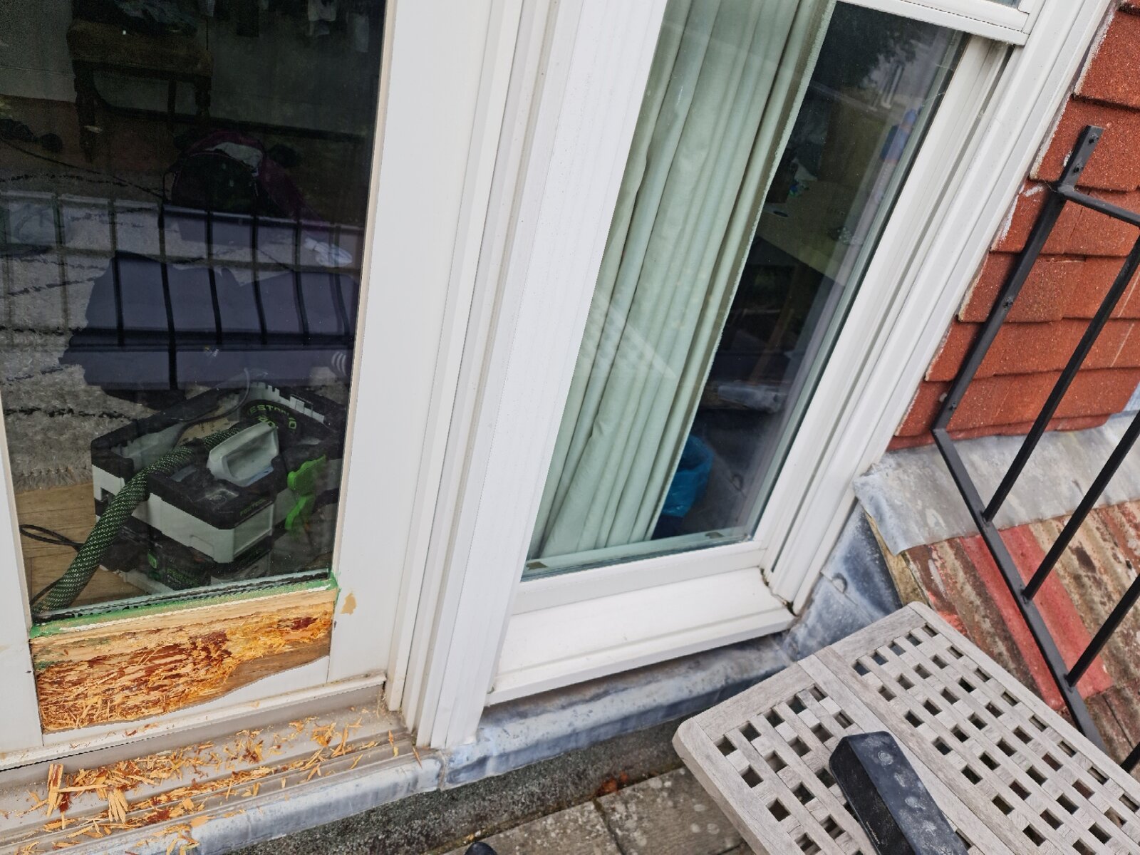

This week, I had to deal with a plywood door that had severe rot.
I removed various layers of ply, used wood hardener and then glued in new 12mm hardwood ply using epoxy resins. Epoxy resins are slightly flexible, regular two pack filler isn't.
Epoxy resins are however much more expensive than 2k fillers. Additionally they, often, need dedicated 2 barrel gun to dispense the resin.
If it is a join where the rails and stiles meet, at a push, you could use masking tape and a MS polymer caulk- eg CT1. You will however end up with a slight ridge, but it should be able to deal with movement. Oh, and it will need to primed with water based primer before you apply any oil based paint. Oil based paints over MS polymers do not cure- no idea why- months later, the paint will still be tacky. Apply waterbased paint first- no problem.
