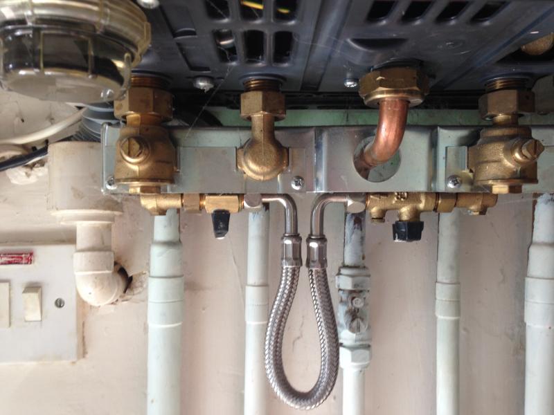

Morning all,
My Ariston boiler has developed an interesting fault.
When I turn both taps on to recharge the system (after draining to remove a radiator), the left-hand one leaks. It's only a drip, and it stops when I close the taps, but I don't like it.
I've tightened the screw inside the black plastic tap to no effect. The drip is coming from the top of the same.
Is this something I can resolve myself or is it plumber time?
Pic!
The troublesome tap is the one on the left.
All advice gratefully received :)
Needs a new filling loop. Will have to be an Ariston specific one IIRC as it is a smaller than normal thread. Not difficult if you can change a rad.
