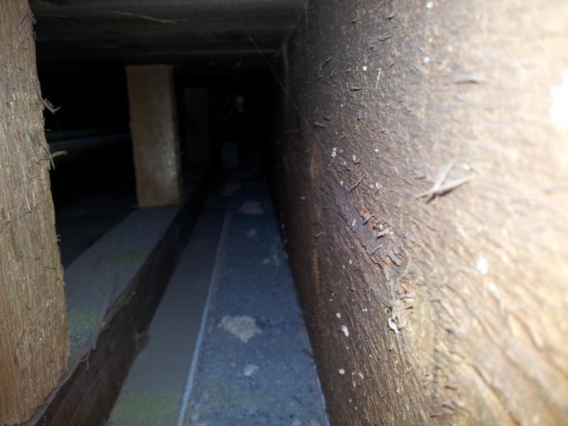

Background: We have removed a downstairs wall from our 1970 detached house, It was a brick wall, above it there was nothing and you could see the top of the wall when lifting the floor board. there is however an upstairs bedroom wall also built of brick directly adjacent to in that sits onto two joists that have been bolted together.
Both our builder, B\C and a structural engineer all said it was fine to remove the downstairs wall as it was not load bearing, all floor joists run in parallel to this wall, and the weight of the above wall is carry by the joists.
Hopefully the pics explain it a little better.
It has been just over 4 weeks since we removed the wall, and I have noticed the bedroom door on the wall above does not close properly any more, and the hinged side has drop about 5-10mm, and a small crack is starting to appear above the door. above the door is hollow.
I am worried that the joists are not supporting the weight of the wall above, there are other bedroom walls in the house built onto joists, then actually floorboards then the wall, and they have never had walls beneath them at all.

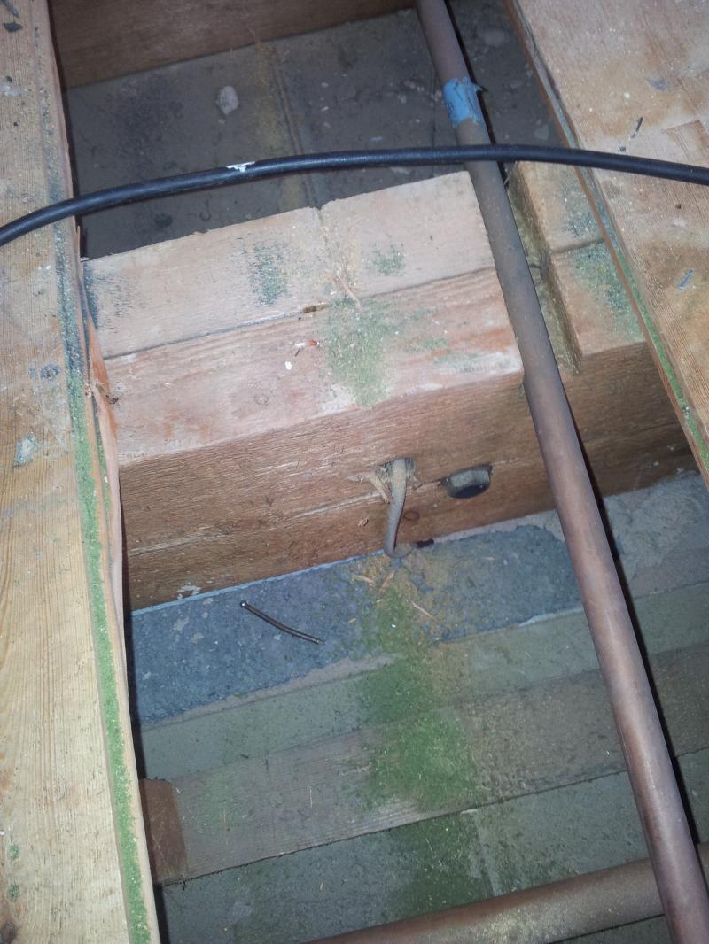

Its difficult to understand the lay-out of walls and joists from your post - eg. why wasn't the ground floor wall designed to support the bedroom wall?
Do the bolted chamber joists run parallel with the recently removed ground floor wall, as pic 3 seems to indicate?
Is pic 3 taken in a doorway? If not, where is the wall?
What am i looking at in pic 2?
Are you certain that no joist was directly, or indirectly, supported by the recent wall?
Do all the joists, including the bolt-ons, run in continuous lengths from bearing to bearing?
Perhaps, a visit to the loft to see if you can see (& pic) anything suspicious above the bedroom wall?
Do you have roof trusses?

The floor joist all run parrallel to the remove wall and are supported on the front and back walls of the house, and a middle wall downstairs.
Do the bolted chamber joists run parallel with the recently removed ground floor wall, as pic 3 seems to indicate? Yes they do
Is pic 3 taken in a doorway? If not, where is the wall? Yes this was in the doorway

There has been a little more movement since my original post. but not a lot. maybe 1-2mm if i was to jack/prop the joist from below back up in line, how would i go about strengthing or supporting it to prevent this sagging again ?
My main concern is will it continue, and that the door is out of alignment now.
I sought advice from the same Structural enginerr and he has said that some settlement of the joist is to be expected, as the wall below may have provided some lateral support, and it is perfectly safe.
