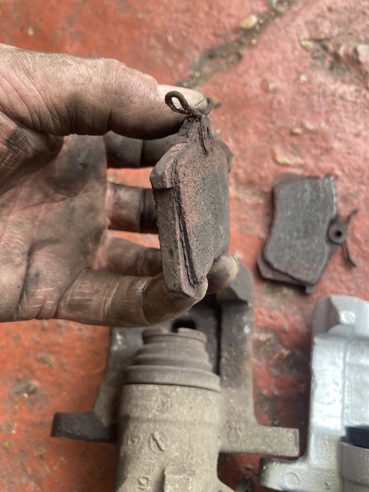

Pretty sure that's what it is now. Brought the car up to the workshop this morning, all fine until I was nearly here when the pedal started to drop alarmingly leaving just the second circuit to stop me. Got to work, felt the rear wheels. Offside normal, nearside (the one that was binding last year) was stinking hot. Got other stuff to get on with at the moment so when they have cooled, I'll check that out before I go home and pick up another caliper tomorrow.
Replaced the calliper, just waiting for a set of rear pads to be delivered- I think I’ve had the most out of these!
Shouldn't that brake pad, thin though it is, actually have shined/flat surface as it's in contact with the disc. The fact it's NOT shined/flat indicates it's not in contact with the disc. Same as the one in the far-ground of the image

Discs are perfect. I only changed the pads and discs in June 2021, about 8,000 miles ago. Still waiting for the f'cking pads to arrive. They've sent the driver to the Isle of Dogs on another delivery but the idiot drove straight past me and is supposed to be dropping them off on his way back. :evil:
Those pads look a lot older than 8000 miles, matey!

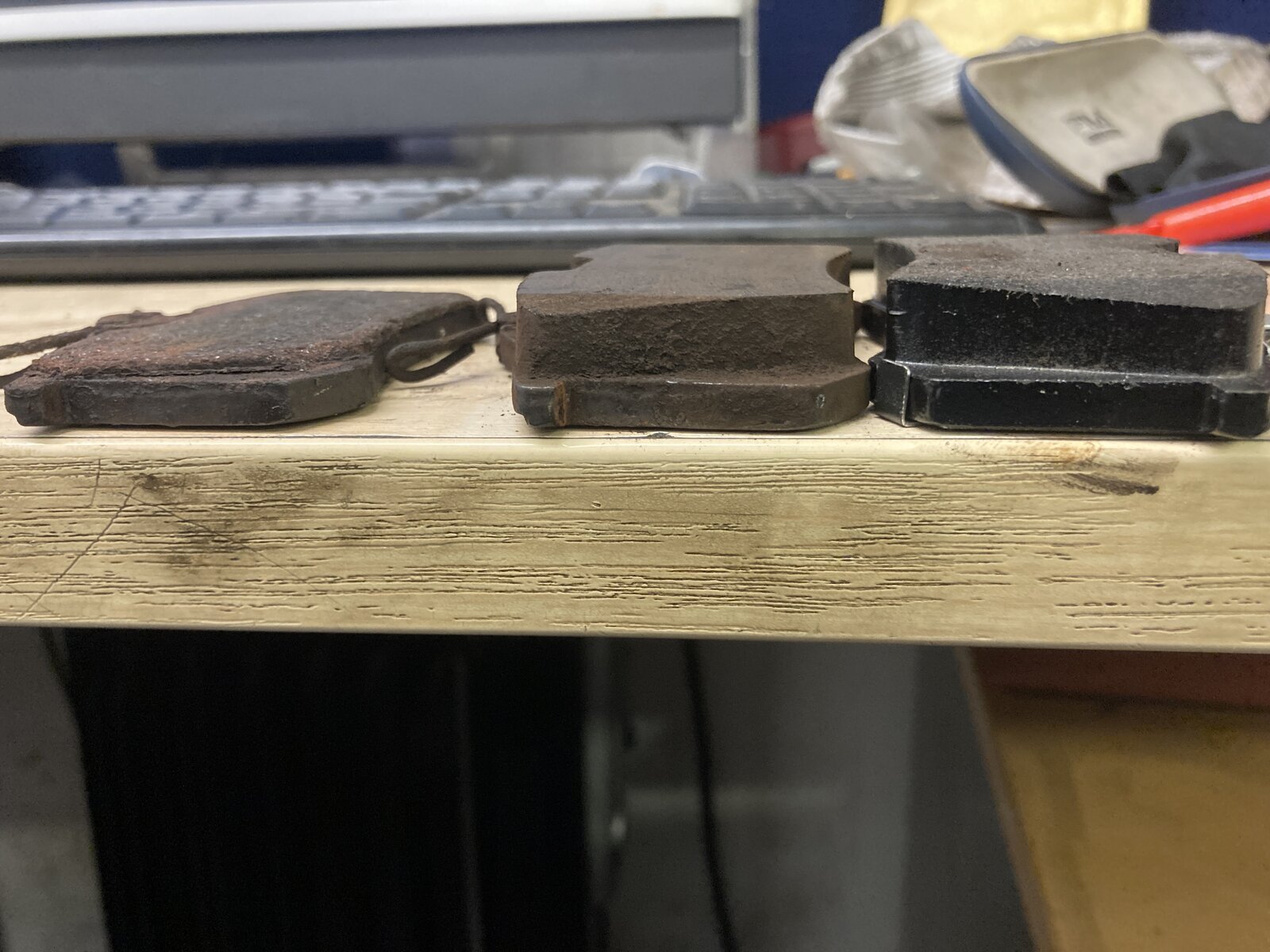

Definitely not - maybe even less! Heres the pad from the n/s (sticky calliper) alongside the pad from the o/s against one of the new pads. Hardly any difference from the 2 year old pad and the new one. When I was fitting new pads in the other side, I thought for a moment that that caliper was siezed too - I could only get half a turn at most on the wind back tool. When I looked closer, it was almost fully back anyway!
Brakes worked fine on the way home and both rear wheels were just warm to the touch after my journey.
