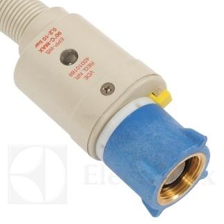

Forward another couple of weeks and now noticed in the morning a puddle under the sink dripping from the connection to the washing machine. There is block attached to the hose which I'm not sure what this is.

Hard to visualise from text. I think some snaps may get more replies, especially identifying the mystery 'block'.
Hose is like above.
