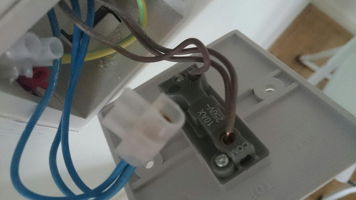

I've just bought my first house and mounted 3 down lights.
Now I'm coming to run the cables I'm a bit confused (fwiw a qualified electrician will be making the mains connection).
While I attempt to trace these cables, anyone know what's going on with this setup? The house is circa 2006.
I've replaced the single light switch with a triple (for the new lights, 2 sets of downlights plus main light)
But in the single switch, there are 2 live into the one com then a single live out on L1.
In the box, there are 3 cables. 3 live wires - wired to the switch, 3 neutral and 3 earth, N and E are terminated (see pics).

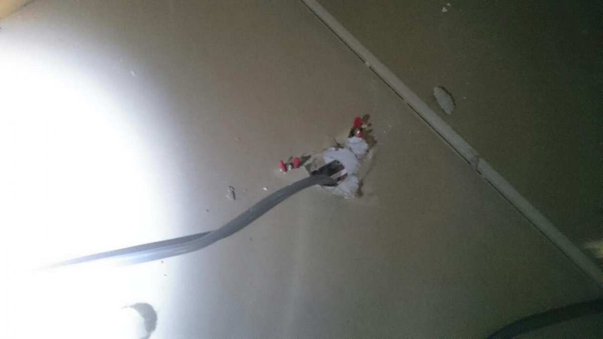

The main light is run from a single LN pair (see pic)

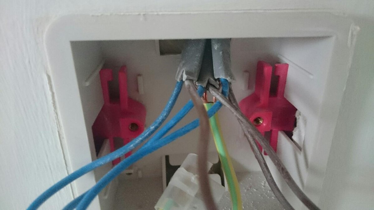

The cables coming directly from the cavity of the switch contains FIVE cables (see pics) The one on over the wood goes to the main light. Then there's 2 pairs that go off (and I'm about to dig around to find where they go.
Any ideas on this? What I need to do is run 2 more cables down the wall to the switch for the new lights, but, in my very very very limited experience, there should be 1 cable, Live, Earth and Switched Live. Not 3 cables with 9 wires for 1 switch!

Ok, so this might sound stupid and please remember I won't be connecting the mains. But is there any chance that this setup means I don't have to run switch cables for the new lights?
The is 1 main light in the room.
There is 1 switch for the main light.
Unless there is a separate feed to some other (blanked off) lighting position, then it will be power coming into the switch on one cable, power continuing on to other parts of the house on another, and switched power to the room light on the third (the one with the single brown wire to the switch).
Not quite sure from the photo, but are two of those larger than the others? Is there a socket or other outlet below where they disappear into the wall, either near to the light switch or on the opposite side of the wall? They're quite likely unrelated to your light switch.
You will just need a cable from the switch(es) to each light position with switched live, neutral and earth.
I don't see any conduit in the pictures. If this is an interior stud partition wall (as it appears to be), the cables are most likely just dropped down the side of a stud with a few cable clips. You can enlarge the existing hole in the ceiling slightly, if necessary, or make another one alongside it and just "fish" the new cables through.
To clarify everything said before, you need to add two seperate cables from that switch, one cable to one set of new spots, another cable to the other set of new spots. This will allow a 3 gang switch to be fitted.
However, if getting the new cables down to the switch is going to be difficult, and it would cause damage, your electrician would be able adapt that existing wiring with the clever use of a junction box in the ceiling void/loft. By doing some clever junction box wiring, there will be no need to drag any more cables down to the switch.
Hopefully your electrician will be experienced enough to figure out how to do this. He will need a 20A 6 terminal junction box.

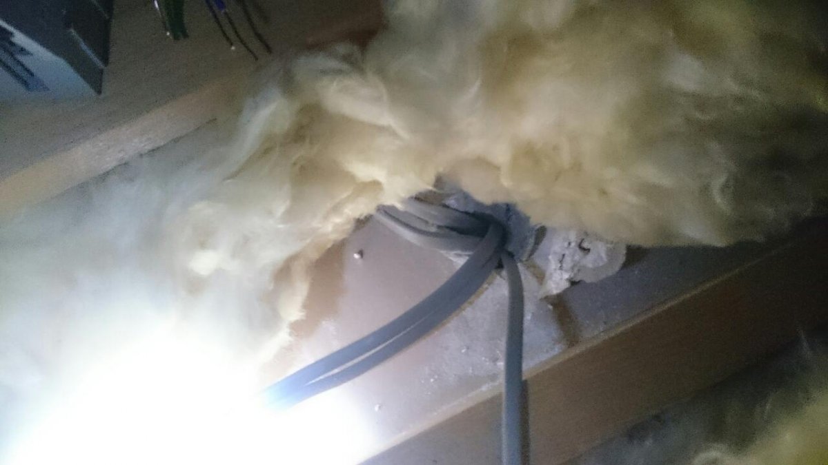

Just to update, so there's 3 cable pairs in the light switch box (which I know understand with looping in switches) and 5 cable pairs coming out of the top of the conduit. I can't seem to work out where the extra 2 are going without pulling the entire roof of the house apart.
When I turned off the "upstairs lights" at the consumer unit, all upstairs lights went off but the sockets remained.
I tested the 3 cables in the light switch which were all dead. But this still doesn't account for the other 2 cables.
A suggestion was made that they might be for sockets, in the bedroom (room in question) there are 3 double wall sockets.
What I'm thinking now is that if any of those five in the loft are for the sockets, then they are live while I'm trying to feed new cables down that hole. Which isn't going to be good right?
I guess what I'll do tomorrow is knock off the lights at the unit and then test all five in the loft. I guess at least that way I'll know A: They dead before I start feeding god knows what down the holes and B: They are all for lights
