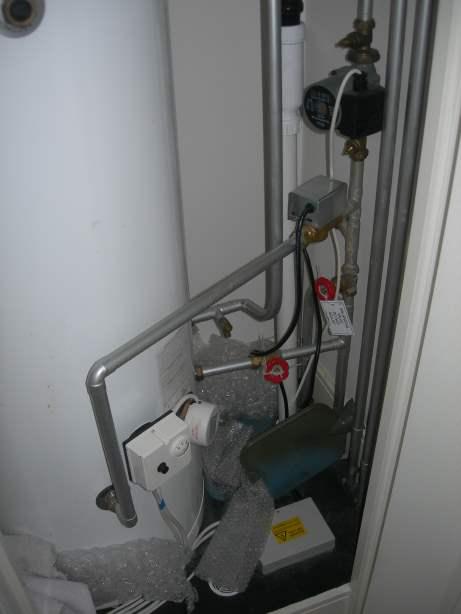

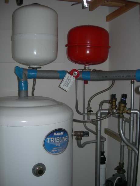

I’ve recently started noticing a very strange, intermittent noise from (I think) my airing cupboard. This is directly above my head as I lie in bed, with a big hot water tank, pump etc. The house is only about 7 years old. Beneath me, in the kitchen, is the boiler.
I’ve only really noticed this as I’ve been sleeping very badly lately – as I’ve been lying there, trying to get back to sleep, there’s suddenly a noise like a valve clunking open, a 2-3 second rush of water, then the valve clunks shut again! May happen more than once a night – and, for all I know, during the day too.
It’s exactly like the noise a washing machine makes as it opens its valve, lets water in, then closes the valve again – just of shorter duration.
What the hell can it be? The heating hasn’t been on for months; no washing machines or anything on at night; and the boiler doesn’t come on to produce hot water till 6:00 in the morning :confused:

What type of system do you have?
I'm assuming unvented cylinder and two two-port valves.
Maybe the pump kick pushing through the by-pass valve.
I’m sorry, but I know nothing about heating and plumbing, so I don’t know what information to give you , so I’ll try to add a couple of photos. But from what you’ve said, I don’t think I stand much chance of understanding the explanation anyway :cry:

There is also a possibility that your cylinder is discharging as that can be a similar effect. But that would normally only happen when heating up from cold which you are not doing in the night!
If you suspected that then put a strip of newspaper across the tun dish and if that was leaking it will be all wet in the morning.
