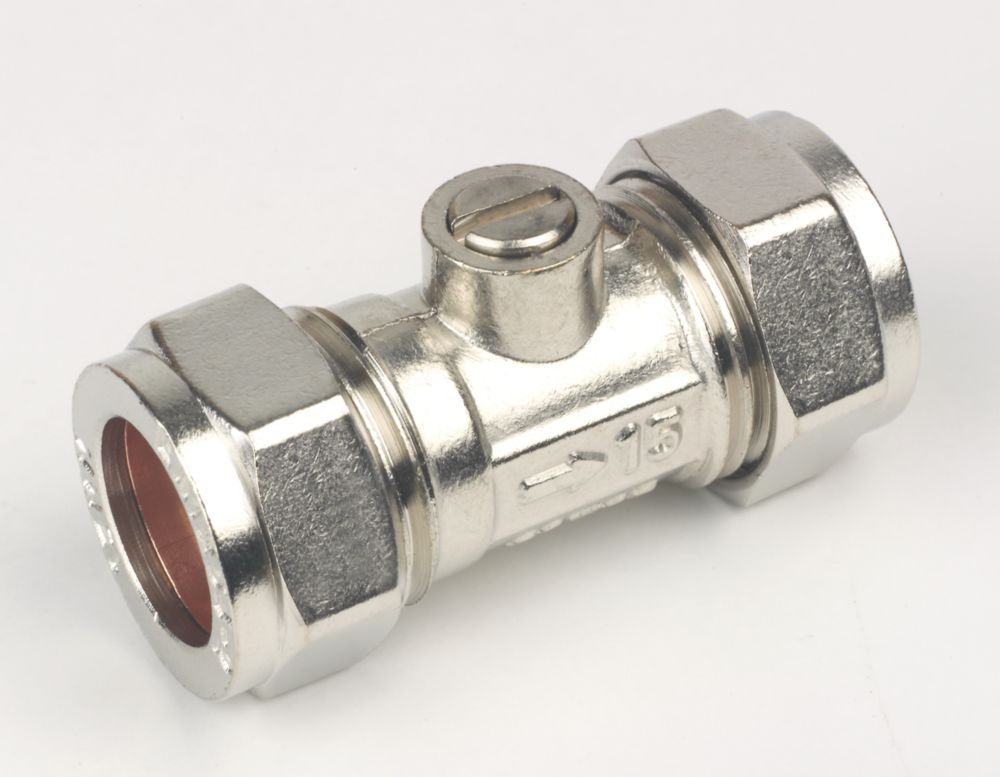

Look out for any service valves, especially if they look like this
ae235
which is a very poor quality one and may leak.
they constrict the flow and can be replaced with better ones.
