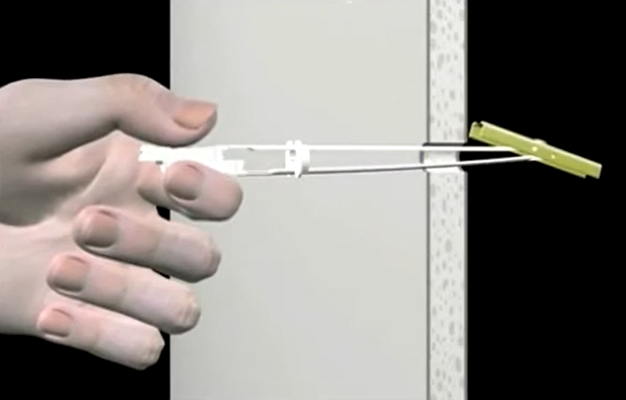

But where are they going to fit? This is how a snap toggle works:

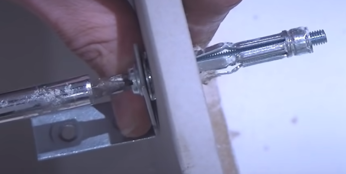

So you clearly need a 30mm or so wide cavity in the wall to make that work. Same goes for my own preference, the "umbrella" or hollow wall anchor:

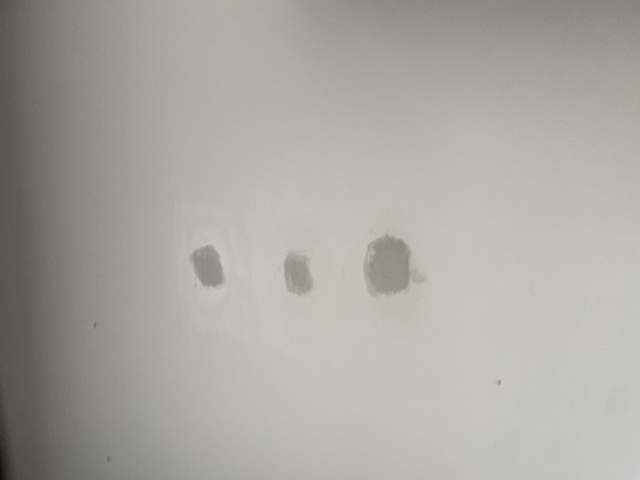

I don’t have much info about the metal uprights. The only reason I know they’re there is because I was drilling into the wall for another purpose and could see the edge of a metal strip on the inside. They seem to be quite thin bits of metal. My first thought was the same as yours — just a frame to hold the plasterboard sheets in place. In which case I imagine they’re not studs I could use for support?

I don’t have much info about the metal uprights. The only reason I know they’re there is because I was drilling into the wall for another purpose and could see the edge of a metal strip on the inside...

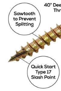

This means that your studs are useable to carry the weight of the TV. The main downside is that you either need to use metal (fine thread) drywall screws to fix to them (coarse thread wood-type drywalls may not be able to pierce the metal) or alternatively a good quality 4.0mm wood screw, like these Spectre screws can be used. The reason for 4mm, not larger, is that a 4mm wood screw can drill through MF, with thicker screws you'll often struggle. The Spectre screws I linked to (together with more premium screws such as Spax or Reisser Cutter screws) have what is called a "slash point" which cheapo screws lack:

Where I deal with cavity walls, which we now know yours to be, my own preference is for "umbrella" (hollow wall) fixings over toggles. I admit this is partly historical - I have had the setting tool for a few decades (which cost about a tenner) and I've found them reliable in the shop fitting environments I used to work in. I've also have book shelves at home on Spur shelving where alternate uprights are only onto "umbrellas" (no stud behind them) - they've been up for about 25 years now (on double 12.5mm PB). The trick to making this sort of thing work is always to spread the load over the biggest possible area with more screws than you actually need to carry the load. That way everything is understressed

Your points here have made me a bit concerned on an assumption I had before…
The cavity space I found before IS on a partition to the apartment next door. I had assumed it would be the same with our internal bedroom partition wall that I intend to put the TV onto. Both walls are 100mm in thickness though, so I expect they’re constructed in the same way…(?) I’ll have to drill in and see!
Thanks for all the advice. I think my best course of action is to use a rare earth magnet to find where the studs are on the wall — if their positions can work with the TV bracket I will get some of those special screws to get into the metal studs, but otherwise will consider the pattress approach. Although, from a bit of research, I’ve found snap toggles apparently can withstand more than 100kg of force each, and the TV is only around 25Kg, so I might just investigate those a bit further and see how robust they really are.
