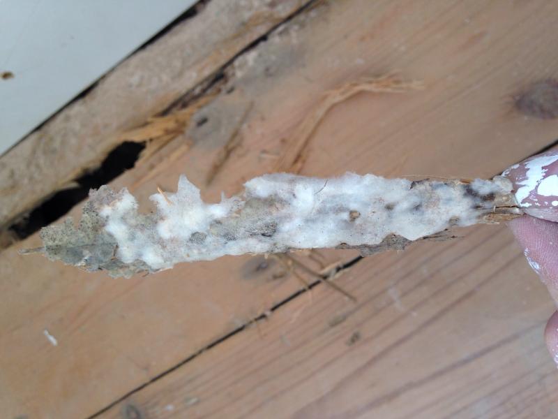

Edit: underfloor picture from poster's album, inserted by Mod after Footprints' post:
I hesitate to utter the words dry rot but I see you also have mould under floor, has the house been surveyed for damp rot etc?

Basically before we bought house we had one general building survey and one structural engineer survey. When we bought house we had 2 damp/timber surveys, and carried out work as recommended subsequently. No one in any survey mentioned dry rot possibility but flooring was covered in laminate at that stage.
Such a nightmare! We're the surveyors negligent in anyway? Surely as they couldn't see any of these things at that stage, they couldn't have been expected to detect it. Who do we get on now to solve the issue? Or can we do so ourselves? Surely there must be some test by some specialist that can determine for certain what both the weird webby stuff is and also the mouldy rotten stuff under floorboards? Would this be another surveyor or a another damp/timber specialist? Or are there mould specialists? Called a few people on Saturday and didn't have much luck..
Have a look to see if you can find a copper coloured "dust" around the areas of rot. And does any of the rot look like mushrooms.. If it is dry rot then it is a specialised job to sort it out. I hope for your sakes it is not dry rot,...
