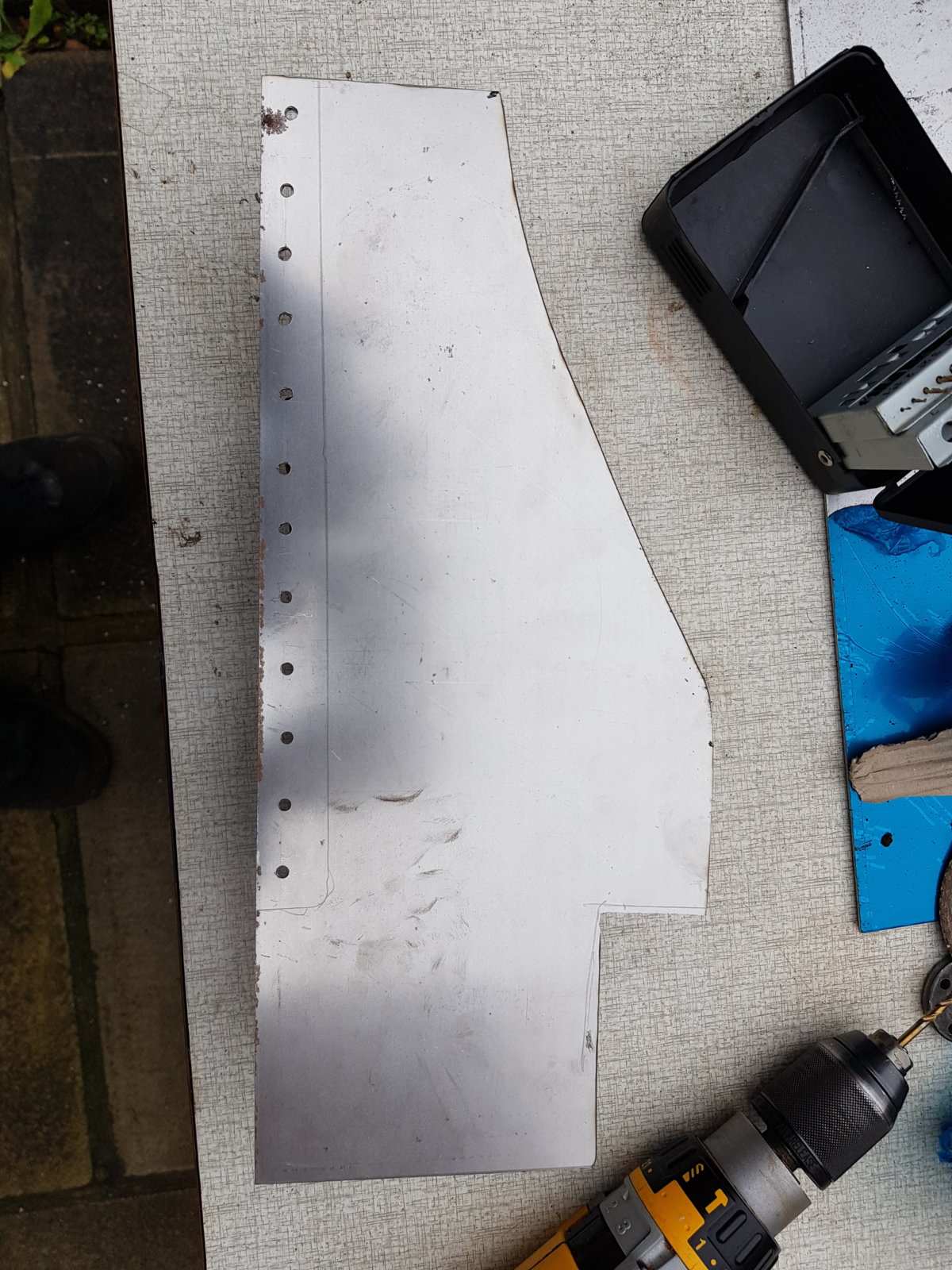

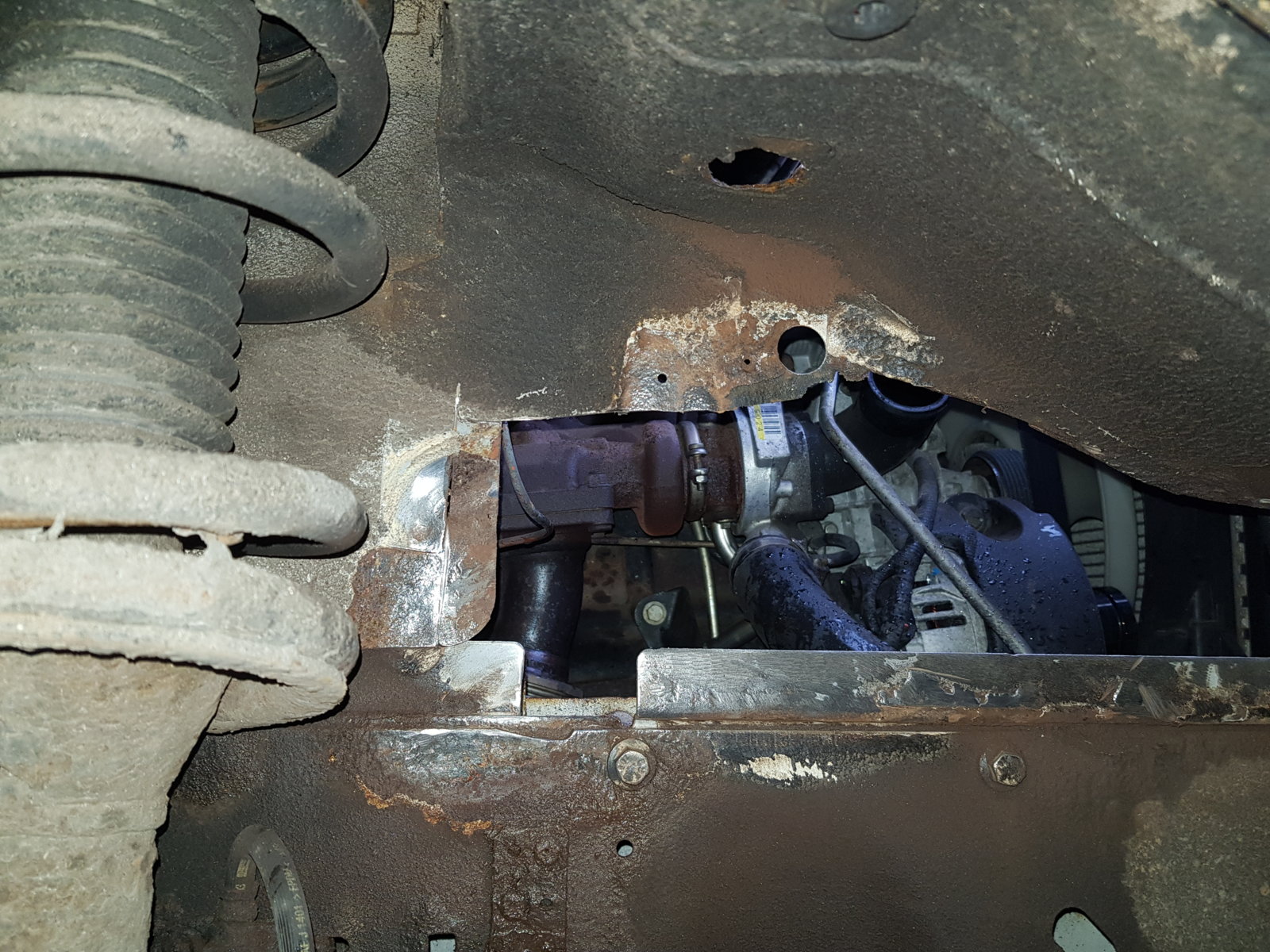

I recently welded up a Ford Transit minibus for MOT, it was a rot box!.

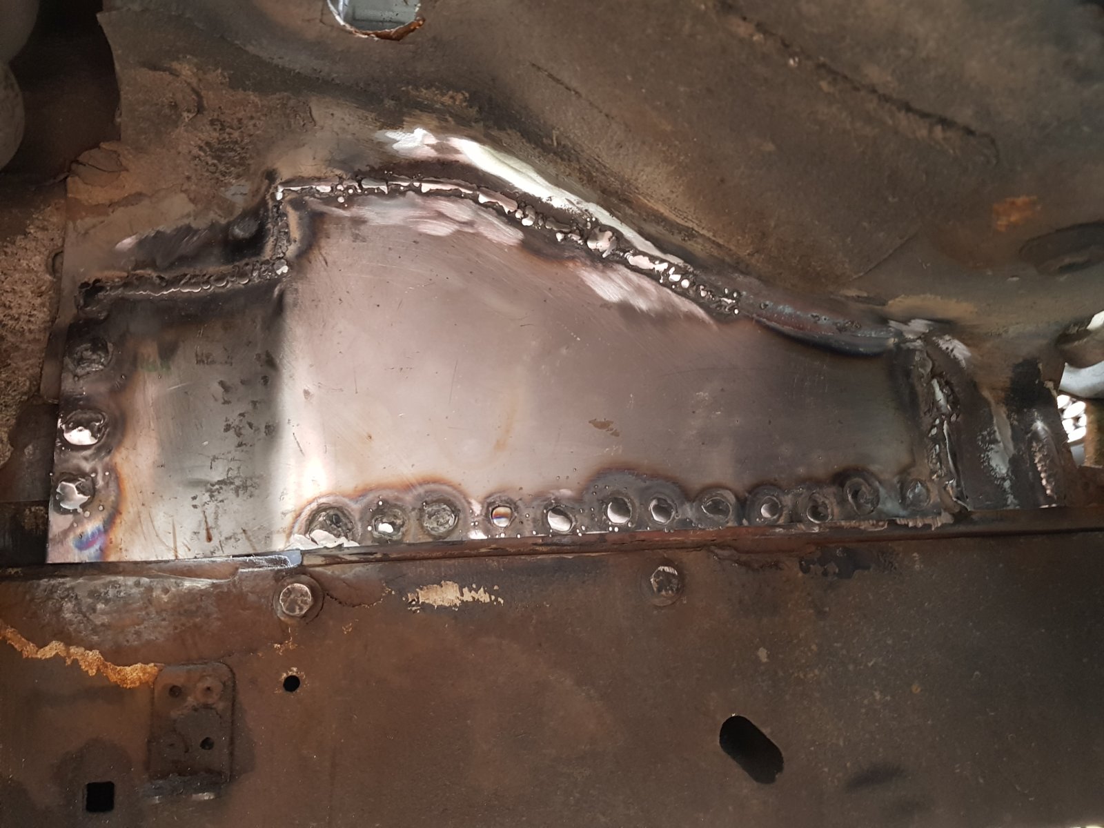

The rear sill and inner chassis was FUBAR, I made and seam welded a panel onto the inside but the bottom of the sill I plug welded (all the rest of outer sill was seem welded), this was to replicate the original spot welds.
I made and seem welded two front inner wing repair panels but again I plug welded the bottom of these to the chassis rail (original was spot welded).
Went straight trough MOT (was 4 Sundays work, for free for our Scout group).

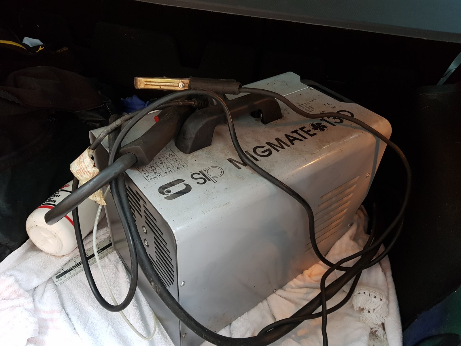

I used SIP Gasless mig wire in an old (20+year old) SIP Migmate Turbo 130.
Gasless went really well, no bottle rental for gas and it genuinely worked better outside (wind tends to blow the shield gas off "normal" mig torch).
Got my MK2 Golf GTI to do next, will be using Gasless on that as well.
My plug welds were probably every inch (or slightly less).
