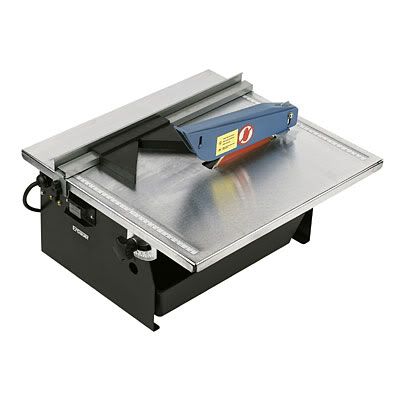

is this the plas plugs wet cutter you are talking about ?
if so yes it will cut granite

The plasplus contractor plus is http://www.plasplugs.com/tiling-tile-cutter-dww150.html
with the Master tiler being http://www.plasplugs.com/tiling-tile-cutter-dww180.html
The one you show is an Erbauer (seen it in screwfix!).
