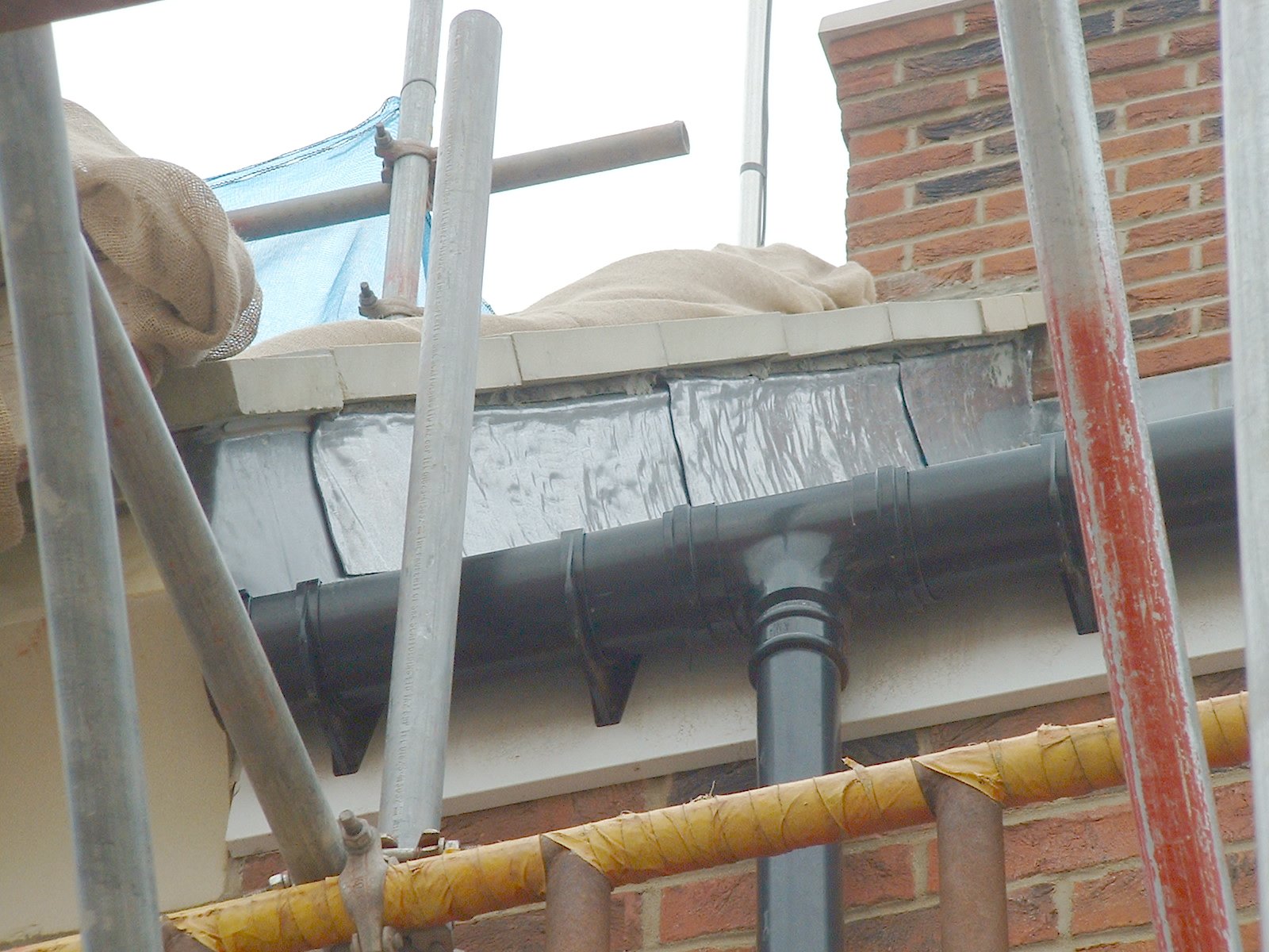

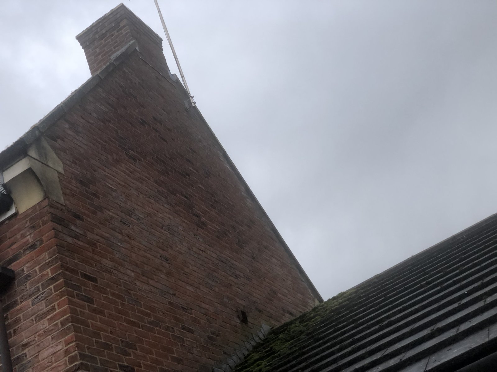

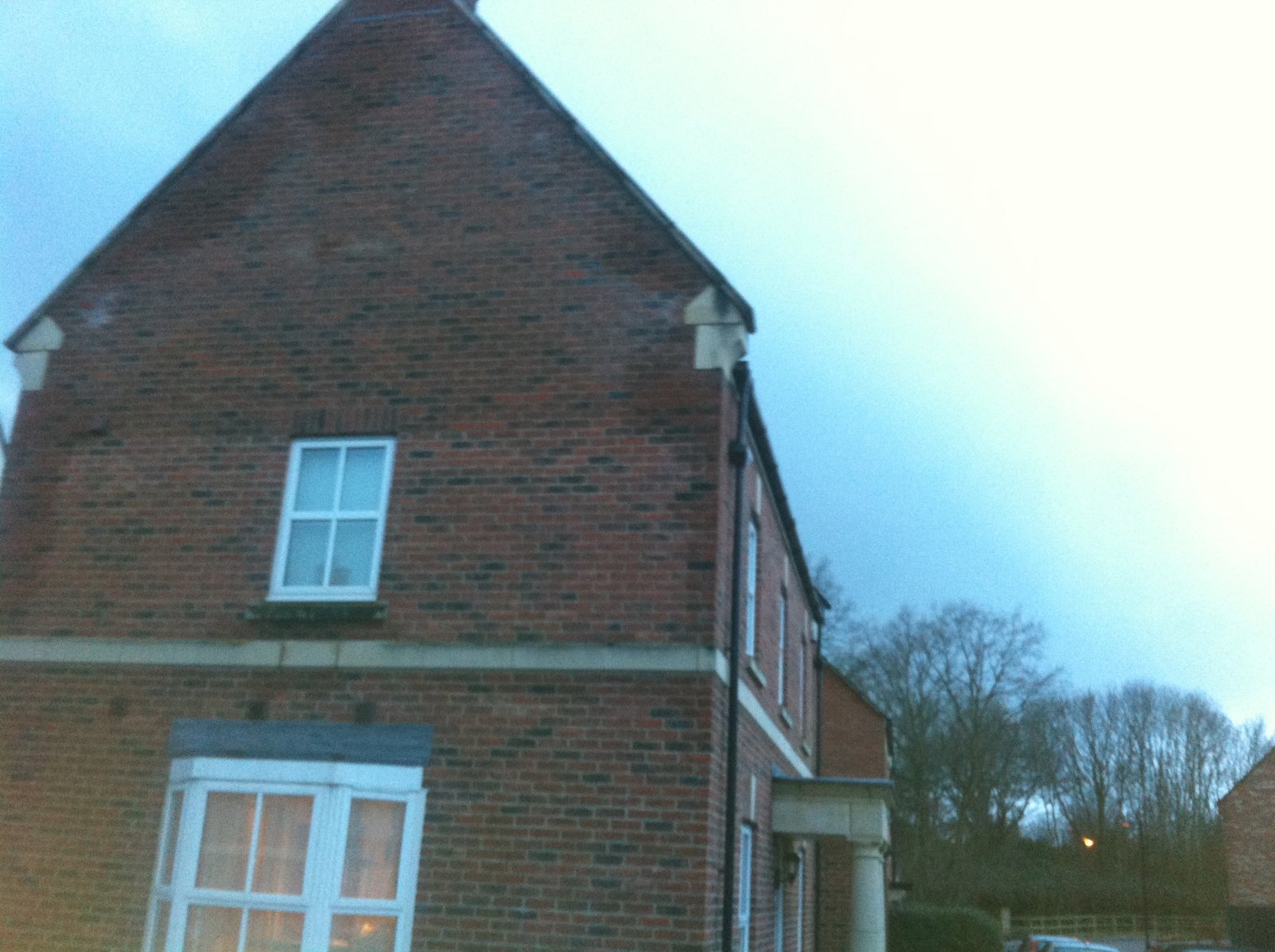

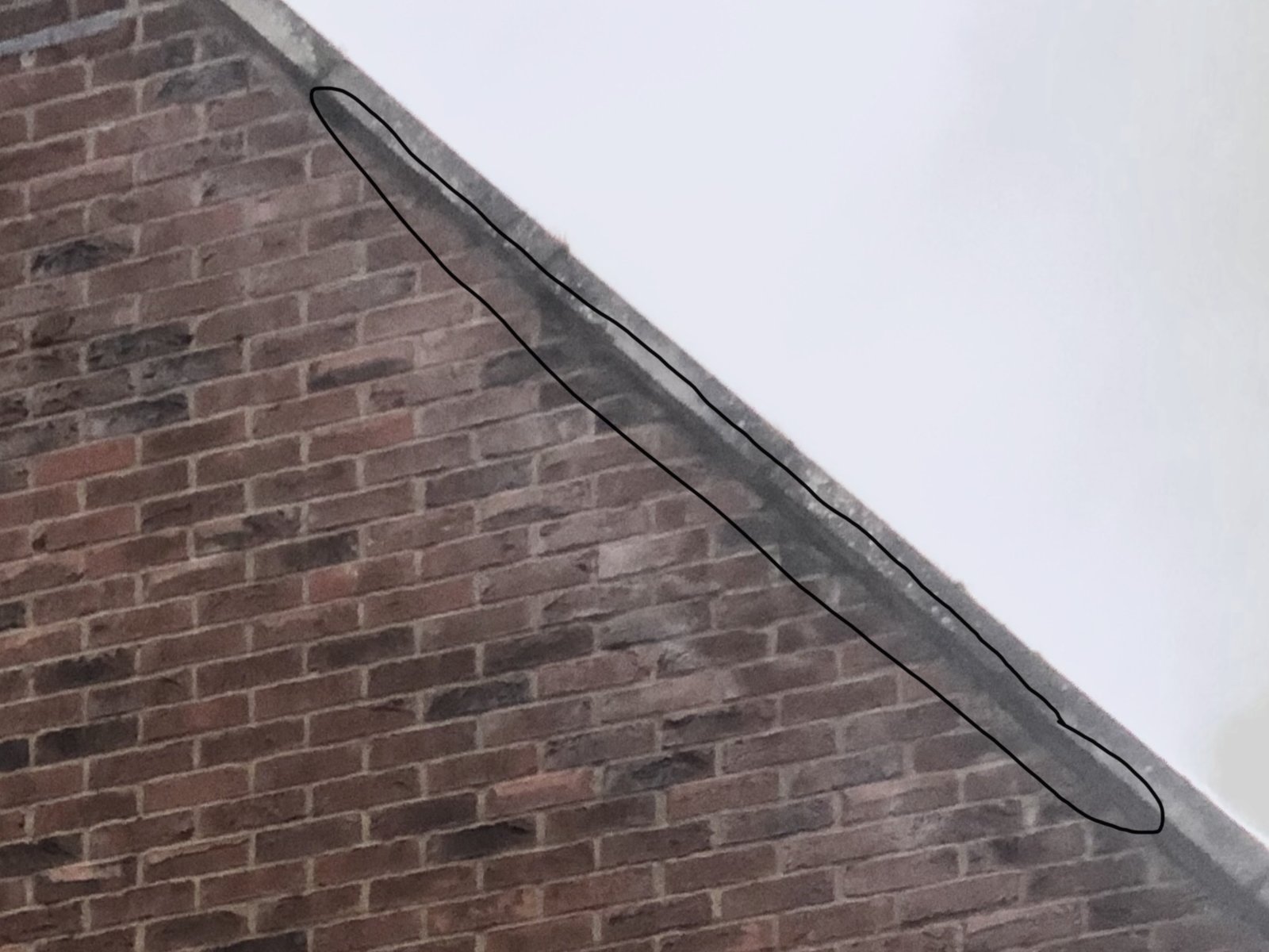

Both gable ends have been wet since build 2005. Builders been out under NHBC twice.
Carried out some repairs but still leaking/wet. Now out of NHBC so need some advice please. Where is the water getting in. Under the coping stones or the false chimneys.

sorry to say mate but there are too many significant bad variables showing in your pics.
a pro roofer could go up and take videos and give you a report, and a drone will work wonders - but you really need to have a RICS Surveyor to come out.

the parapet is vulnerable to leaks if the damp arrangement is not done properly.

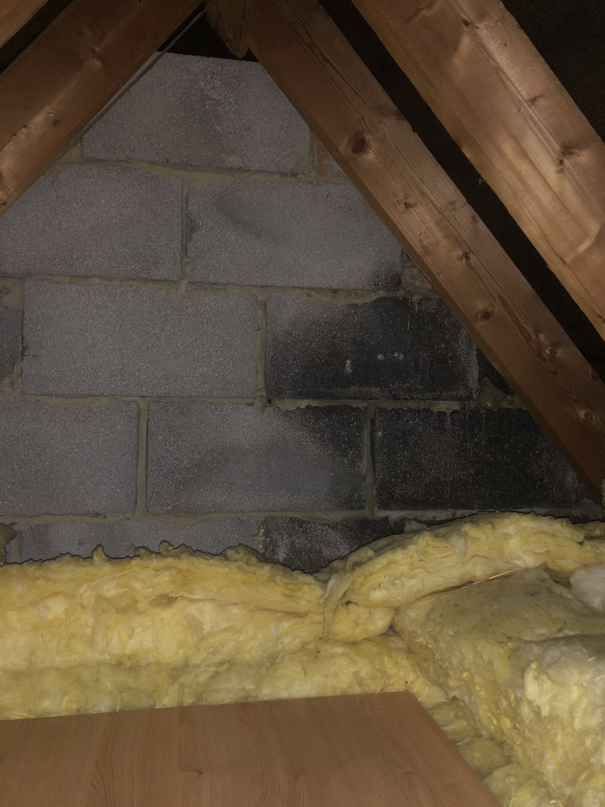

Judging by the internal pic its leaking both sides

All parapets with a cavity should have cavity trays built in. My guess is that it needs the cavity exposed -could be a block or 2 internally and investigating
To repair it properly it really need stripping back.

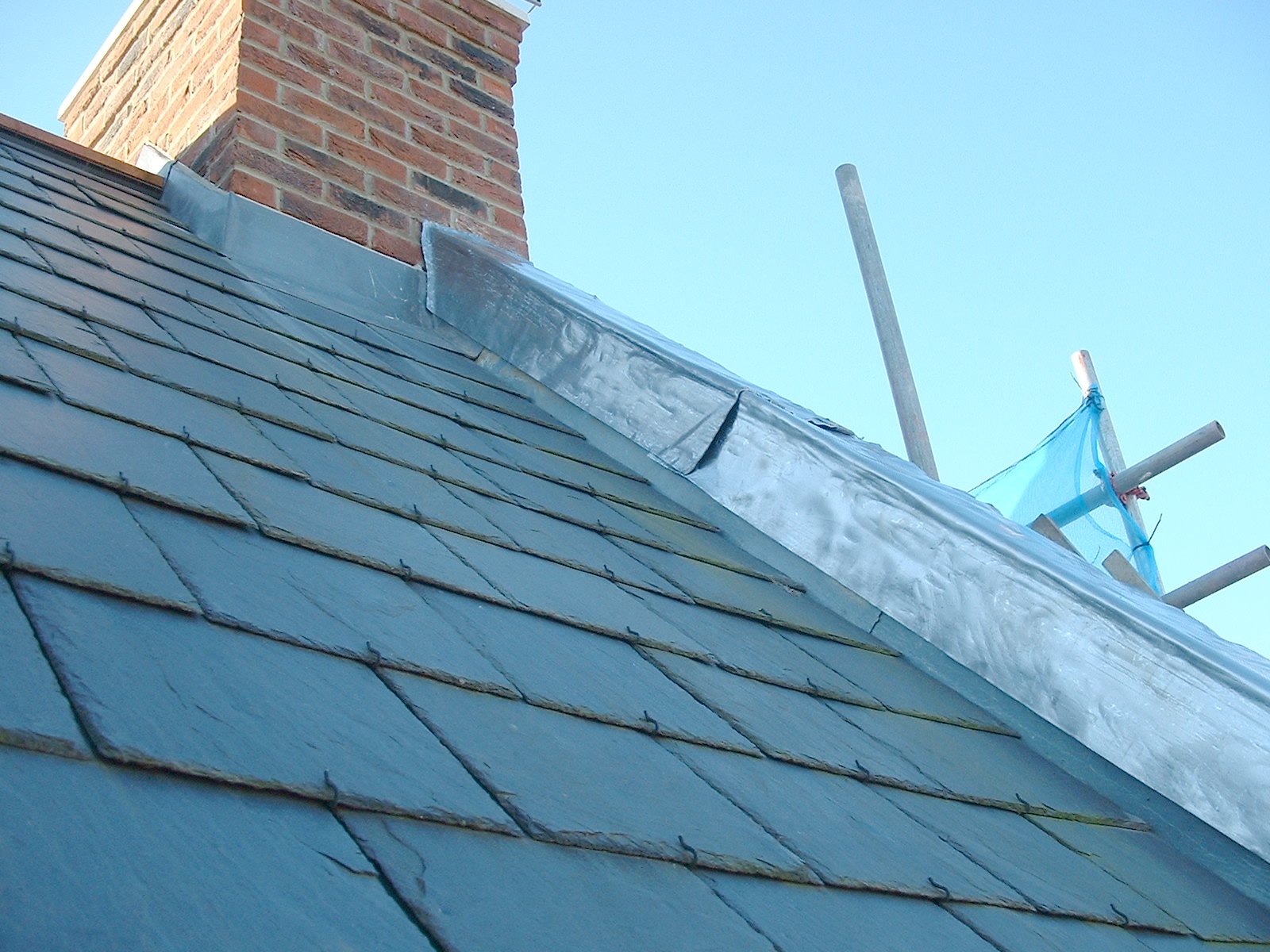

Only ones I got of 2097 repair

Again not an expert but the overhang on the gables looks ever so small- have you ever stood outside in the rain to see whether there's lots of drips coming off the capping stones? The corbelling on the chimney looks a bit small as well,,sure it should be 25mm as a minimum
first thing its untidy.
That aside weathering to the chimney (which i believe to be grp) is risky and a likely failing point
copings have no drip detail
roof side looks like a plastic secret gutter fitted.. presumably correctly?
The new leadwork id be interested what was done at the kneeler stone joint?
