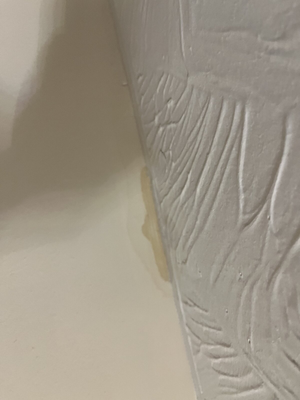

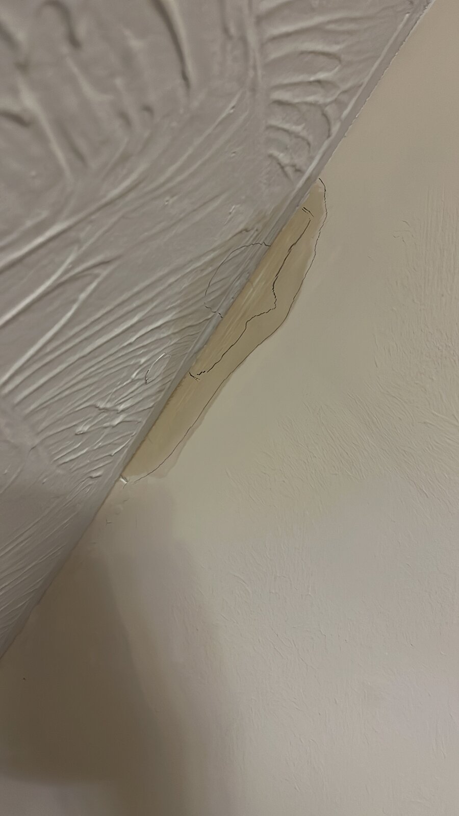

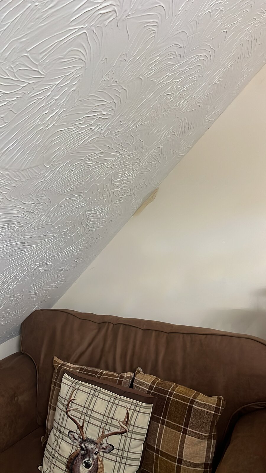

Hi I have tried looking at old posts first..couldn’t find a similar post.
I got this in the inside of my wall after the heavy rain last night.
Any ideas other than get a roofer to check the opposite side / which is a external wall…
Just interesting it’s right in the corner and I’m not sure if it’s comes through the wall or roof…

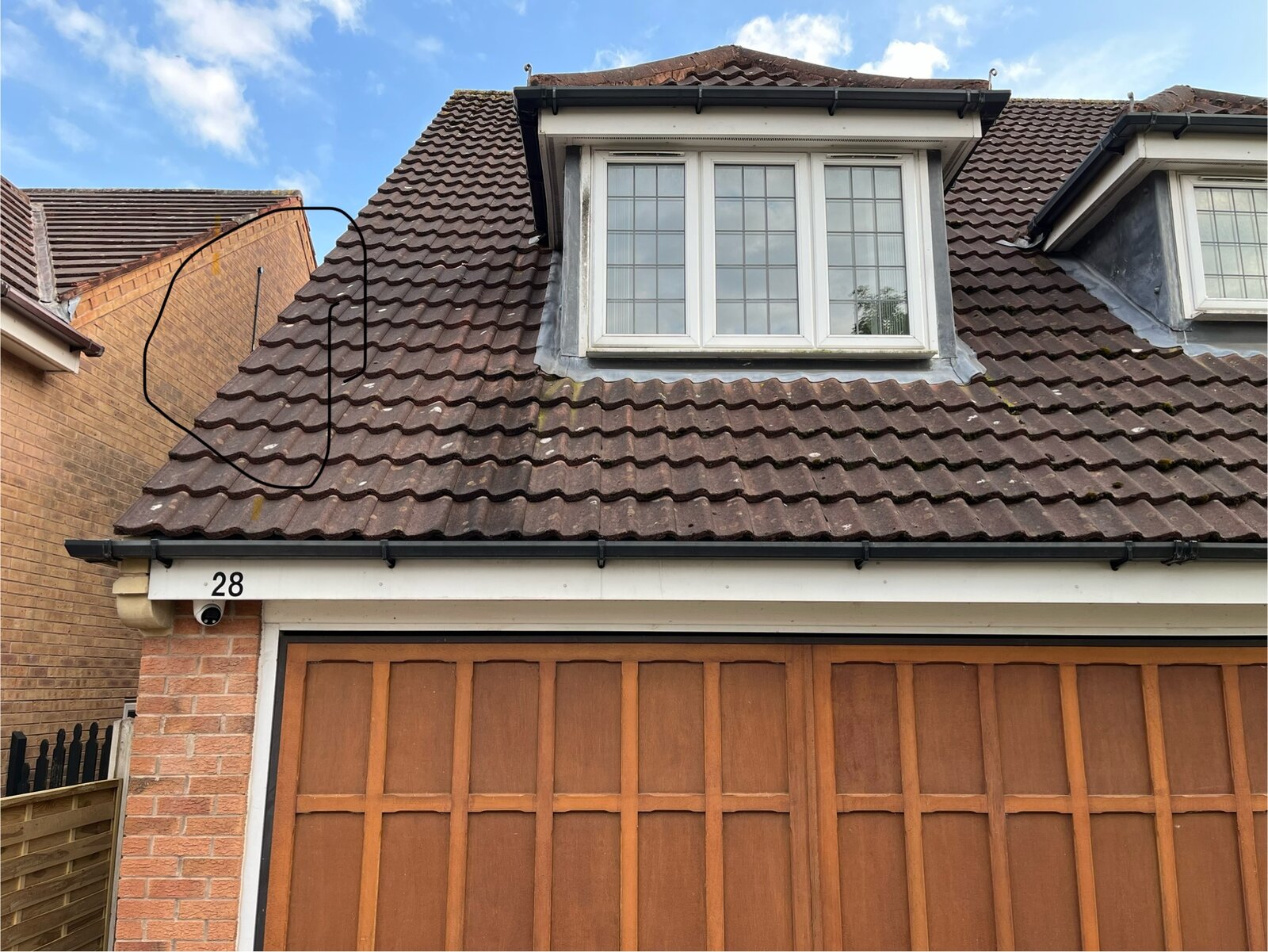

Hi thanks for your reply, it’s on the right side edge of the dorma.….as it’s on the end wall I am thinking it’s an issue with the black outlined section, hence the edge of the roof line, will send a pic asap
Here the pic with the outlined bit….which is where I think the issue is
Is your verge in a similar poor condition as next door?
11 courses up 3rd tile in from verge has been pushed up.
