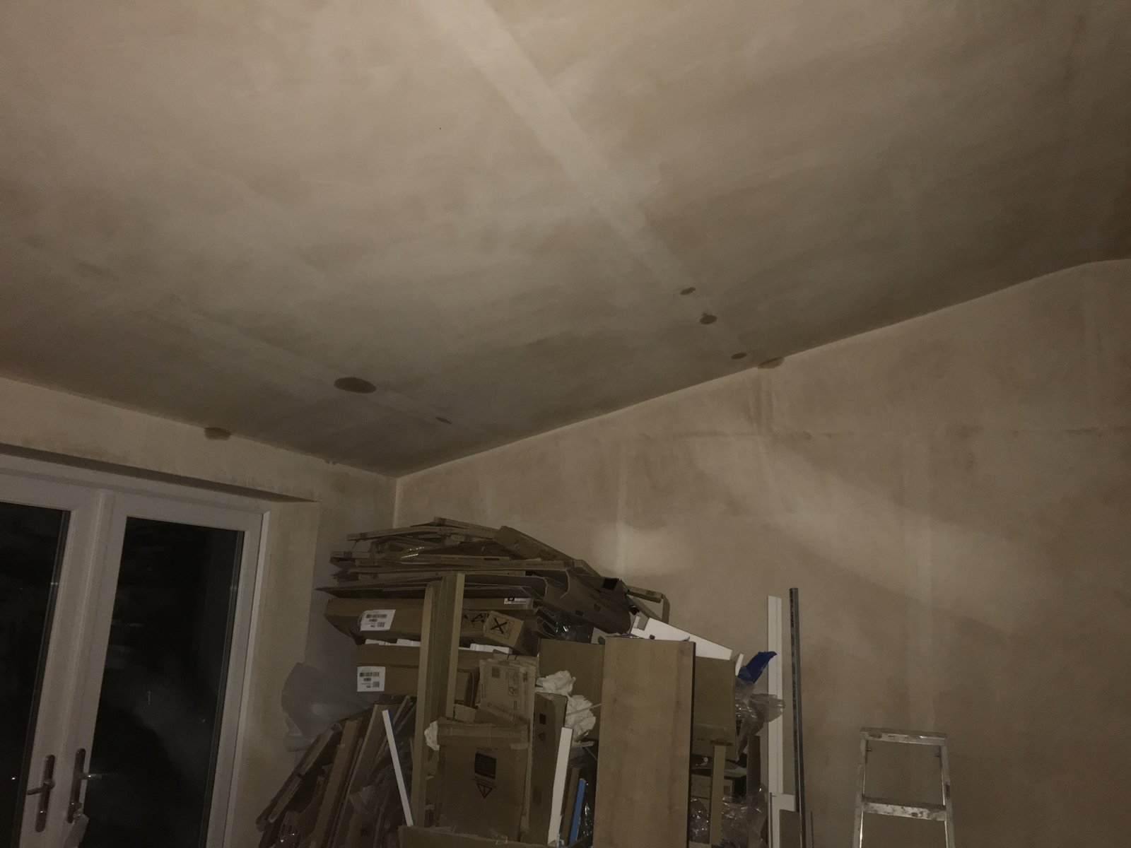

I have currently had a single storey extension construction on the back of my property housing a new kitchen.
Since I have had the ceiling plastered a small wet patch was keep appearing and then going some times without any rain. This never occurred when the ceiling was boarded its only ever since the plaster was applied.
After heavy rainfall last night I came across this morning more than one wet patch showing, was just wondering before getting in touch with someone if anyone has ever had a problem like this?

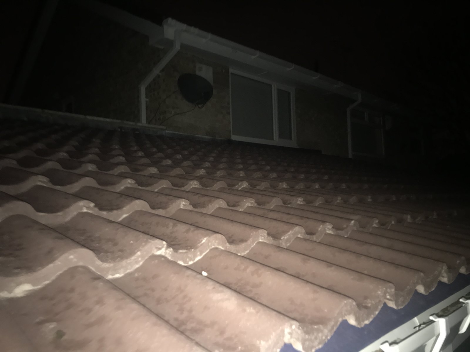

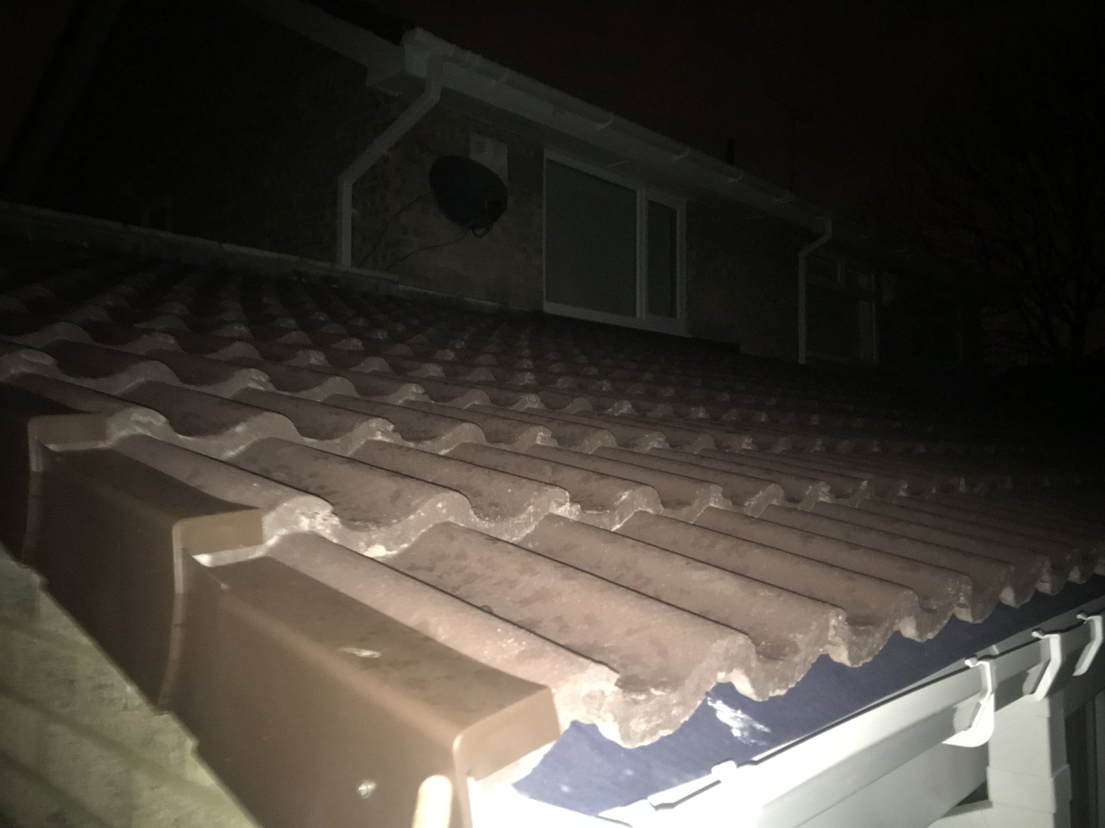

pphotos of the outside of the roof,show detailan the whole roof please.

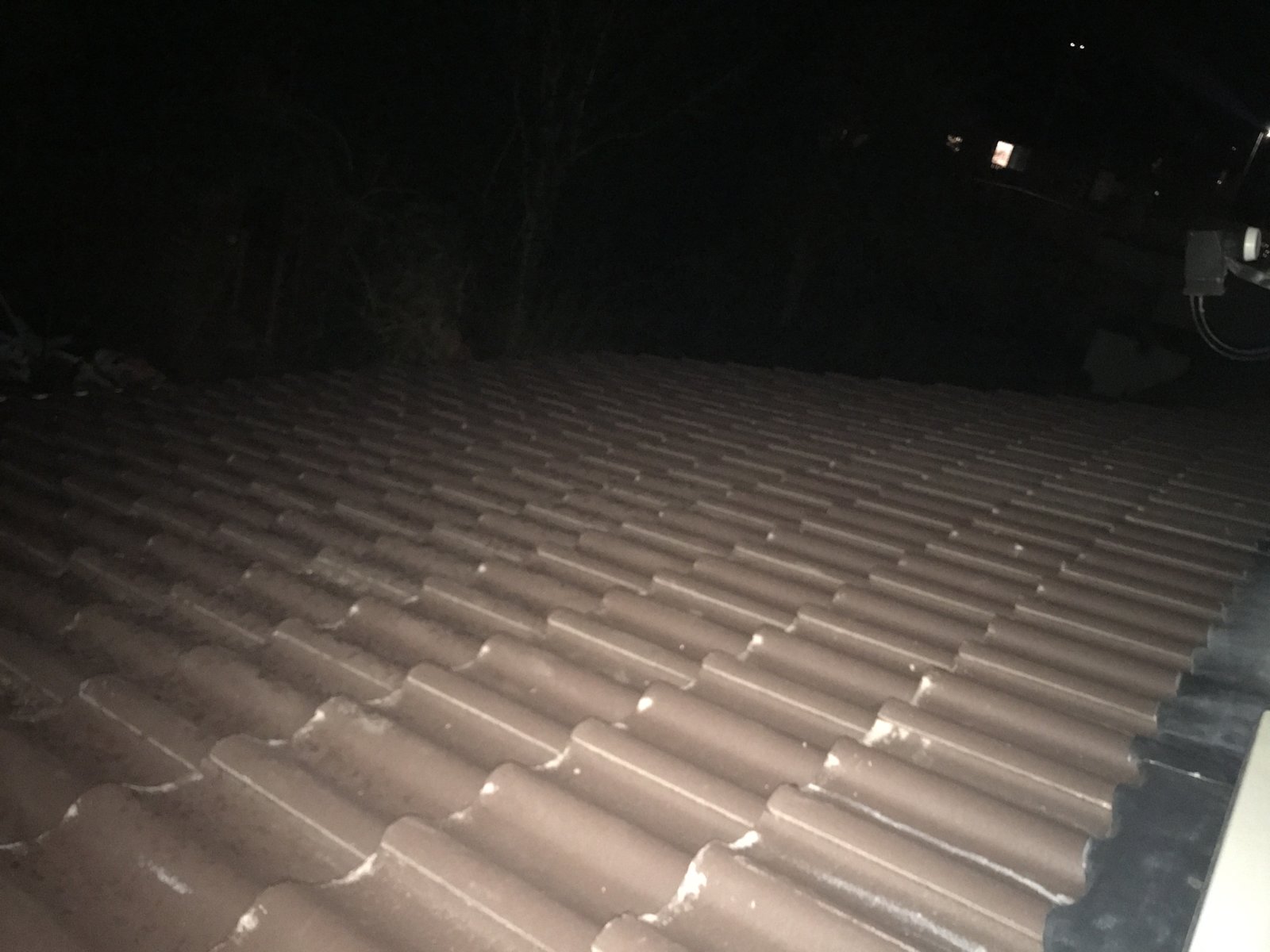

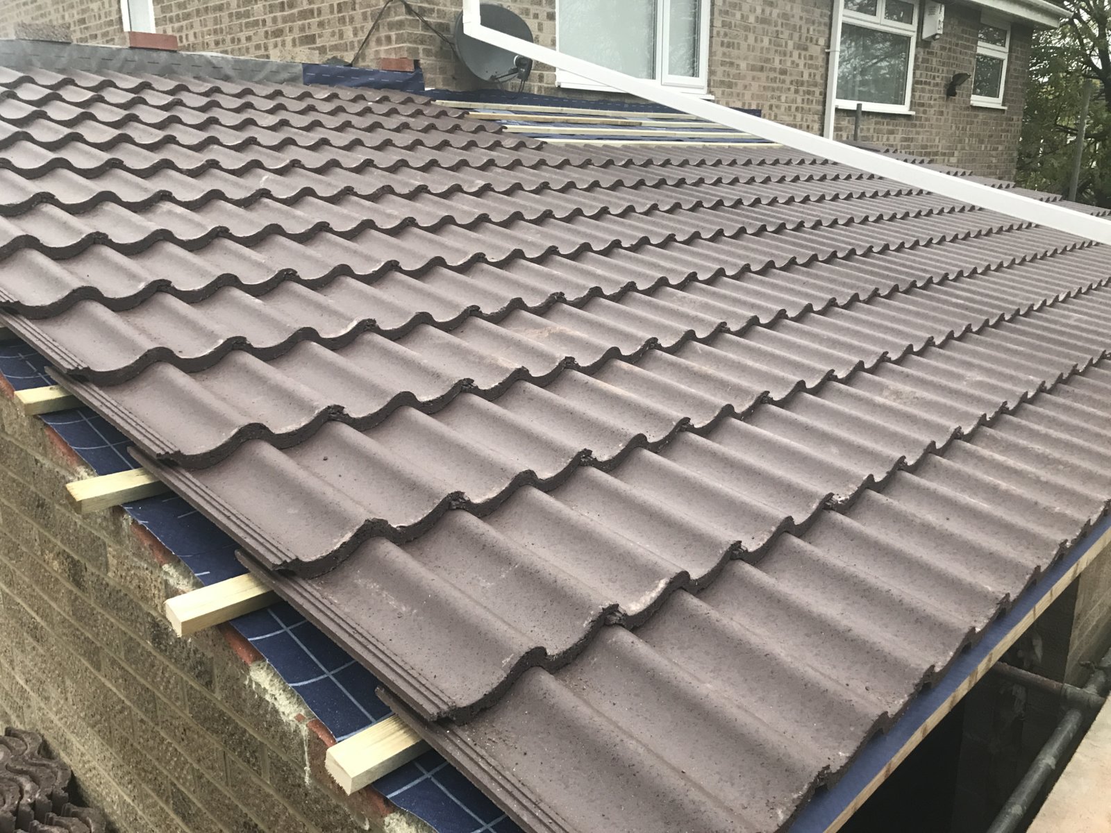

Could possibly be the dreaded incorrect choice of tiles, what's the pitch and what are the tiles and what is the lap? And as mentioned photos and move to roofing.
The roofing works were carried out by a company not myself, the pitch of the roof is 15' with a Marley Mendip tile this was the highest pitch we could get on the roof due to existing window, 100mm headlap on the tiles.

The headlap under the tiles should be 100mm on 15 degrees, but it doesn't look that much. You've got a membrane under the tiles, and the waters obviously getting under the tiles, and then coming through the batten nails. Have a look at this, and see if the procedures were followed.
Yes all flashings are in place everything has been completed, just awaiting decoration internally, will get up tonight and check the headlap is correct
Regardless of headlap, the membrane should deal with any rain that gets under the tiles.
Kick some tiles up directly above those damp marks.
"After heavy rain" almost always means water penetration. But another possibility is the cooling effect which can create a cold surface internally for condensation

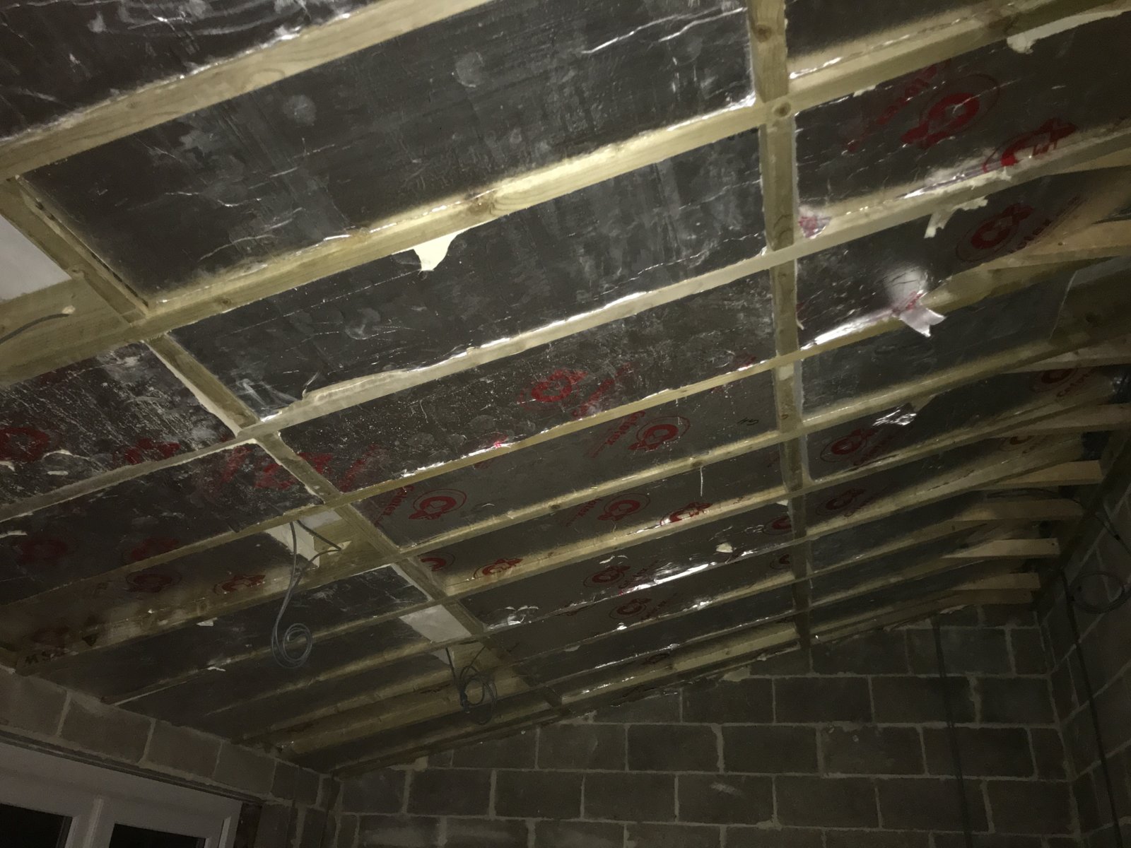

If there is an air gap between the insulation and membrane then condensation could form there. Is there eaves and ridge/abutment ventilation?

was a vapour barrier used? is the radiator on that wall?
Looks like the wet patches are on the plaster board joints. Water might be getting in anywhere above the wet patches and flowing over the top side of the boards till it finds those joints. I’d be investigating high up on the roof first.
Thanks for all the comments and advice I will get some pictures in the light tomorrow of the flashings at the top, there is no radiator on any walls yet
Was the membrane draped between the rafters to provide a channel for water to run away from the nail holes or did it get pulled tight?
