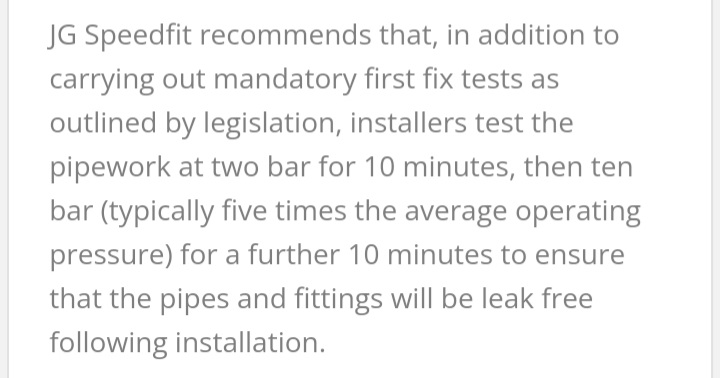

Hi,
I'm just a DIY'er, so I may be wrong! :)
But, I have found this recommendation from JG:
Link here:
https://probuildermag.co.uk/features/john-guest-testing-pipework-part-four
It's maybe possible that you slightly overdid it, just a little bit! ;)
10 bar testing of a copper/push fit system isn't really needed. That is more so for a fully plastic system. It allows correct testing of the seals against the plastic pipe and also helps to bed the grab rings into the softer plastic. Also the high range pipe testing would normally only be performed on plastic pipe runs that are then capped off. You wouldn't normally have any connected outlets etc and test to 10bar, you would probably be reaching or over-reaching their maximum limits and any pipe to outlet seals.
Copper is slightly different whereby the grab ring is less liable to slip on the hard pipe once fitted. I would test at 1.5>2 times standing pressure on a mixed system.
