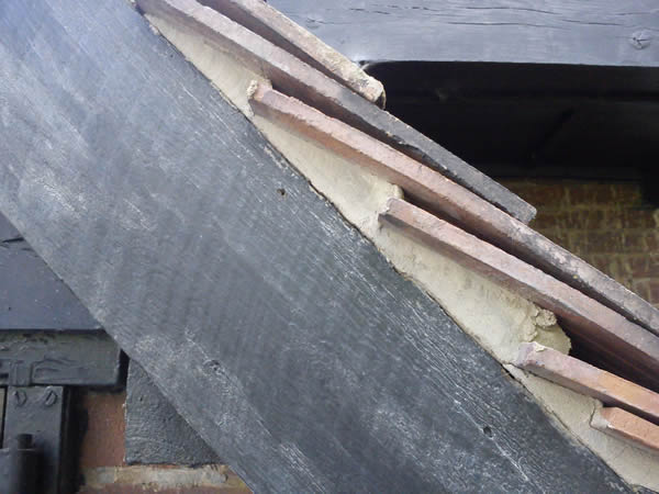

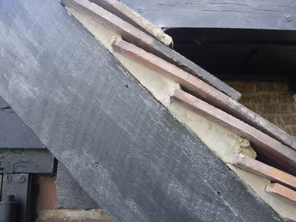

I'm still confused, if they were just tiles surely you would infill like this with just a trowel needed?
Like that, but slightly over hanging the brick wall, so it was originally flaunched, and that had broken up, and fallen away over the years. It needed redoing, and I'm hopeless at judging it by eye, so I made a guide frame/form up, from two lengths of angle iron.
My first idea for a form, was to fix timber battons, all the way along, but then I thought better of it, and made up the angle frame - which worked better than I'd imagined.
If you mean adding mortar underneath the tiles in an upside down type of sloping flaunching, or in your case a rectangular blob of flaunch, can't say I have ever seen such a detail, neatest thing would be the flaunch to the underside of roof tiles before roofing felt was invented.
I don't know the explanation of why it was originally flounched, but looking up, in my loft, I only saw the bare timber battens, and the underside of the tiles - which had very crumbly cement added to the underside. As that roof edge was very exposed, and the flouncing was breaking up, I thought it worthwhile ordering scaff., getting up there, and reflounching it.
