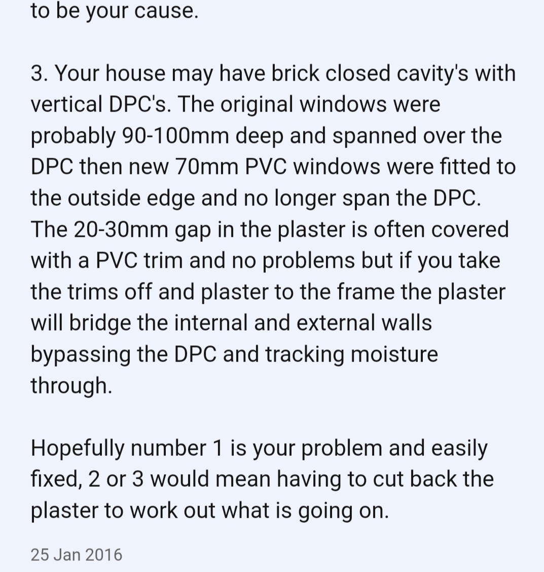

Am I right in thinking the gap that has been bridged is the reason for this? And I'll now need to cut the plaster back again and put a trim on?
I saw a post from 2016 which suggests just that:

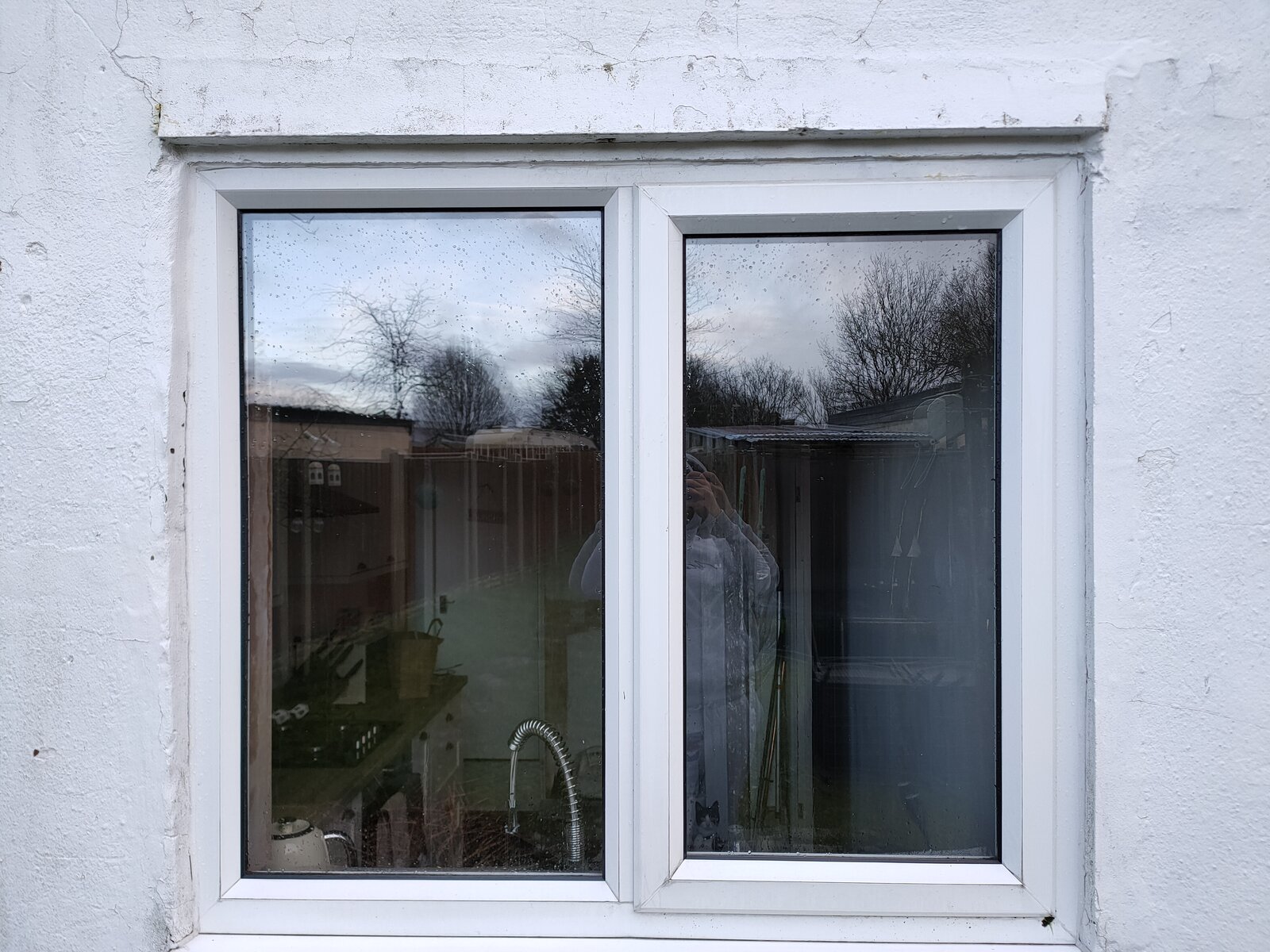

Photos of the outside please
Will give clues on how the rain is getting in.
What I have just noticed is this.
The frames were resealed last year and the opening window adjusted because there was a draught coming through. We had no problems since then. This only started just after it was plastered, the first sign of rain since it dried out and it ended up similar to how it is now. The back of the house does take a battering when weathers bad
