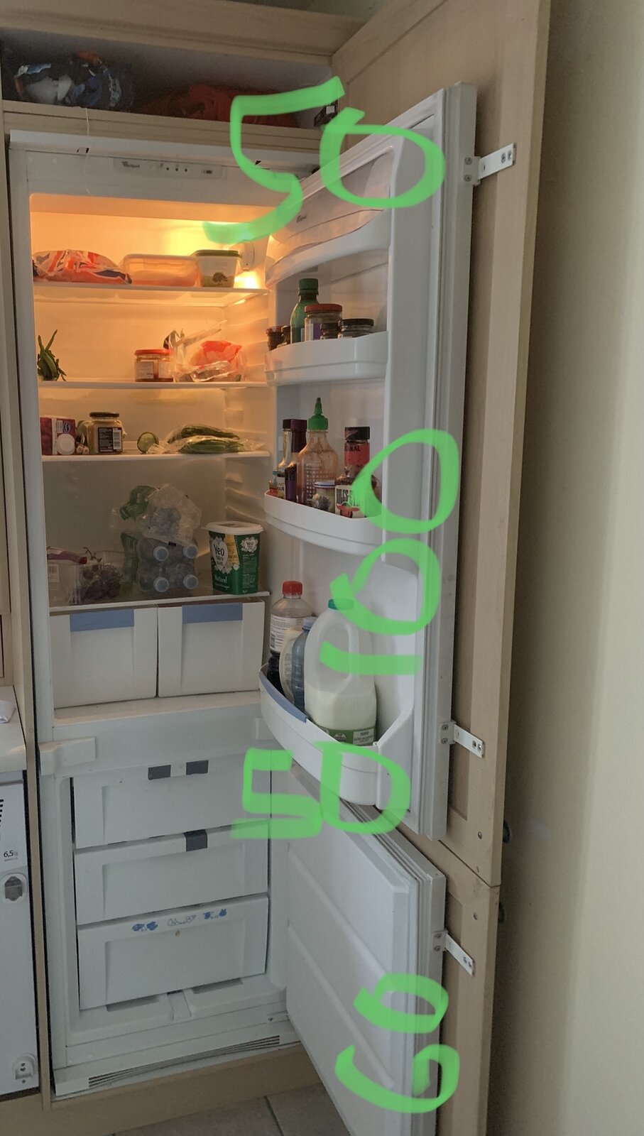

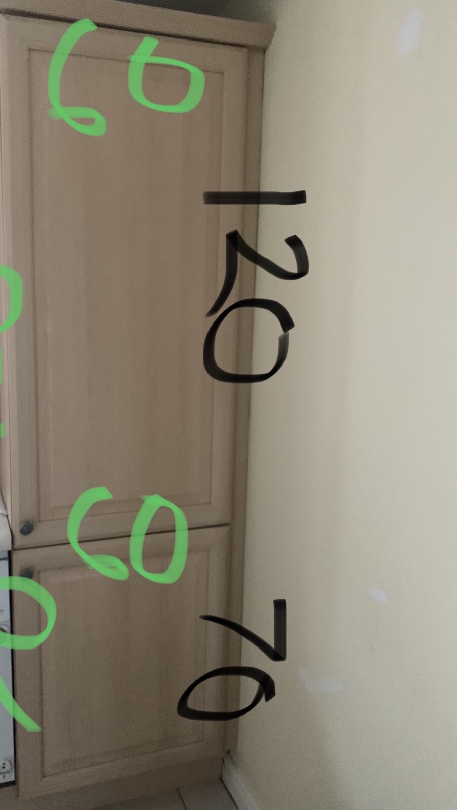

I need to replace an old whirlpool integrated fridge freezer.
But I’m struggling to work out the split (70/30 or 60/40).
It’s definitely not 50/50. However, the measurements don't seem exactly either of the above, either.
It seems nearer 70/30. But I’d like to check to be sure first.
It is a whirlpool art 469GR.
If your measurements are right:
60cm for the freezer
100cm for the fridge
then each cm equals 0.625% of the total of 160cm
So the Fridge is 62.5% of the total height of both (100 x 0.625)
The freezer is 37.5% of the total height of both. (60 x 0.625)
Closer to a 60%/40% split
If the specs on the Amazon link below are correct, the freezer is 81/281 (28.8%) and the fridge is 200/281 (71.2%) of the gross capacity.
And the freezer is 65/263 (24.7%) and the fridge is 198/263 (75.3%) of the net capacity.
