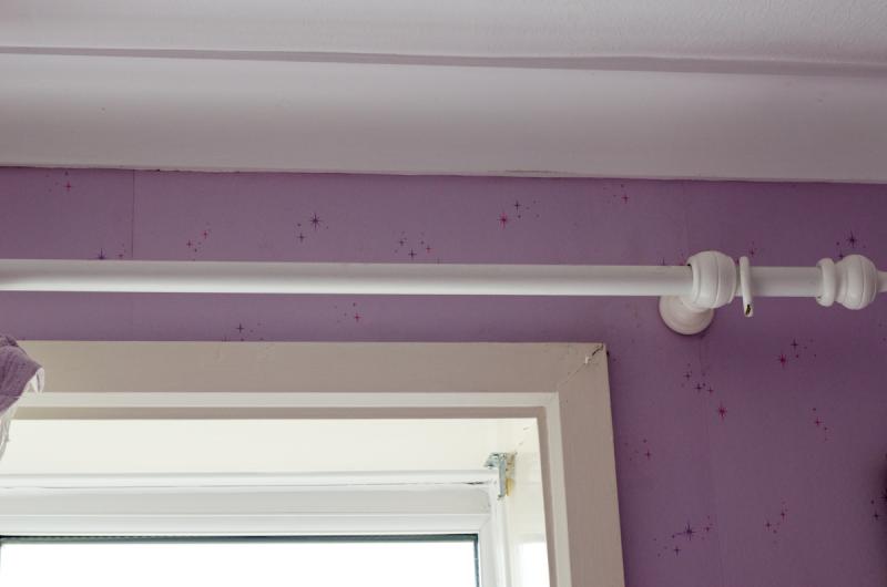

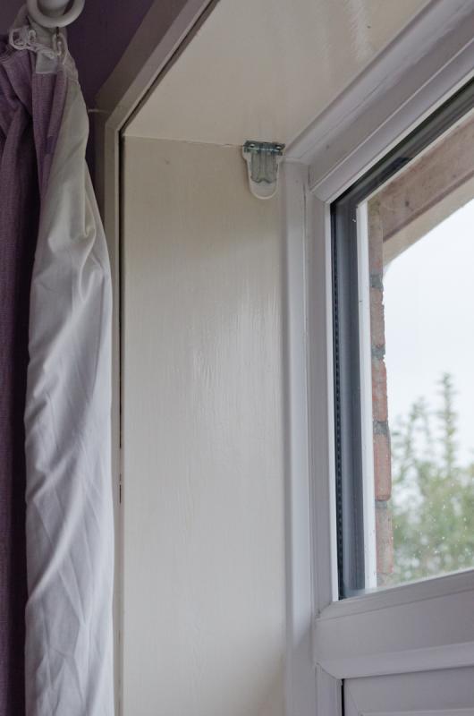

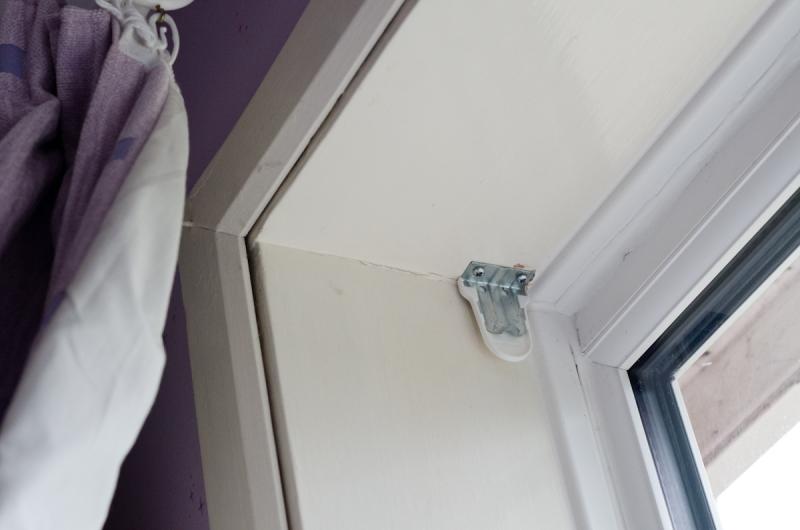

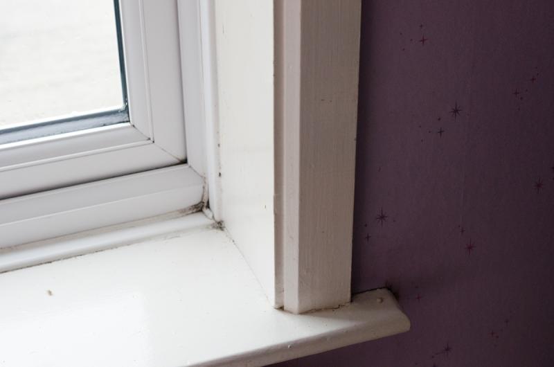

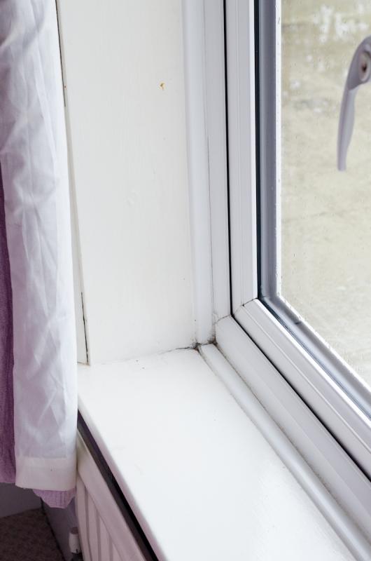

My house is a 1927 brick and block construction with cavity.
The photos show an upstairs window in one of the bedrooms. I'm thinking of removing the wooden surround (which as far as I know is original) for the following reasons: It's drafty around the edges, it's a pain to maintain. I also have a problem with a loose brick soldier course (non-structural) above this window which I think may be easier to resolve without this surround in place (the soffit restricts access from the outside.)
Anyone seen similar and can tell me what's likely to be behind it and what problems I should look out for?
My biggest concern is not knowing what's supporting the block work above the window. What would they have used back then? I'm assuming not just this wooden frame, though the roof load is carried by a beam sitting on top of the blocks, so the surround could feasibly could be supporting the blocks above the window??? I can see no sign of a lintel outside (hence why the soldier course is loose.)
I'm assuming that behind the wood will be bare blockwork, exposed cavity (so the polystyrene ball insulation may fall out)
Could the loose soldier course, or even worse the blockwork come crashing down?
...any info from someone with experience very much appreciated!
As a follow-up how would I go about making good the opening after removing the woodwork, with insulation being a key priority? I'm thinking foam fill the cavities, dab on insulated plasterboard (or celotex) ?
