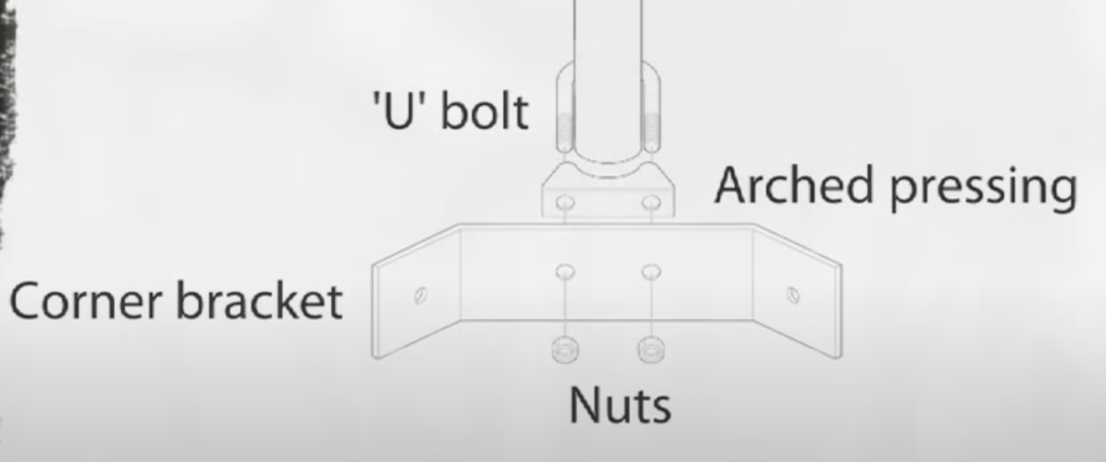

What are these fittings for polytunnel called and where do I find them?
9 Jan 2020
776
28
Watching this handy video:
THere are a few fittings he uses which I cannot find anywhere. All I get are regular U-bolts:
I cannot find that rounded "arched pressing" to grip the tube onto the U-bolt, or a corner bracket of that style. He mentions "U clamps" I can't find either.

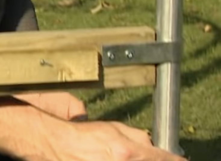

Even this simple u-bracket thing that wraps around a pole I can't find:

Exhaust clamp, scaffold clamps if it's 48/50mm tube, kee klamp.
Some parts will be custom made.
For the U shaped strap in the last pic, just bend a bit of steel, or galvanised banding.
Contact polytunell suppliers, they will have some of these items, depends what diameter your tubing is.

Maybe that's it. I was sure I've seen them before - maybe I'll ask my local steelwork place who do tube-clamp stuff.
