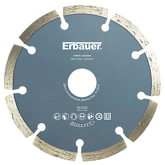

Hi, Best blade I bought for my angle grinder was a diamond cutter for stone/bricks/pavers etc. Been in use for a year or two and still cuts like new. Can't remember what brand it was, but similar to the one below:
Erbauer Masonry/Stone Segmented Diamond Cutting Blade 125 x 22.2mm | Diamond Segmented Blades | Screwfix.com

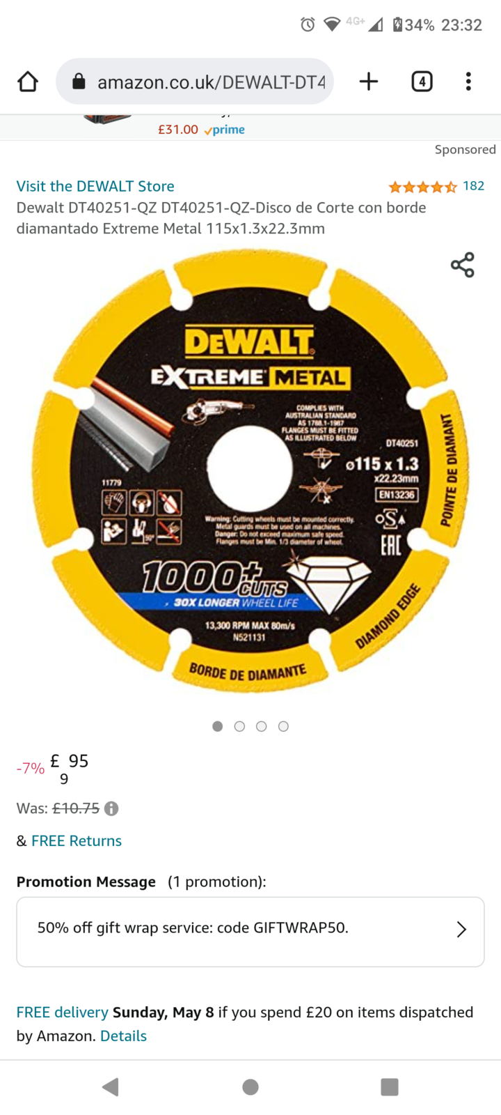

I would recommend these for cutting metal:
The main advantage is that the diameter of the blade (which determines the depth of cut) stays pretty much the same throughout the life of the blade.
I'm with tricky-dicky, I've had the large version of that erbauer jobby in both my grinders for the last couple of years, it's cut block paving, lintels, stone, blah blah blah.
Normally I'd buy Bosch, but these are long lasting.
