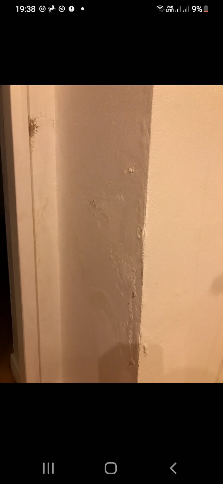

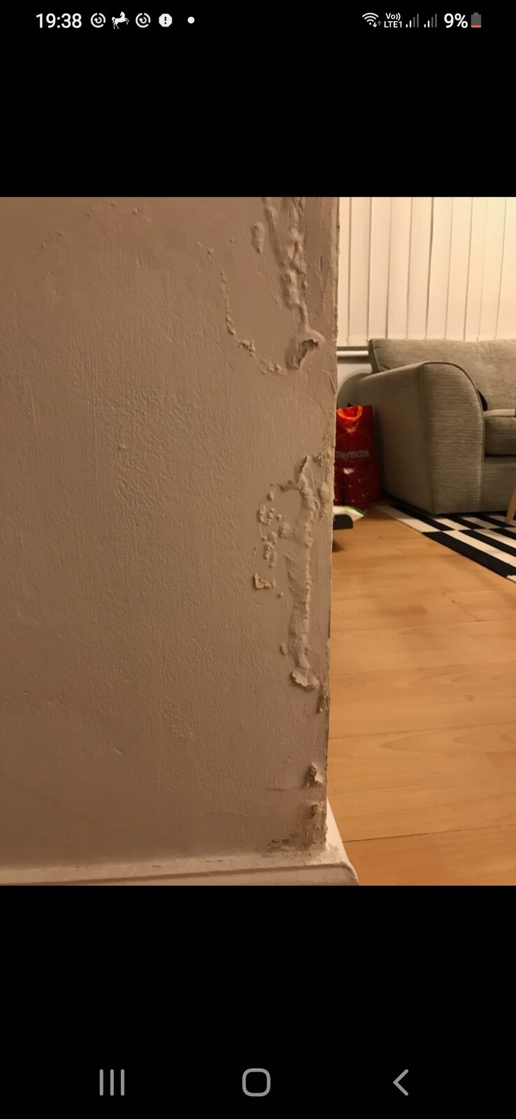

The paint on this side of the chimney breast keeps bubbling up.
What can I do to remedy that please ?

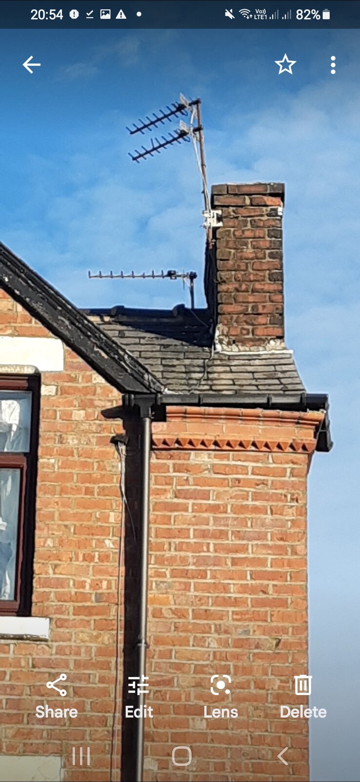

The damage you see is likely to be quite old , it can take several months for the salts to be washed thru and many more for it to subside. Most likely ingress is at roof/ chimney level , have that checked first . Any exterior photos of that area? What is the property type?

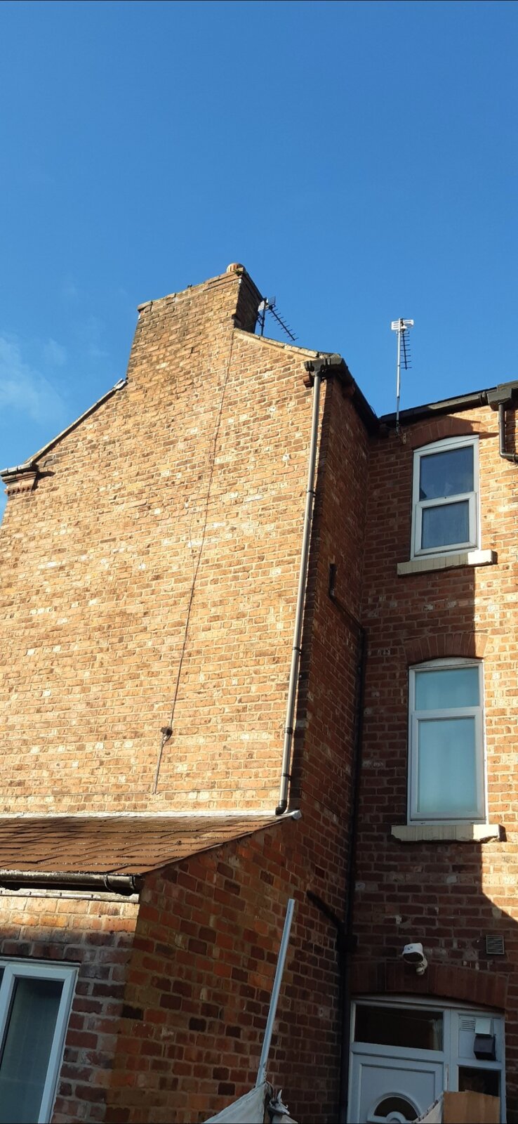

There are 3 air bricks at the top of the wall
Also I'm not sure if the concrete round that area has been built too high ?

7. The dirty brickwork below the stack is due to the failing stack, and its flaunching allowing moisture into the wall and the flues - damp sooty chemicals have penetrated the wall.
8. The damage to the c/breast in your living room: is caused by hygroscopic chemicals penetrating the walls of the c/breast, & possibly by rising damp - a pic of the front of your c/breast and any hearth would help.
9. Typically, hack off all plaster to 300mm to 500mm above the last signs of damage.
10. Render with a 3:1 mix of sand & lime & limelite skim finish.
11. Replace the skirtings, & the rusted angle beads with plastic angle beads.
12. sweep the flues.
13. Ventilate the flue.
14. For any of this to be successful its necessary to remedy the items at the stack and rear wall.

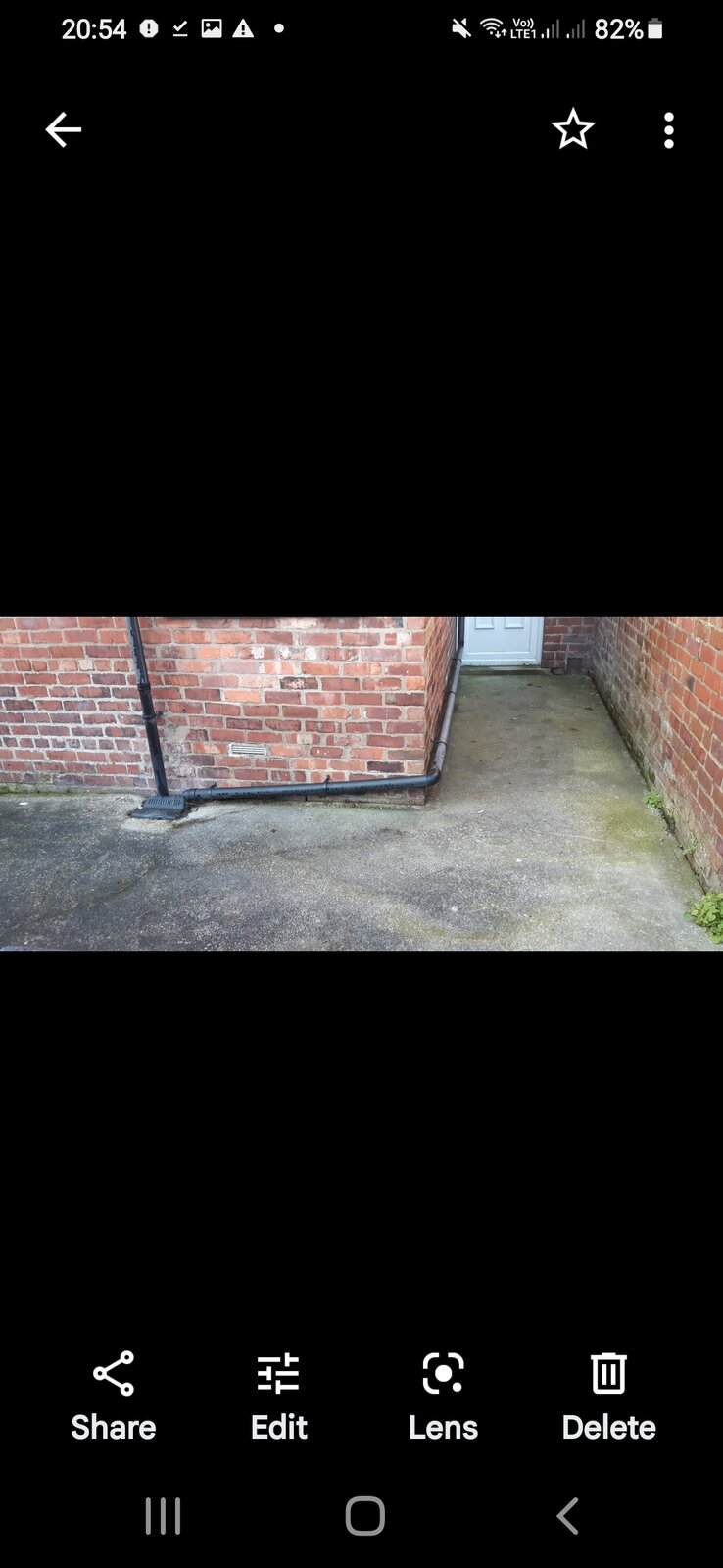

10. There are a number of other problems beyond & outside your flat - eg concrete levels.

There are 3 air bricks right at the top of the chimney wall, I am not sure that's causing the problem.
I have had some work on the flaunching some time ago, not sure if it needs doing again without getting someone up there.

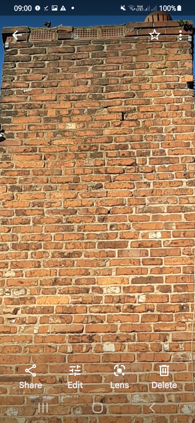

I cant see the three air bricks - can you point them out on a pic? They, wherever they are, are not the cause of your problems.

The stack is the part of the chimney breast that sticks up above the roof.
Your stack at the least needs re-pointing, new flaunching and new lead flashing in place of the mix of lead and mortar fillets it has at the moment.
At best, the stack needs rebuilding.
The blackened brickwork & mortar beds below the stack is degrading.
Concrete levels: do any of your rear rooms have any solid floors? Do you have damp interior lower walls - a pic of the side wall in the yard might help?

Thanks for that pic of the air bricks - for a proper job you should (you have to) get cracking with work on the stack. Best would be to rebuild it.
I'm corrected, I was searching the lower walls for the a/b's.
The 3 a/b's might possibly
be letting rainwater into the flues but in the scale of things up there they are almost irrelevant.
