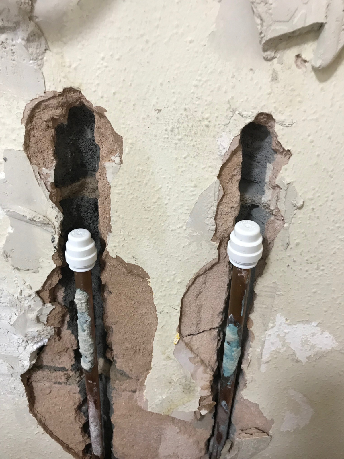

Hi all,
i am in the process of taking out copper pipes from an old shower from our wall, what should i use to fill the big holes
i will be shortening the pipes please see PIC
Backing plaster like bonding/browning/hardwall. But the pipes will need protection as it corrodes copper. What’s the desired finish, paint? Tiles? What’s happening with the pipes?
