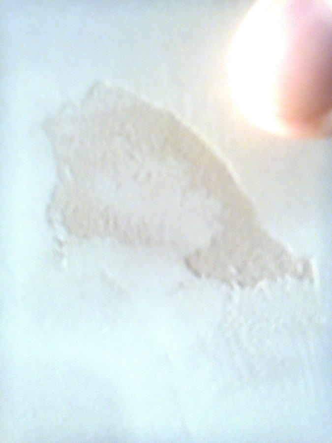

I'm diy, this is my first attempt at skimming onto plasterboard.
I've skimmed 3 small walls and one small ceiling, everything has gone well EXCEPT once the plaster has dried out there are around a dozen shallow hollows on each wall.
Is there a technique to ensure these shallow hollows don't occur? I can't actually see the hollows when I'm at the flattening and polishing stages!
Everything else about the job is good so far - no ridges/trowel marks - just very slow progress due to inexperience.
Any advice much appreciated.

It's all about practice Roman,,, you've got the right idea. Just out of interest, any chance of a pic of the problem "hollows"?
Yes absolutely more practice the better. After the second wet trowel step I stood back and couldn't see these hollows (or are they known in the trade as holes?), maybe because the plaster was dark from the water that's gone over it. Once it's fully dried out pink they become visible.

Worked out a few things I've been doing wrong...
1) Excessive trowelling when applying first and second coat - the extra strokes on the wet plaster caused more imperfections (usually hollows) than they fixed!
2) Once coat 2 gone tacky, trowel it with a dry trowel - no water used at this stage.
3) When doing dry trowel on coat 2, use more force/pressure - this seems to really iron out the imperfections.
4) Have a 500 watt site light handy to get better visibility of imperfections.
After the dry trowel I waited 15/20 mins then trowelled (polished?) with the trowel wetted. Looked good so left it at that. Will give it a few days to dry pink and re-inspect, but could see straight away it's a far better finish.
