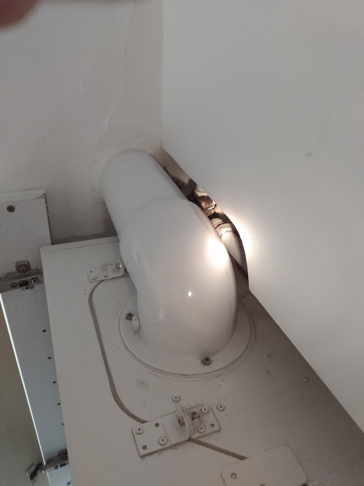

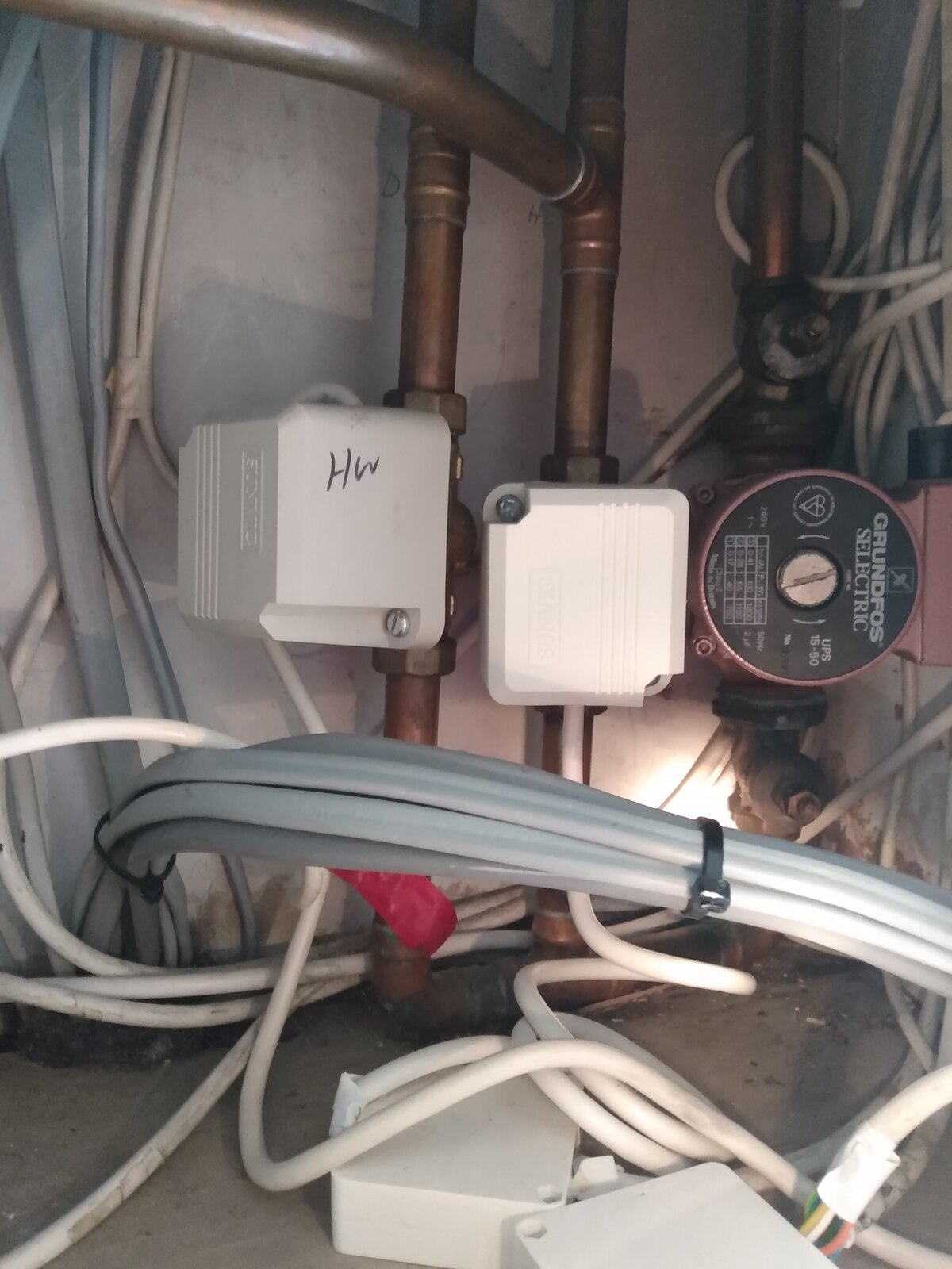

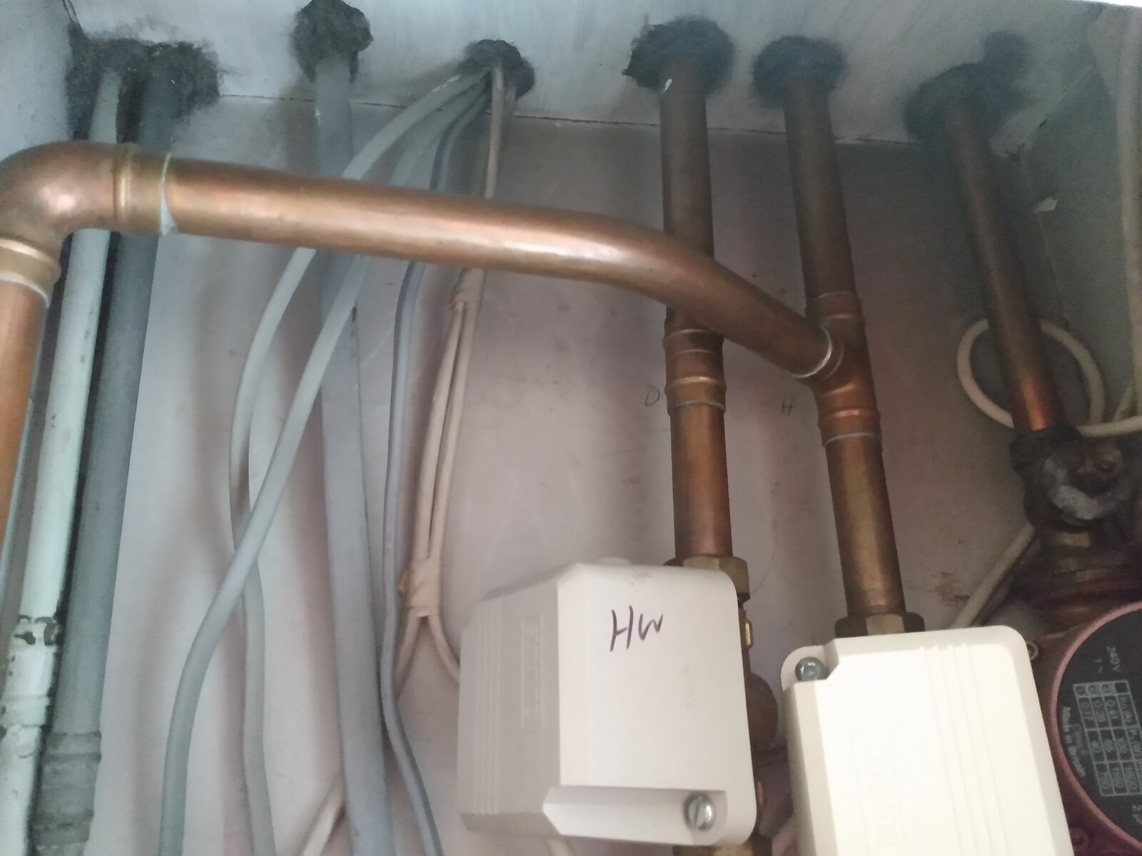

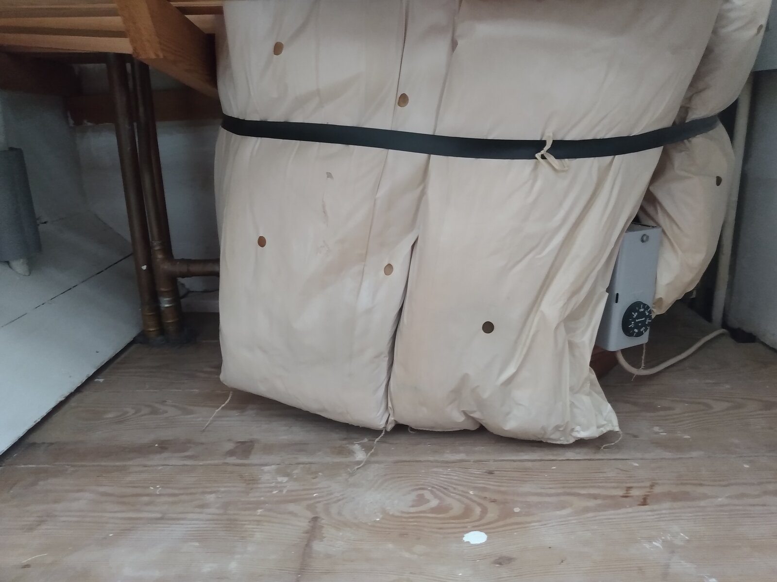

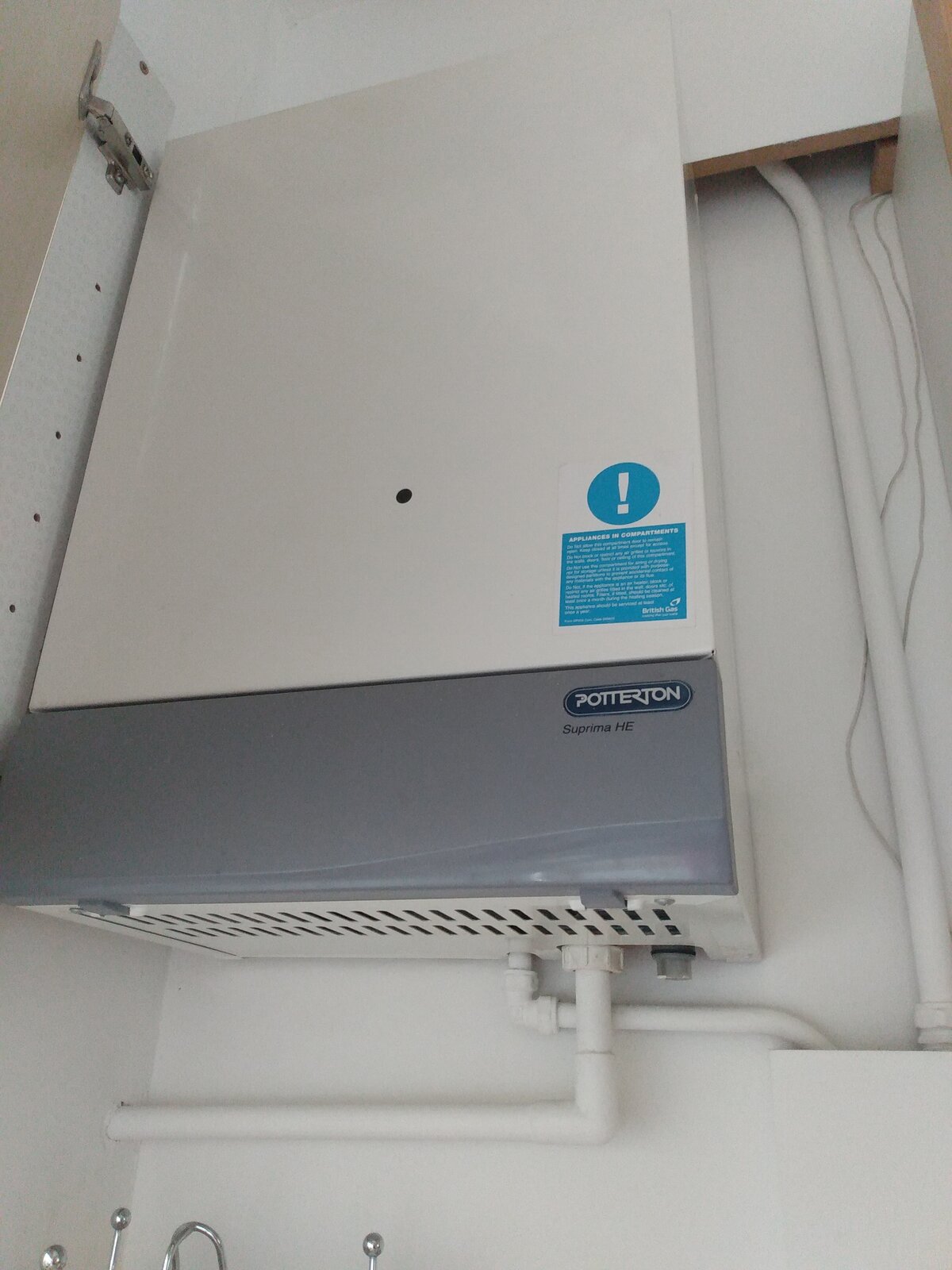

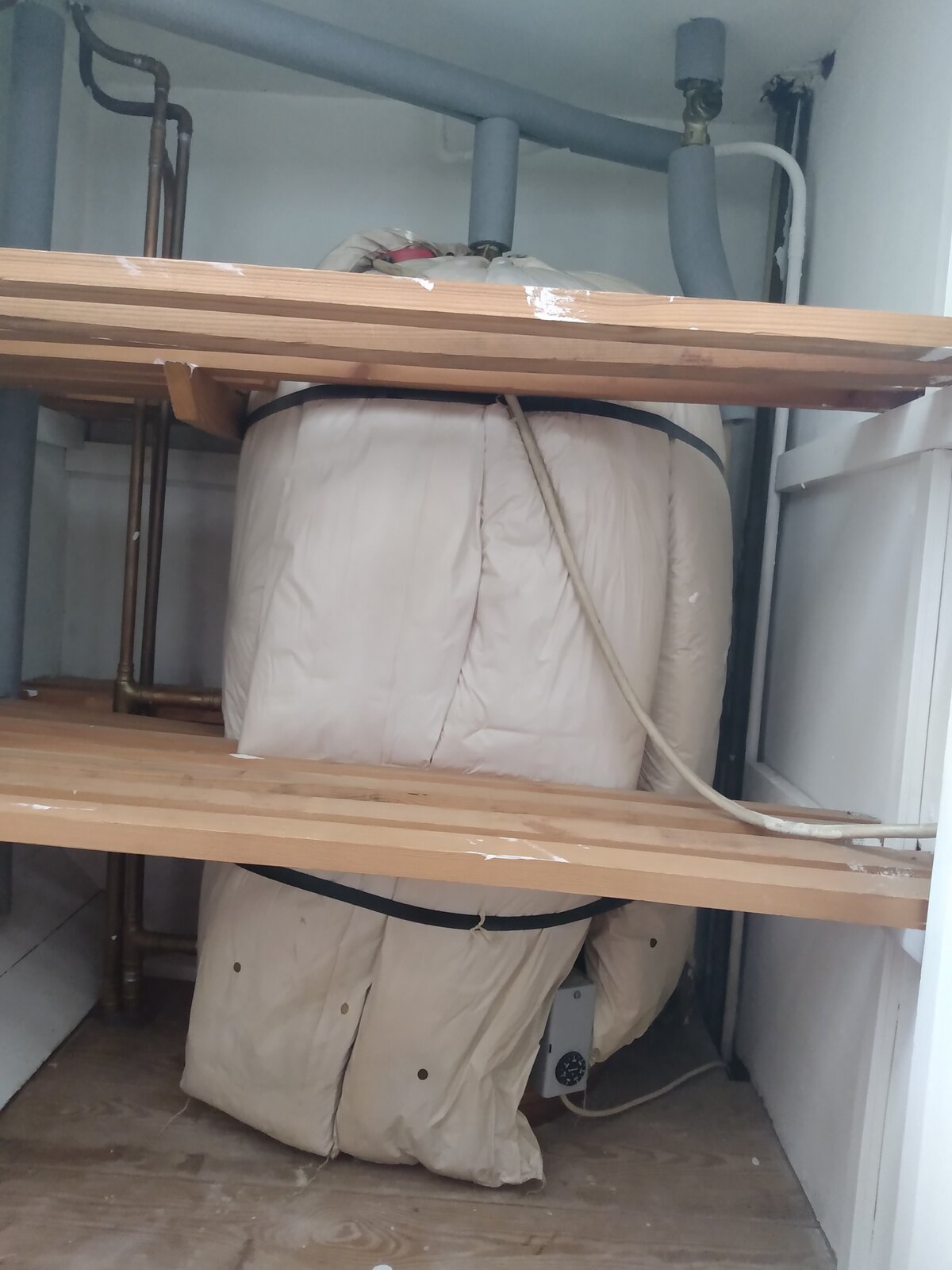

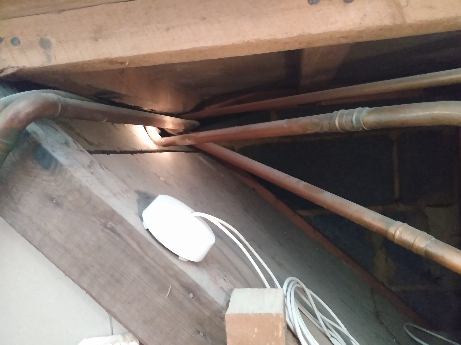

I have put photos in showing the boiler, motor
ised valves, airing cupboard and the pipes going upwards into the two water tanks above, 1 small and 1 large in the loft

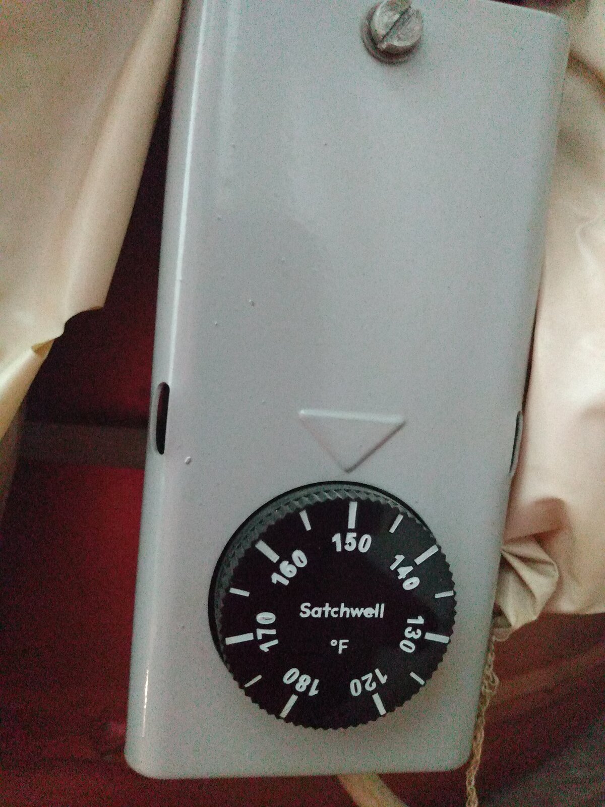

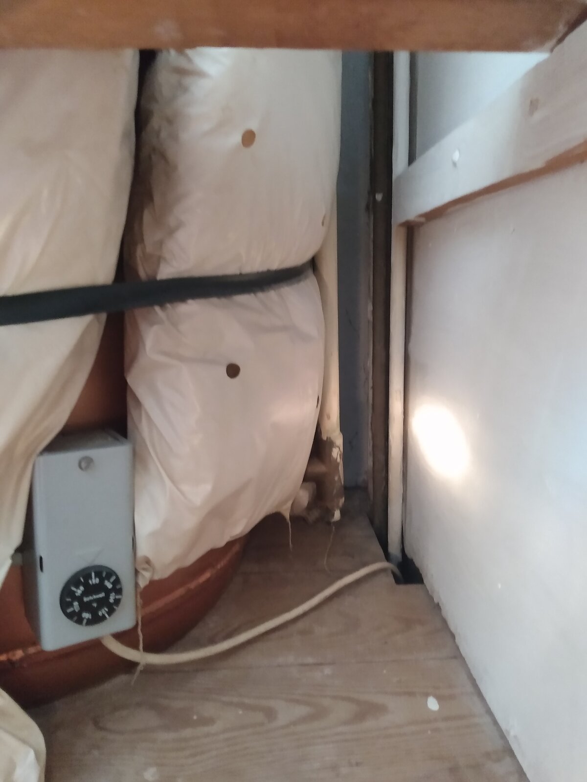

If the HW is too hot, either the thermostat is busted (the grey Satchwell box with the black dial on it), or it's been wired incorrectly somewhere.
I have an issue where the boiler is turning off before my CH is getting up to the required set thermostat temperature and just turns off and on randomly
Unrelated to any Hive settings. There are various other things that could cause that such as a defective zone valve, poor circulation due to blockage, circulator not working properly, and so on.
Given the shoddy wiring mess, incorrect installation is also probable.
If the hot water is too hot - the cylinder thermostat (grey satchwell) is far too low positioned.

Re. The grey satchwell, could I turn the dial down to reduce the water temperature or is that not advisable?

It's a pumped system.

The hot water from your taps is gravity - the pressure is only there because of the large cold water storage tank in the loft. However this is unrelated to the boiler and the controls for it.
You are getting the completely wrong advice from some users , you have a fully pumped system, it may be gravity fed, GRAVITY HOT WATER, and gravity fed are not the same thing, they are completely different, you CAN NOT have a HW cylinder below a boiler on a GRAVITY HOT WATER SYSTEM, gravity fed system is the wrong term it is an open vented system , Gravity HW is a completely different thing, you need to set your hive to fully pumped not gravity
I'm sorry but I'm so confused. I presume I have a fully pumped gravity fed system then ?If it's a gravity system should I have left my Hive receiver on the blue setting for a gravity fed system. Someone said earlier it wasn't so I changed it.
It is confusing when you get conflicting responses. You have a pumped central heating system which can be either pressurised or open vented (some say this is gravity fed but it isnt). Your system is pumped and if you have a small tank in the loft feeding it then it is open vented but if no tank exists it is pressurised.
