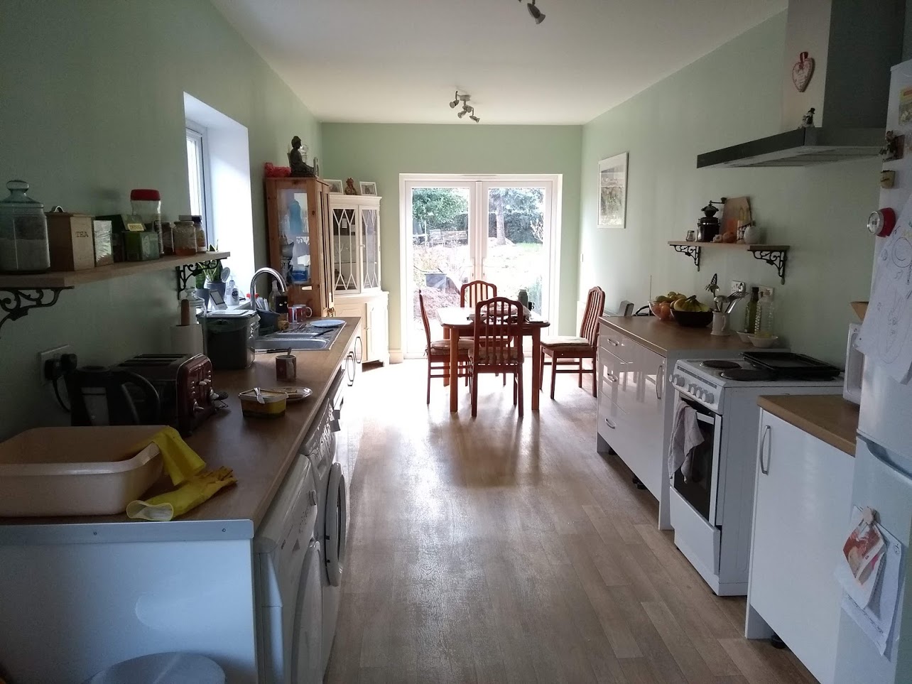

Your prices are more best case scenario. Expect things like rotten joists, lack of insulation, doors and casings replacement, smoke alarms, extractor fans (ducting etc), dodgy uninsulated floors, crap SVP's and drainage, Artex ceiling replacement, lack of escape windows blah blah.
You could easily stick another couple of grand on each of those prices for worst case.
Basic kitchen is about right.
My kitchen was about £2780, that included
units, sink + installation £2000
extractor fan £130
worktops £150
flooring £500
electrics and plumbing were done at time of extension, but probably about £1000 on top if separate. That's gas pipe for cooker, radiator, hot and cold, outdoor tap.
If you are buying new white goods then obviously the price will go up a fair amount, and built in units cost more than free standing.
