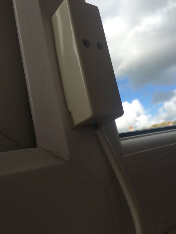

The panel is a Honeywell ADE Gen4 i believe.
So for the past 3 weeks we've actually been setting the alarm when we leave the house & also go to bed at night. Everything has been fine.
The front door, side door & bathroom window are on those magnetic contacts.
The back bedroom window is on some kind of vibrate sensor
The living room & diner are on motion detector sensors.
I armed the alarm around 11pm last night. At 12:50am this morning the alarm is sounding off.
Shoot out of bed to knock it off & can see it's zone 5 that has tripped ............ the back bedroom with the vibrate sensor.

Are you100% sure shock sensor on zone 5 and not a movement sensor
Check all items one by one to make sure what is on each zone
It's a rectangular sensor on the window. Totally different to the PIR sensors in the living room & diner.
When the bloke installed the new PIRs downstairs he tested out the vibrate sensor & it took a fair old whack to set it off according to my wife.
It wasn't renewed at the time so no idea of its age.
Tap the window frame with, say, a screwdriver handle to see when the Viper triggers. It shouldn't trigger without a pretty sharp tap on the far side of the frame. (There is a special, calibrated tool for this but use your best judgement!) If it triggers with the lightest tap or scrape, you need to adjust the sensitivity.
Google some images of vibration sensors to find out which one you've got. It sounds like a Viper GL which is adjusted with a little trimmer pot inside. When you take the cover off, you'll get a tamper...
You may find that the window "creaked" with the temperature change or got hit by a bird/bat. A thunderclap will set them off, too.

This is the sensor
We did as the installation fella said & armed the alarm Weds night & Thurs night as i was off work on Friday & if it went off again i was to give him a call Friday for him to come out.
It didn't go off. Didn't go off Friday night either.
So i can only assume as he & you said - a bird / bat / temperature change or whatever.
Looking at the state of the shock sensor (cracked & wiring exposed) might be worth rewiring it.
