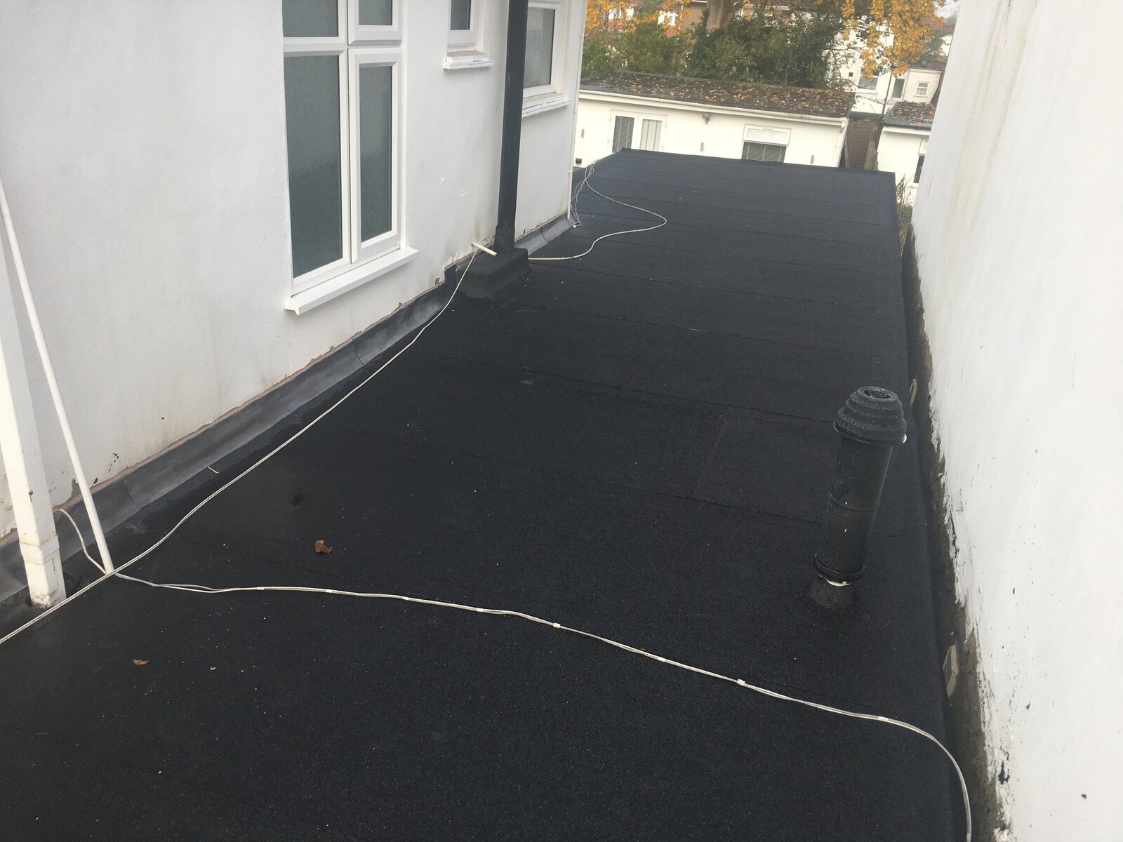

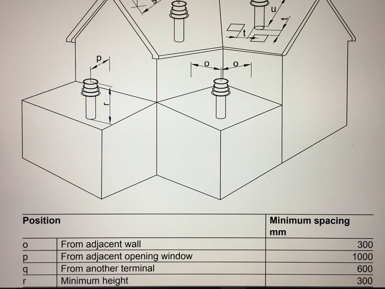

Hi I’m thinking of getting a new veismann boiler what distance should the vertical flue be Fromm an adjacent wall? Is it 500mm or 300mm Any help would be great thanks, the boiler installer says 600mm but instructions say 300mm dunno I am confused
It's 300mm as per instructions. What's wrong with your existing boiler?
It’s 300 the boiler surveyer said it’s 600 and wanted me to uplift the felt and reposition flue, I’ve just hd the new felt roof done! Hence important the distance is correct thanks I’ll have to email them,
