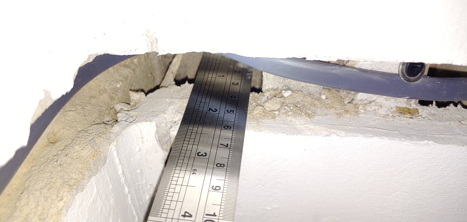

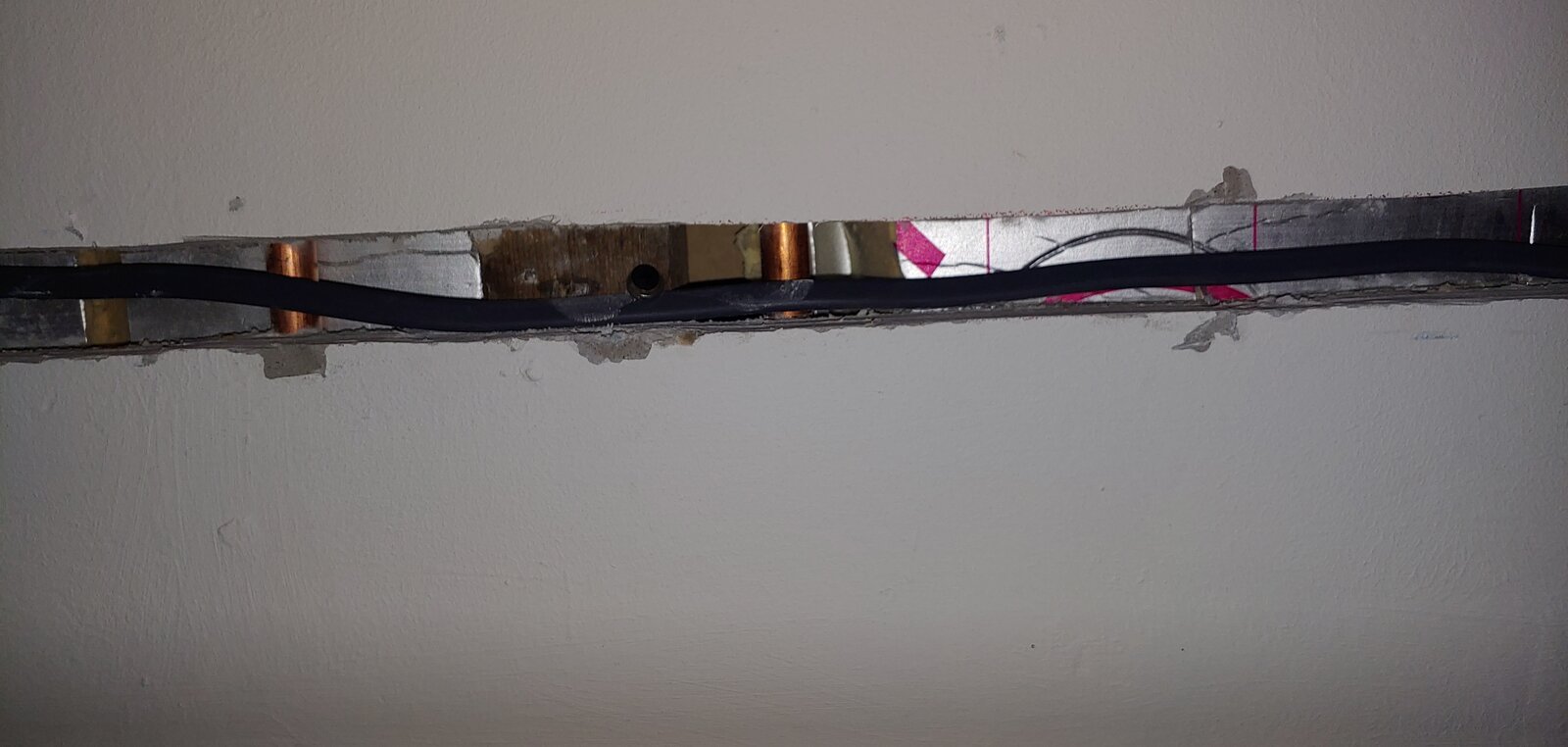

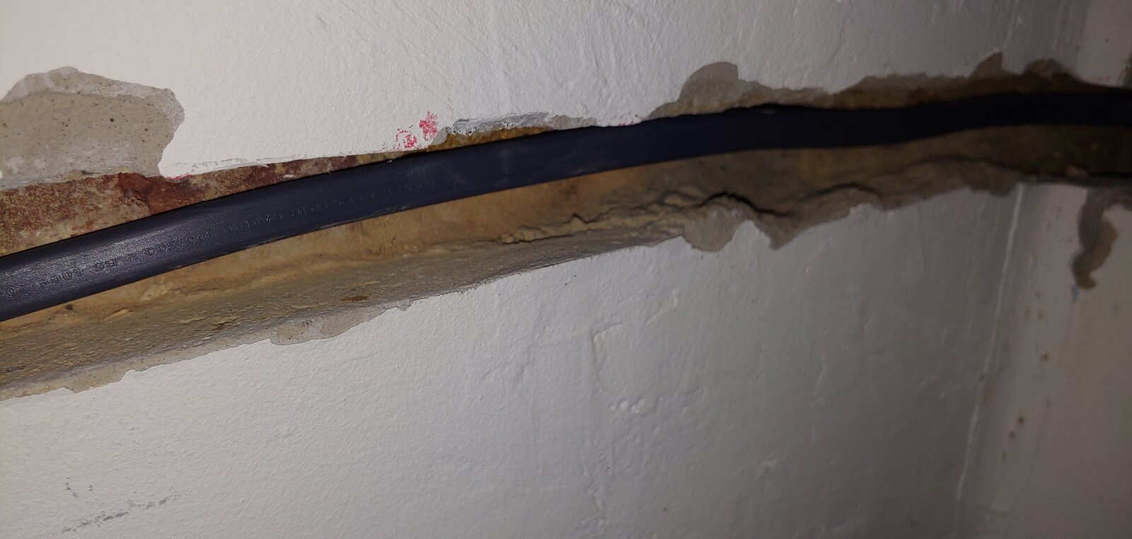

Hi there,
I've decided to fill in the chases myself after I hired an electrician to install additional sockets in two rooms which are located on the first floor of a semi detached house.
My original plan was to fill in the chasing with Thistle Bonding and then finish with 2 thin coats of Gyproc Easifill.
Before embarking on this task, I decided to look at the substrate behind the chasing and I can see a bricks. Im reticent to start, as I'm sure I read somewhere that if the internal wall is backing on to an external wall then I need to use cement instead of Bonding.
Second of all, I can see a massive gap at the corner of the wall, where the long section meets the short section of the wall. Also I can see copper pipes at the back of the chase on the short section of the wall. The bathroom is on the other side of the wall.
My questions are:
1) Is Thistle Bonding the correct product to use, where the other side of the wall is external?
2) How do I fill in the large gap at the back, to simply stop the bonding from simply falling away into the gap?
3) Do I need to approach filling in the chase differently if there are copper pipes at the rear of the chase?
Many thanks

Image 1 and 2 look fine for a plaster base, image 3 looks like it is plasterboard.
TBH, I don't know how well plaster would stick to the foil backed celotex. I wouldn't want to use bonding directly over cold pipes, I have seen them create condensation in the plaster. I guess you could glue some plasterboard in place and fill over the top.
That was a rough electrician you hired.
Aside from not putting the cables in conduit (there is no requirement for this I should stress) like proper electricians do, he has wrecked that plasterboard wall in picture 3.
As regards picture 3, he SHOULD have only cut into the plasterboard where the wooden studs are, and fished the cable from the hollow sections of plasterboard.
I see no way of simply 'filling' that chase in picture 3 with filler or plaster. You could try expanding foam, but please don't - it would be the ultimate bodge up ever. It will crack very, very quickly.
It needs a plasterboard strip fixing in with screws, but I think you will need to make the chase at least four inches wide, so you can screw a four inch strip of board to the wooden studs, avoiding the cable.
You will need to notch the cable into studs ideally - or leave some notches in the plasterboard strip and fill after.

I am a little concerned about the cable being in direct contact with the pipes (if they are hot). If he had dug away some of the celotex, it might have been possible to run the cables behind the pipes and add a little wadding to act as heat insulation.
Perhaps you should post the last photo to the electrics sub forum.
As per @sparkwright 's post, the current path of the cable may prevent you from fitting a section of plasterboard in image 3. For the record, I have filled those kind of chases with expanding foam before but you need to carefully remove enough to be able to fill over the top. I use the likes of Toupret Redlite or Red Devil Onetime over the foam. Cracking isn't an issue but if someone pushes their finger in, it will leave an indentation.
