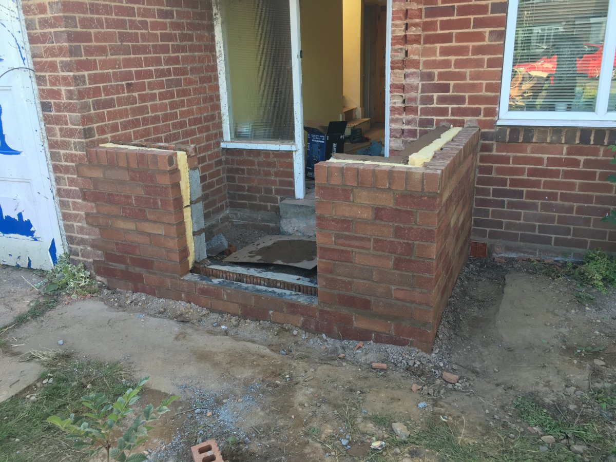

Had a porch being built.
What do you think of the quality of this brick work done by my Bricky?
You will notice it matches back wall better then it does to wall it's toothed into(as this was used to have ivy which means it weathered less) but I'm sure I can arrange this to be stained.

From the pic, personally I would say the brickwork looks neat and tidy.
One (small) criticism I would make is the connection to the front wall, where the new brickwork is flush with the existing.
It generally looks better if it is set back by half a brick, so that you get a neater line.
Makes the porch a little smaller, though,
Echo Tony's thoughts, set the wall back say 25mm is better when a perfect match can't be found, done it on garage convertion door infill walls quite often. But a fine job for peanuts.
Mind you, as Stuart mentioned, that joint under the doc looks enormous especially on the right hand side.
it also looks huge on the original wall on the right, so looks like hes just followed suit

It did require planning permission. But as you mention it didn't need insulation/cavity as porch are not subject inspections. The cavity was just to stop damp(which I was strongly advised) and it doesn't cost much for insulation .
