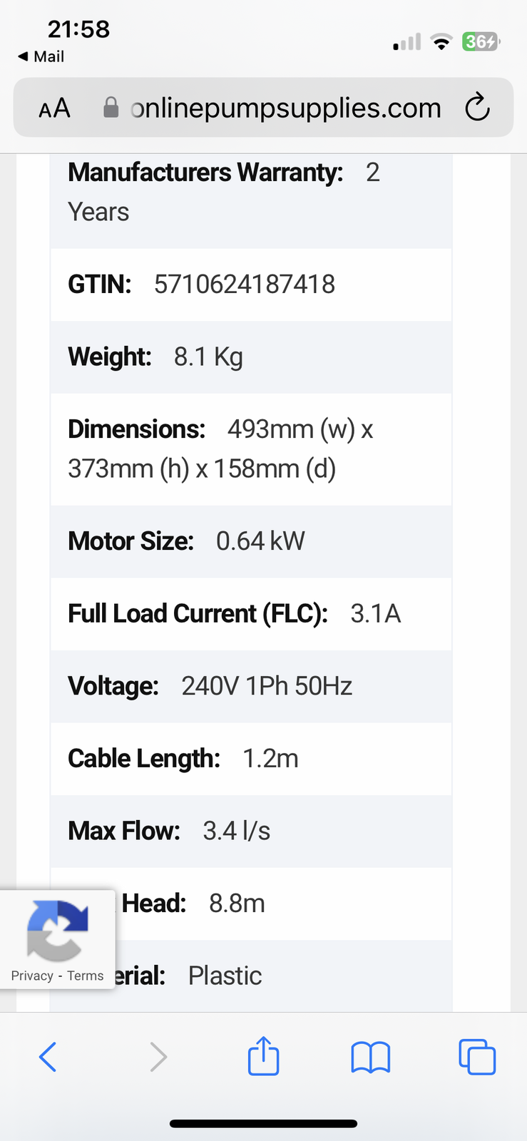

This is a Sololift c-3 pumping station, with 640w power, which I assume would take a 3A fuse. But just looking at the spec and it says Full Load Current is 3.1A?
Does that m Ed n I should put in. 5A fuse and not a 3A?
Ok - that’s interesting. It’s a lifting station to pump water upwards about 3m - I put in a 3A fuse as I saw 640w as the power rating. It starts by water reaching a certain level inside - and looks like there’s a capacitor (haven’t opened it up), but looking at the parts on-line.
It’s been going months, but blew my 3A fuse twice recently - so likely the wrong rating?
Motors have a lot of inertia, so draw quite a large current initially, until they are up to speed. As per Eric's suggestion - put a 10amp in there.
