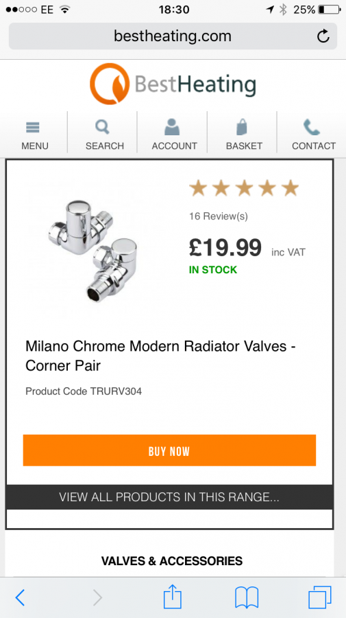

I'm buying a TRV, can it be turned inwards to avoid it being knocked on passing ?
only the pipe layout determines the height, it is not normal practice to install a TRV on towel rails,Towel rails are exactly that, they are there to heat towels , not the bathroom, only problem you will get if you turn the sensor inwards is that if a towel covers it then the rail will switch off too early

Not TRV but manual.
Comes through wall I've got angled. If they are a waste of time I'll try and get a return before they get delivered. Bathstore have been utter shyte so far they were supposed to delivery today but changed it to tomorrow without bothering to tell us. You'd think they make pennies selling these things.

Dilalio yeah I seem to have made a problem for myself if I don't use the TRVs from bathstore as the radiator does not come with stock valves.

Everything was fuked in a plastic bag and fell out when I opened it. Bathstore are poor. Felt lucky to not be missing any parts. Think I might use these now because I'm not sure I can't be assed getting a refund. Here's how I intend to run the valves. So the sensor will be turned into that dead corner with nothing else going on but obviously there will need to be a turn. I think it'll look alright. The return valve is just a straight angle :
