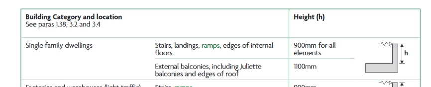

What is the min / max height for a new first and second floor glass balustrade and ideally what thickness of toughened glass?

Its 900mm for internal landings, which this sounds like? The glass thickness is probably 10mm but must be determined by the supplier. Consider laminated if funds permit.

This is for a gallery landing for both first and second floor. If toughened glass is used I guess this would shatter into tiny pieces if stuck in the wrong area compared with a contained shattering / spider web effect damage if laminated? Is it personal choice then as to whether I go for 900mm or 1100mm? There's no particular rule which says if the floor is above a certain height then it has to be above x mm in height?
No. Methods for compliance with the Building Regulations are set out in the Approved Documents.

I don't really get where the ambiguity is coming from, you merely determine where your handrail is located and the regs tell you the minimum height.
That said you can always go for a higher height than the regs ask for.
FWIW, for internal landings/mezzanines, 900 feels too low to me. 1m feels about right.
