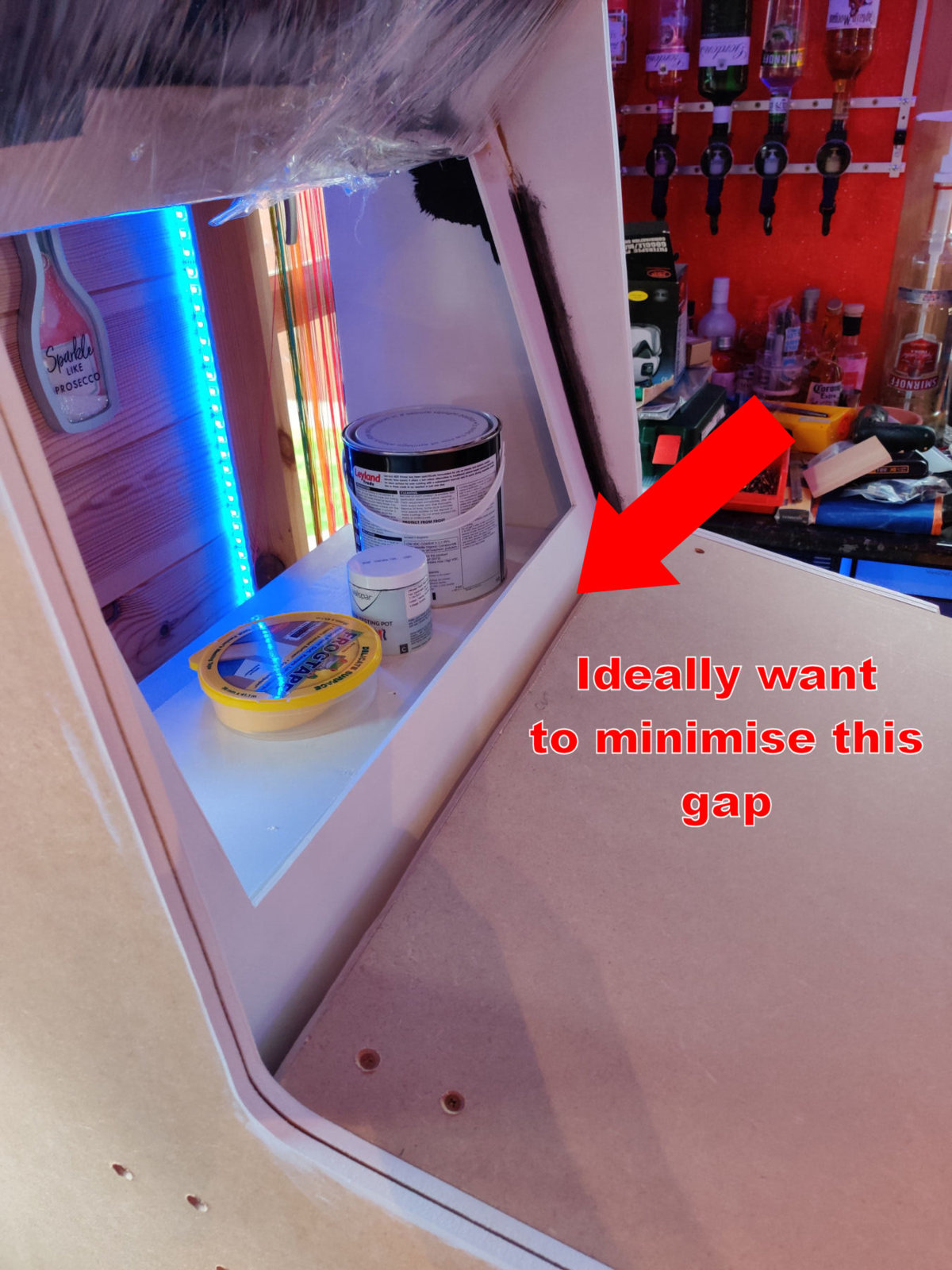

I'm needing to lean on your experience.... I'm currently building an arcade machine (my woodworking skills are pathetic but I'm having a go anyway!).
I want the control panel to be able to lift up on hinges so I can get underneath to change buttons etc if there's any problems.

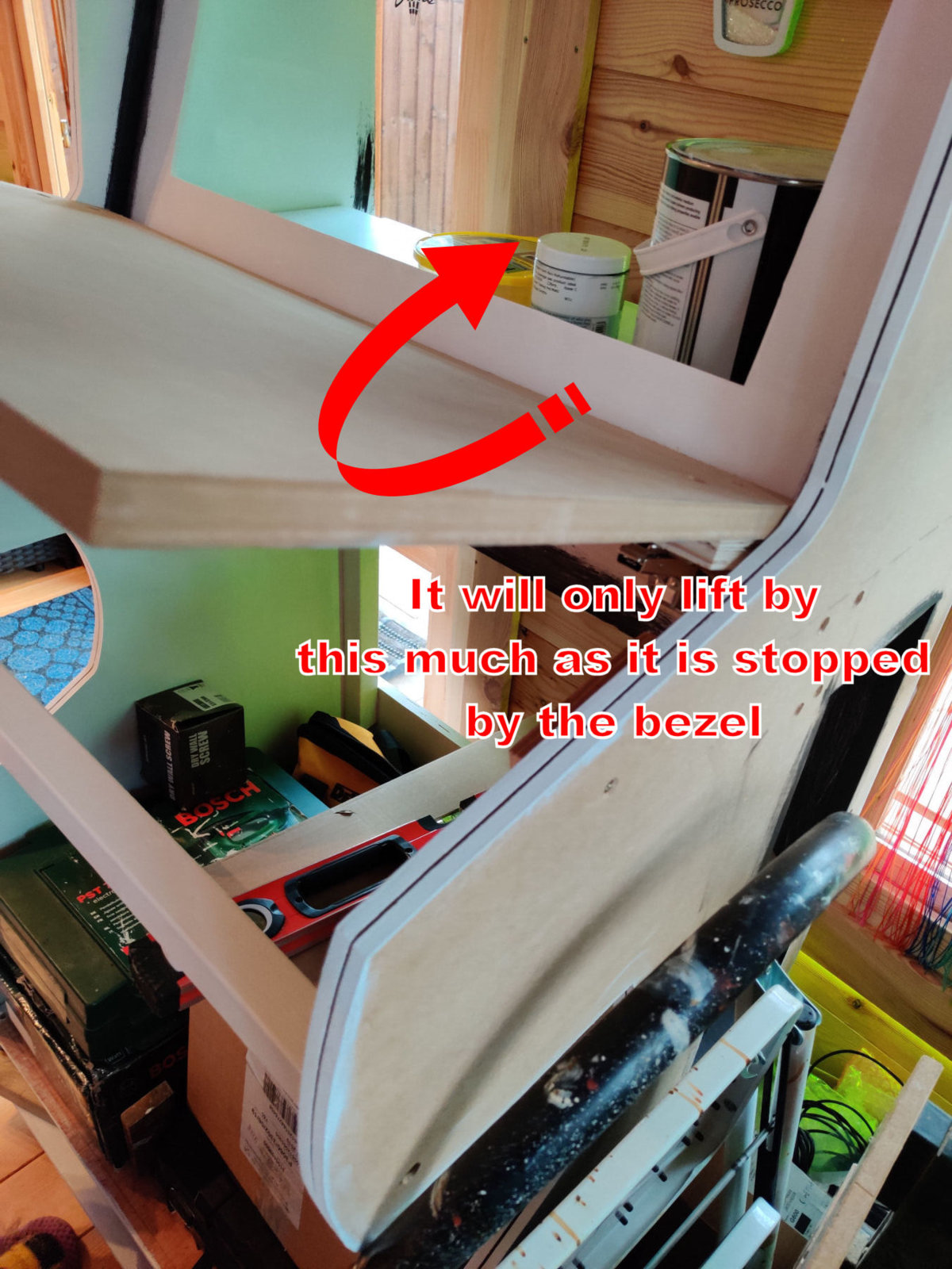

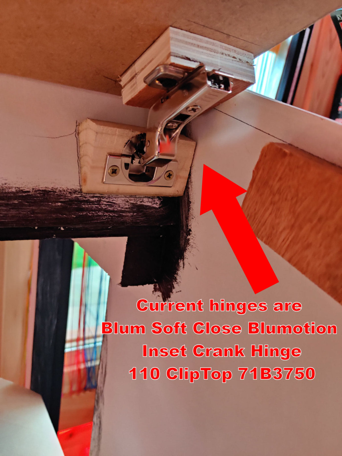

I've bought some "Blum Soft Close Blumotion Inset Crank Hinges (71B3750)" and fitted them but the control panel only lifts about 30 deg as it fouls on the monitor bezel.
I can cut more away from the control panel to make it work but would rather have as tight a fit as possible between the control panel and the bezel.
I wondered if there were hinges that were available that can lift something up and away from the edge (see the photos to get an idea). Basically, I'm after hinges that would allow a small gap between the control panel and the bezel but allow it to lift up fully as the hinge would push the control panel out and away from the bezel when lifted?
Is there such a thing??
Many thanks for any help you can give me.

uptown47, Good evening.
How about fixing a solid, non moving timber batten below the bezel, in effect you are "moving" the rotational point from close to / below the bezel to a point in "front" of the bezel.
May be worth looking at a piece of timber say 50.mm. square, that may allow you to get some distance between bezel and opening flap, and at 50.mm. deep the hinge should operate as intended??

Thanks Ken, that's definitely worth consideration. I'm going to work on it again tomorrow weather permitting so will look into this as a possible solution.

Thanks for that. I've bought some "Kitchen Cabinet Lift Up Flap Top Door Hinges" from Amazon so will give them a go when they get here on Monday.
Thanks for the suggestion. Your suggestion of 'coffee table hinges' (which I'd not heard of) drove me to finding those cabinet hinges which (hopefully) will work.
