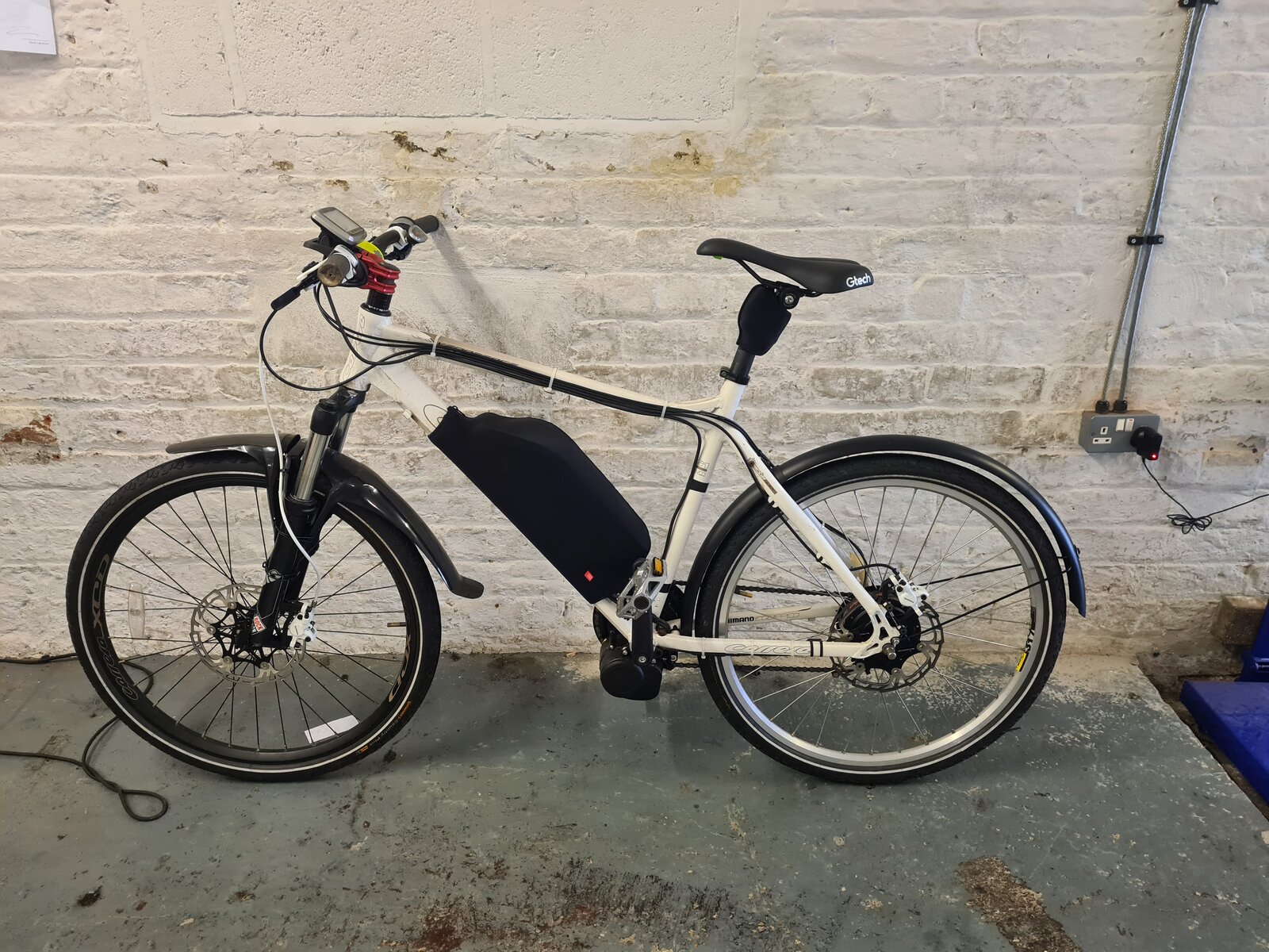

I built the first bike from an old frame, TSDZ2 Mid Drive, Nuvinci 360 rear hub, 15ah 36v battery.

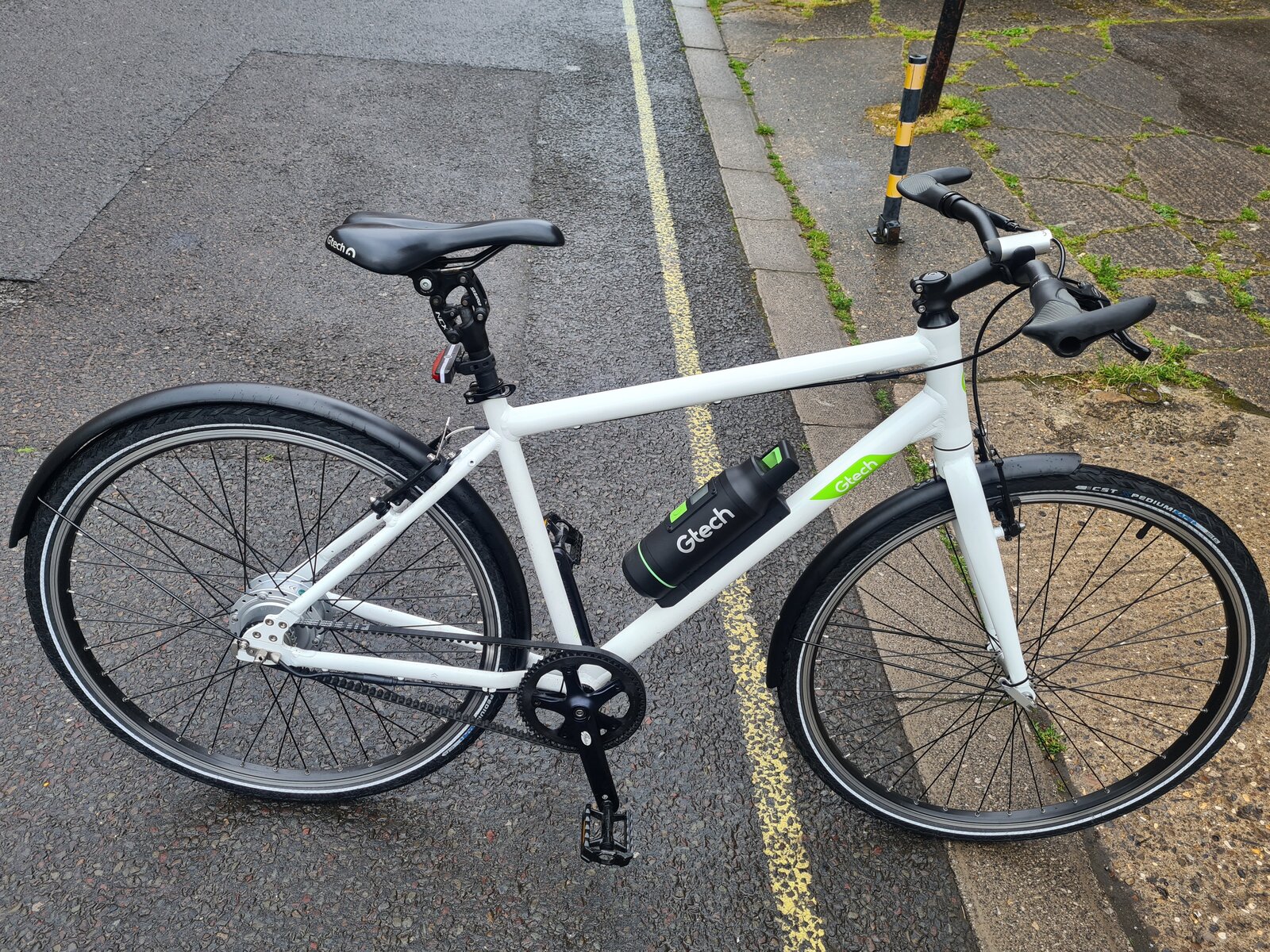

I've got 2 GTECHs as well (MK1 and MK2), ideal commuters with the carbon belts!.
Did look at G-tec, I am too heavy to ride one, weight limit rather low. I think the mid motor is far better, less noise, and drives through the gears so torque is increased on the hills, but it needs a special frame, at least for the Bosch fitted to wife's bike, and it means no gears at the front as a special belled crank gear, so think her's is 7 speed, where mine is 21 speed, not that it is really 21 speed as there is a lot of over lap, but without a dynamometer one can't really know the output of any motor. I remember at collage having to work it out, 2πNT/33,000 but god knows what it is today with metric system? Funny how one remembers formula. I note many quote volts x amps x power factor, which clearly is a problem as no idea of the power factor, and they are AC motors, it must be less than DC volts x DC amps and we know battery is 48 volt at 12 Ah so 250 watt = 2.3 hours running time, I get well over that time, so clearly the motor uses well under 250 watt on a continuous basis. And of course there must be losses, so even less at the wheel.
